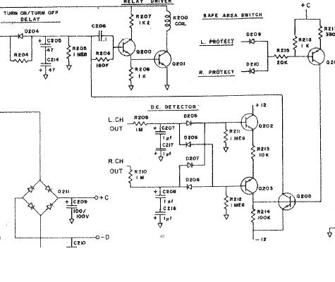

one amplifier i'm well familiar with uses an RC time constant with a corner frequency of .32 Hz in it's DC detector. it also uses a DC servo with a cutoff frequency of 5hz to keep amp offset zeroed. so the amp frequency response extends down to 5 hz, and the dc detect circuit operates at .32 hz for a frequency margin of more than 10:1. if you want to protect against medium frequency subsonics (from .5-10hz), you could always change the rc time constant.
