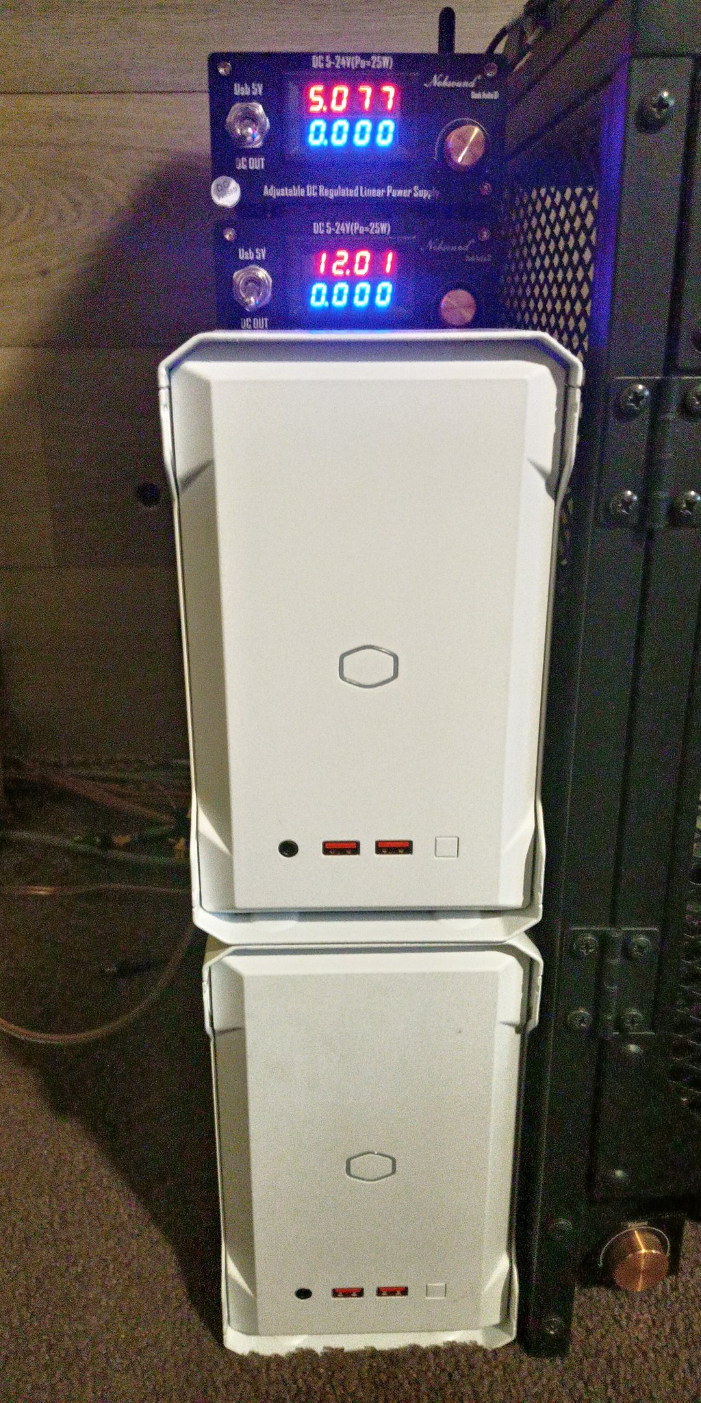

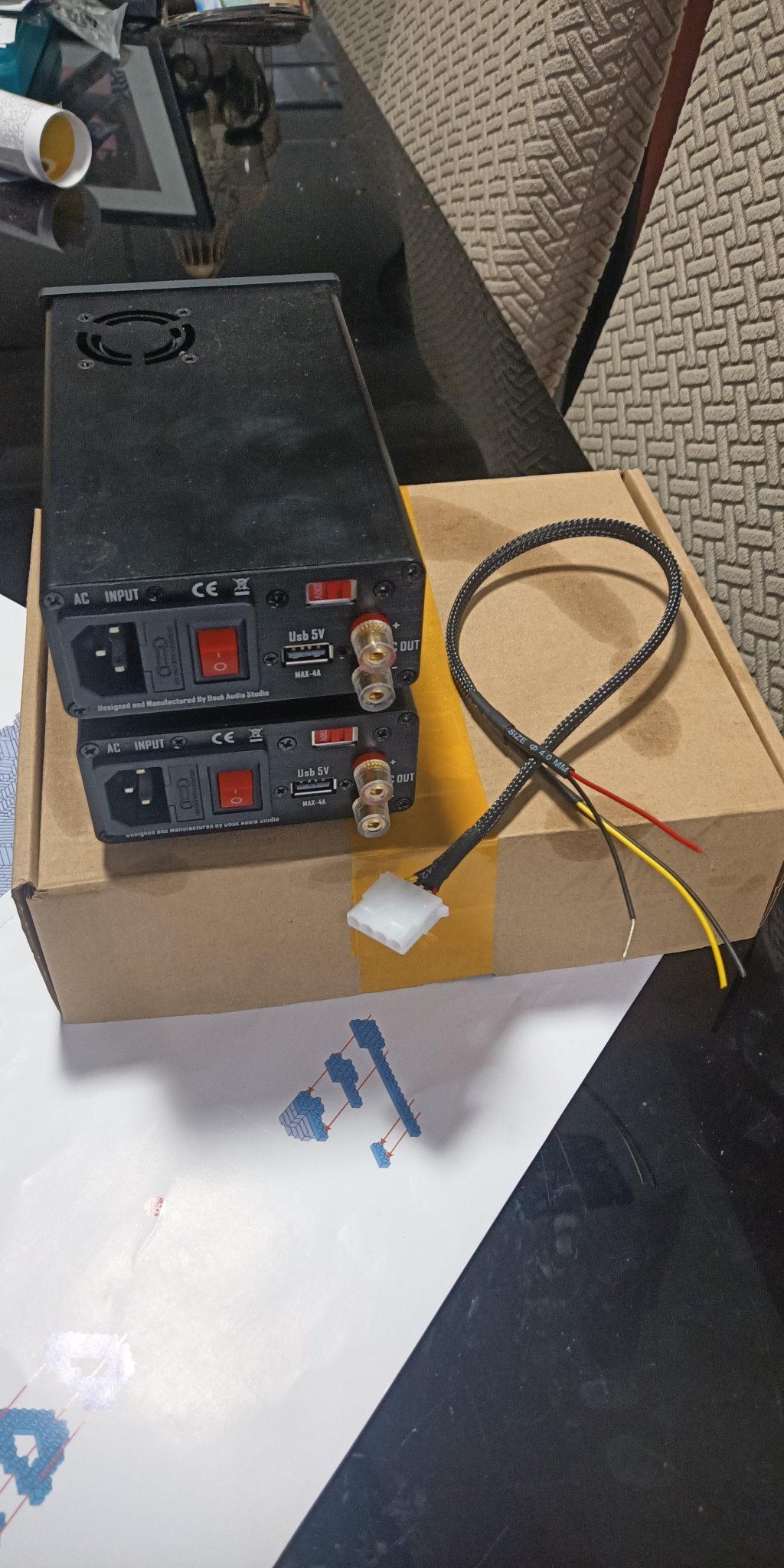

I want to use two seperate linear power supplies to feed the 5v and 12v lines of the second power input of an ASUS STX II. (Four, actually)
For those who don't know, the STX II has a second molex power input for a cleaner power supply.

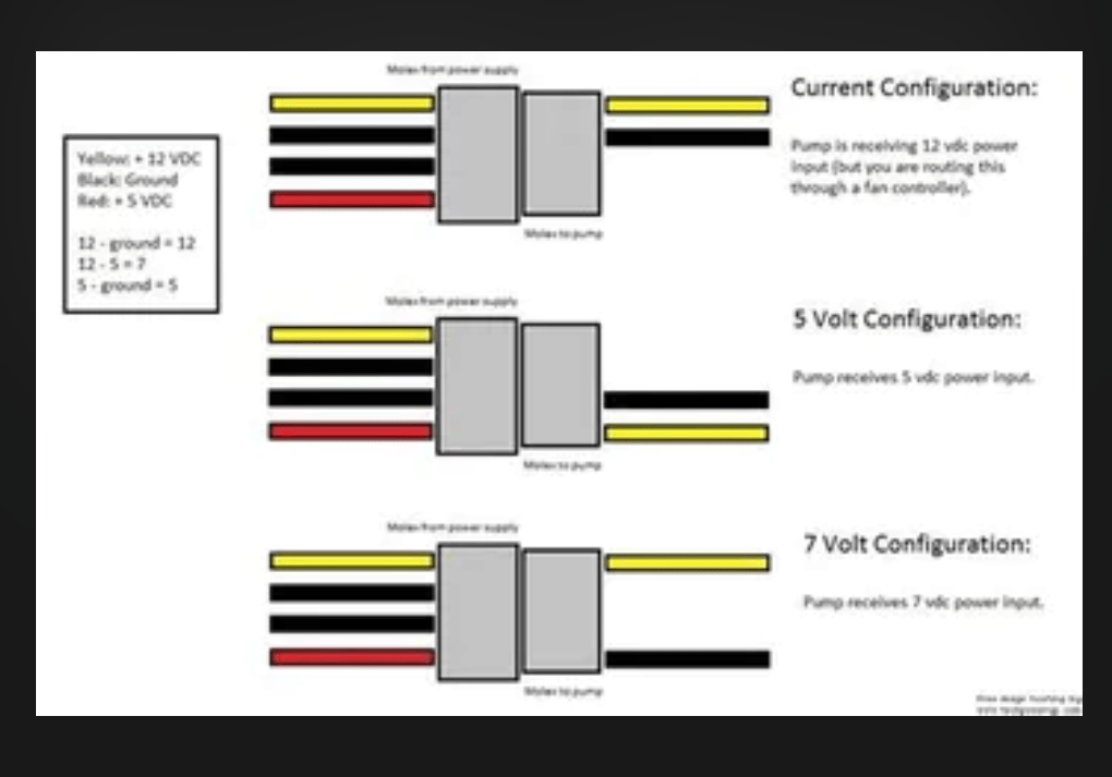

When looking up what colour wire is for the 12v and which is for the 5v I found that connecting both makes 7v.
Will using two different power supplies on the second input work? Or is there something special about PC power supplies that this solution needs and doesn't have?
Attached is the cases for the cards and the two power supplies.

What do you mean 'connecting both,' both wires of any color to something else like a connector? Please sketch up a schematic, a connector diagram for the Asus card, and connector diagram or pic for the linear power supplies. The pic doesn't you attached doesn't show the details we would need in order to assist you.
I was literally about to connect the wires to the supplies when I saw this diagram image making me think twice about the nature of ATX power supplies, and how different they might be to what I was doing.What do you mean 'connecting both,'

Using an ATX power supply to produce 7v would be a bit risky since neither one of those two (12v, 5v) can ever be connected to the computer ground or it would make a dead short. Therefore, anything running from that kind of 7v power would have to be completely isolated from ground.

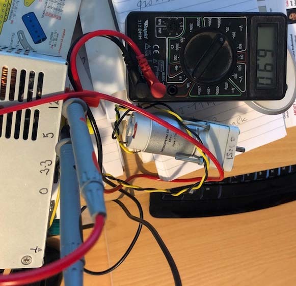

Motor running from 7V connected ATX power supply.
That's a re-purposed ATX supply with banana sockets fitted in the side of the case.
Ground lifted as I wanted to be able to connect 2 supplies in series for split supply or >12V.
The ground must be connected to one of the terminals for a stable output voltage but it doesn't matter which.

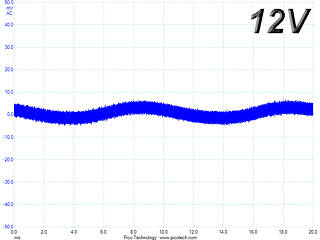

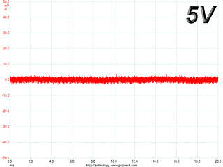

Seriously though, the ATX standard is cleaner than you think. My PSU can output 850W of 12V DC with less than 15mV of ripple, and the 5V line is even cleaner.

Markw4, it's a pair of 5-24v adjustable linear power supplies. As for whether I can hear the difference a linear power supply can bring, I'm interested to find out if I can
