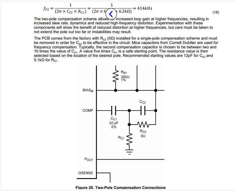

couldnt control the dc offset but would like to know few things...
Is it strongly recommended to use film cap for C8? which is 10uf right now im using a 22uf electrolytic cap.
- two pole compensation for lme4702 lme49830
