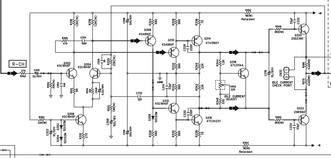

I did some 'cut and paste' on the PCB yesterday to switch the pinout for the latfet's. Today I mounted the outputs and tried to power it directly to the drain pins from a bench supply, but would not get more than maybe 0,5V before current limiting kicked in. I set it low, but still think the voltage should slowly go up, charging the PS caps, and possibly limit when current starts flowing in the circuit. Did some basic sanity checks, but could not find anything obvious, so I called it a night..

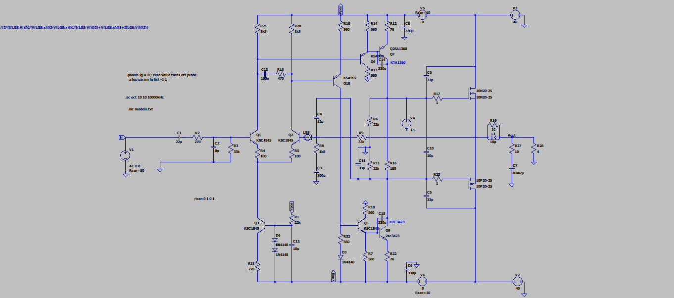

I found the problem today, I had the outputs in the wrong positions for one channel (P/N switched). Now it powers up, has no DC offset, and biases as expected. However I have a small oscillation on one channel in the MHz-range (end of the range for my cheap scope). If I turn bias down to 0 it disappears.
I put my finger in different places on the PCB, and I found that putting my finger on the pins of Q308/Q10 and C326 the oscillation disappears. According to sim it should be stable as it is, but I'm missing the models for the drivers, and there is the influence of the PCB too. I tried caps between drains on the outputs and ground, but it did not seem to do anything.
One step forward at least.
I played around with this one a bit today:
-100ohm gate resistors, did not help.
-removing C346 did not help
-removing speedup cap on feedback C326 reduced oscillation amplitude a little
-touching anything in the 'inverted' side with my finger stops the oscillation (Q304, Q310, Q312)
-I tried with a small 4.7p as Miller cap in various places, but it did not do much
-mounting it in the chassis I had oscillation on both channels, and amplitude was higher on the channel that also oscillates on the bench. On the bench I have 20V rails, and in the chassis abt 40V.
-I changed the LTP transistors to (supposedly) faster ones (also lower hfe), and got 15V DC on the oscillating channel.. but no oscillation. Can't remember the type of transistors now. I had a hard time finding replacements with the same pin config in my box of transistors, most of them has the base in the middle, and many are 'recycled' so they have short legs.
To be continued..
Reactions: lineup
Ok, should be worth a try.
I was just thinking that it would be something else, since I did not see an improvement with the 100ohm resistors, and putting my finger in the mentioned positions kills it, but not putting my finger on the gates and in that area.
The 100ohm resistors I put in are however in the positions of R348&350, so there is some distance left to the gates. C332&334 are still mounted, so I figured it would be better to have the resistors in the original position, before the caps, forming an RC with them + the gate capacitance. I guess I could just 'lift' the gates from the PCB and put a resistor in between.
I actually have not even simulated distortion, I'm just hoping to get it in working order.
This is more like a challenge to myself, to make the amp work with laterals, and hopefully with decent performance. I like analogies, so I would say it's like converting a diesel engine to petrol, and get it to start and run, not making a drag racer out of it. Maybe it will run smoother than the diesel, who knows! 😉
So, I found the problem with DC. One of the old 2sc1815 transistors I (thought I) used for inputs was actually a PNP, (wrong model) so I swapped it, and DC was normal again. However, oscillation is there, and slightly worse, It even has a slight oscillation on the other channel too now.
I did not have gate resistors per recommendation, so I tried adding another 100ohm on the N FET, but oscillation was exactly the same. I doubt the main issue is there.
However, -to another discovery! From previous 'experiments' (by me) the emitter resistors on the LTP are 10ohms, not 100. When I entered this in the sim, things started looking a bit critical..
I need more resistors, so I placed an order for some in the 100-200ohms range, and also added some transistors: 2N5401 and 2SC1775. The 1775 is a straight swap with pinout, A fast one and 50mA 90V rated, so thinking LTP, but maybe can't stand the current for VAS-duty? It was a 'quick click', so I might have missed something..
Anyway, first thing to try is increasing the LTP emitter resistors when they arrive, and looks like the 1815 LTP transistors need to go too, since oscillation got worse using them. Could swap back to the originals, or the 1775's. I'm not aiming to have a super fast amp, so I might be happy adding degen (decreasing loop gain) until it's stable, if that solves it.
