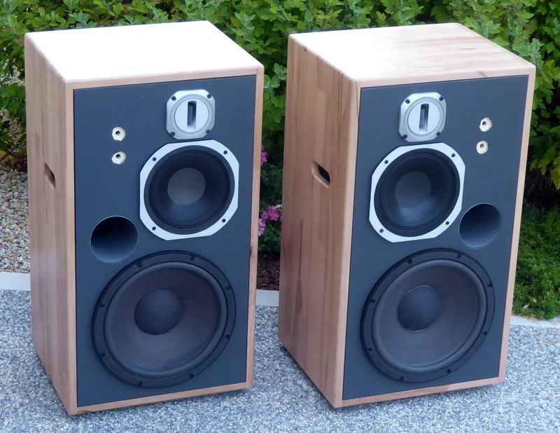

For my bigger 3-way project above, I studied 2 different 3-ways Xover...
A more simpler one :
A more complex one :
Auditive comparisons well tell me in fine which one is the most suitable for my use - again, no generalization, even if the plus and minus of each formula are indeed well documented...

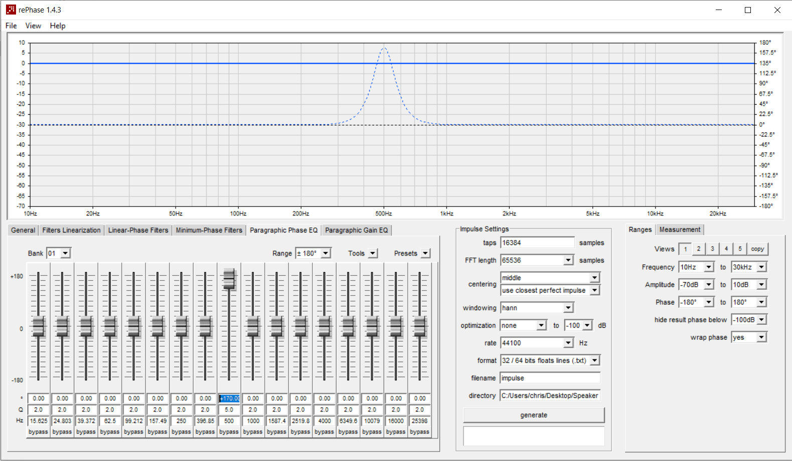

Allen,
I will pay you £20 to come up with a passive speaker-level filter that produces a phase shift of +170 degrees with Q=5 at 500Hz and zero effect on the frequency response. Simulation in XSim or similar is fine, so long as I can reproduce it at this end.
As far as I know, this cannot be done outside of FIR. I'll happily pay that money for the lesson.

FIR allows the phase and frequency response curves to be altered arbitrarily and independently.
The numbers I picked are arbitrary. You're correct in saying that those numbers aren't realistic, but that's not my point. My point is that FIR can do this stuff, and passive filtering cannot.

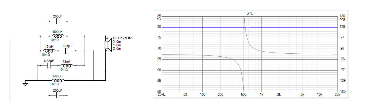

Allen,
An impressive attempt! Certainly more complex than any of my passive crossovers.
However, attached is what the curve ought to look like. The £20 remains on the table if you'd like to try again.
Chris
