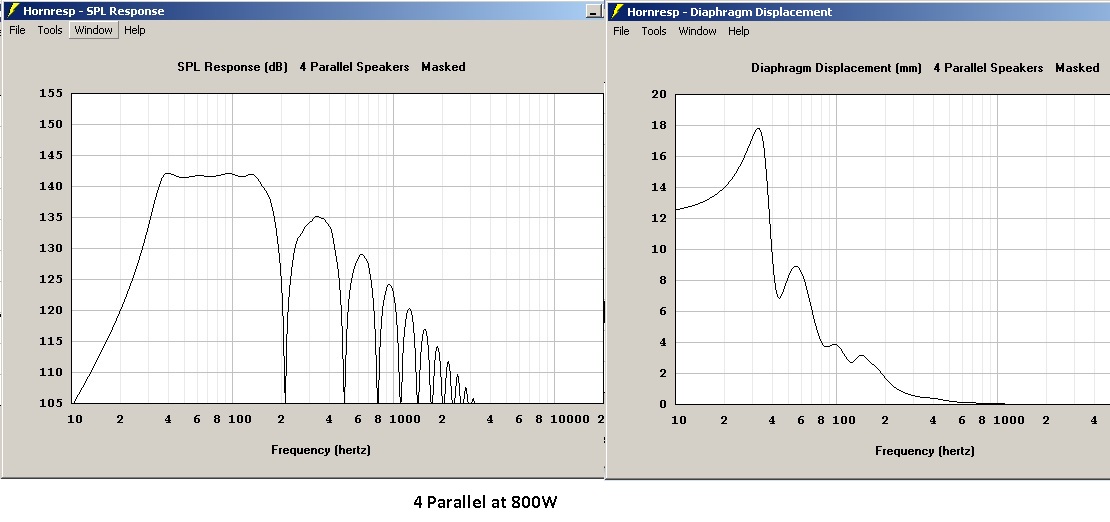

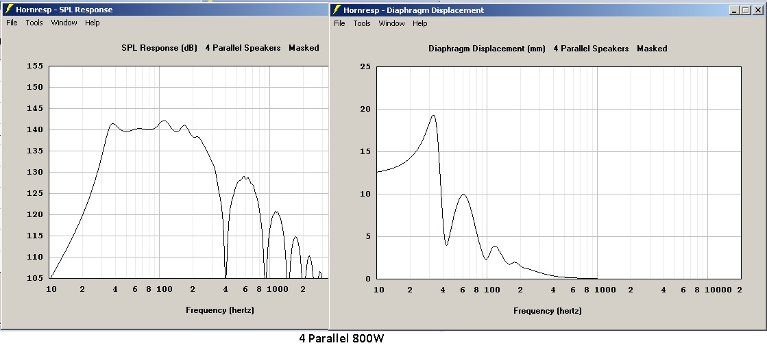

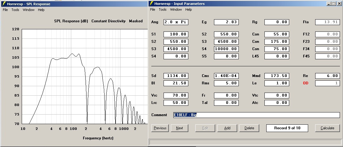

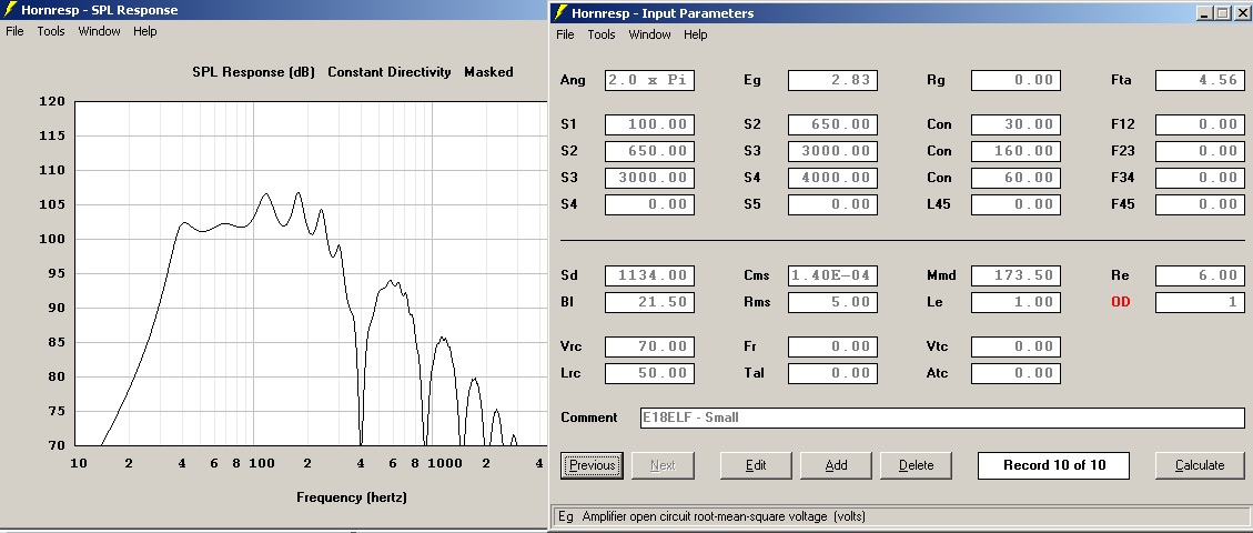

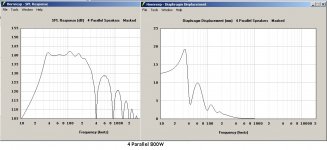

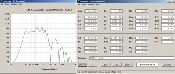

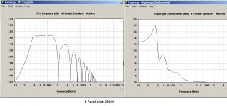

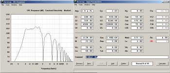

Two new 18" Offset Horns
Threw together two new horn designs for the P.Audio E18ELF driver. One is ~1000L and gets around 104 dB/2.83V/m and the other is just over 550L and gets 102 dB/2.83V/m.

Interesting you should say that.
I'm not an expert on this, but, at port tuning, a driver almost stops moving (need to shove a lot of power in to get it moving the same amount). 18" speakers get used in ported cabs all the time, and I've never heard of one shredding.
Take this high comp ratio scenario and equate it to a 4th order( rear sealed) bandpass box. I see many 12" bandpass boxes built with a 4" port on the front chamber( 6 to 1 ratio). Is the reason the cone doesn't break because of the increased box volume(air compliance) in front of the driver?,as opposed to a smaller compression(front) chamber used on a tapped horn. Or is this still not the same situation?
In a BR or BP the pressure have time to equalize and avoid high pressure bumps and vibrations.
In a horn with high CR you can get pockets with high pressure that will flex the cone, uneven loading due to taper will make it worse, this can make it rip. HOM is probably bad for it as well due to it's chessboard standing pattern. Water is a factor that will make it a lot easier to break.
Sort of like an aluminum can. You can stand on it without a problem. But as soon as it flexes or get a ding it will rip and collapse.
That's my theory at least.
Over 10:1 compression on an 18" driver? wow, I've gone against the conventional wisdom and have used up to 8:1 on an 8" driver, but never an 18.....
Planning on a cone shredding party?
Compression ratio is only 2:1, so not too worried about any shredding.

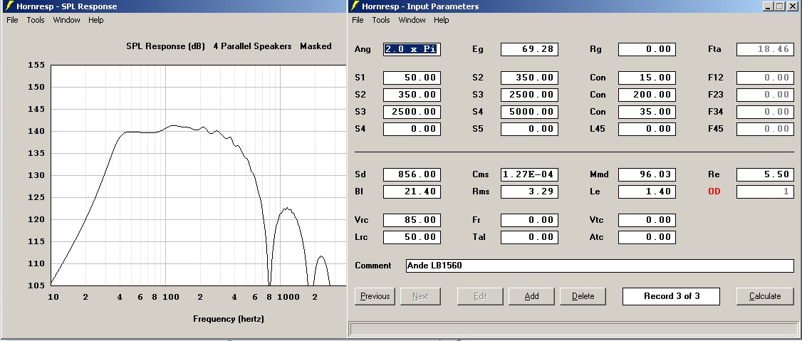

Through together some new designs for an Ande LB1560 15" driver to be used in banks of 4.
Volume of 469L all up.
