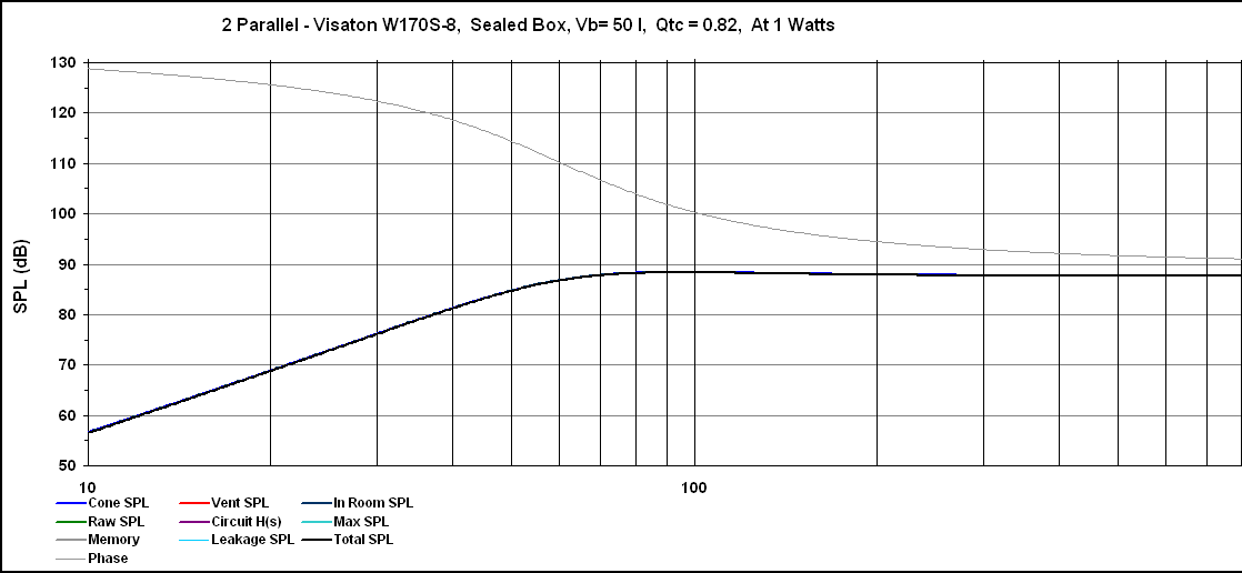

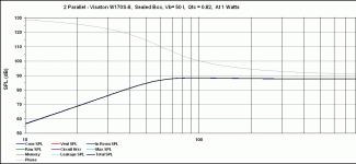

There is no point going nuts about excessive box volume that might turn
up being impractical. This is a simulation based on my measured parameters
of 2 units in parallel in a well stuffed box with 0,5 ohm of DCR (low pass
inductor) already calculated in.

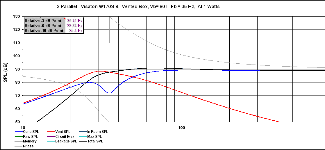

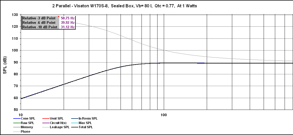

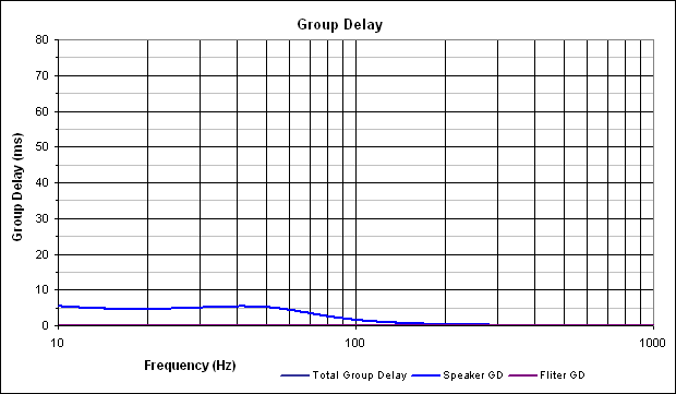

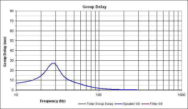

There is multiple suggestions by Visaton and no one sais you have to
do it exactly like this. Maybe it would be better for your application
to work with only one woofer W170S-4 which has a lower Qts and
therefore more suited for a vented box or a 3 way with one W200S.
Lower box tunings work better in smaller rooms, higher are better
in very large rooms where you don't have such room gain. A basic
logic with higher Qts drivers for vented applications demands that
the box volume be twice as much greater than Vas or more to work
properly without sounding overbloated.
Where do plan to put these speakers and how large a cabinet can you
afford?
The only potential issue you might experience would be not
so ideal bass response. Higher Qts driver in a vented cabinet
has its shortcomings but maybe you won't have anything against
it. So, you could build an 80 litre vented box and see how it goes.
Good news is that you can always put a plug and turn it into a
sealed type which will work good. So, the only downside would
be to put up with oversized looking cabinet for just two 6,5" drivers.
Fb of 35 Hz in a vented cabinet you can achieve with a single BR15.34
of 56 mm length.

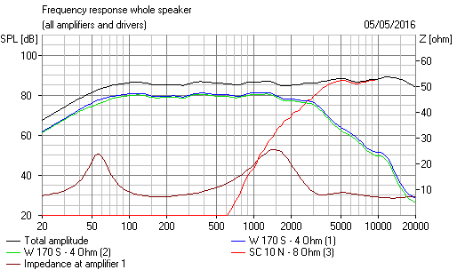

Most 6" bass MTM's look like this:
You can use a dome tweeter too. Not a biggie. Usually about 40L total. Nice idea IMO. I've heard this type. A TMM is pretty much the same thing with the tweeter at the top.
You can model a design easily enough in Boxsim. The Visaton W170S drivers are more your closed box suitable. Being Qts around 0.5.
To get up and running quickly, I'd import this design into Boxsim projekte folder and adjust it.
boxsim-db.de | Boxsim Projektdatenbank
Lose the midrange and give each bass 20L. Shift the placing of the drivers for an MTM arrangement.

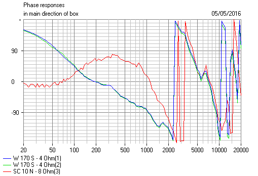

From my experiments, a 6kHz notch on 6" bass works well. I'd take on a project like this. I've done this with two 4 ohm Visaton W170S in series for an 8 ohm impedance. It's quite easily adjusted for bass via adjusting the 1.5mH coil, and tweeter level. You have a 90dB tweeter, so I think it'll work. One of my projects here, just to show how the build is done in practise.
