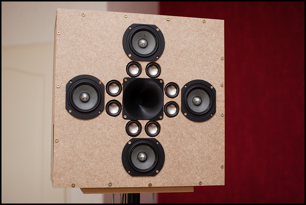

Here's my horn. Soda can included to give you an idea of the scale. The horn is just 3" deep and 4" in radius. It's TINY.
moar pics
The pokeball color scheme was not intentional. Just happened to be the two colors that my two printers had this week.
Here's the measured polar response, with the range covered by the waveguide highlighted in green. My expectation is that the beamwidth would be about 120 degrees (because that's the angle of the walls) but the actual beamwidth is quite a bit narrower: about 100 degrees.
That's actually a GOOD thing, the only reason I used such a wide wall angle (120 degrees) was because I was trying to keep the depth as shallow as possible.
It would be interesting to scale this thing up: picture a waveguide that's six inches deep and sixteen inches wide, that works down to 850Hz.
Having said all that, keep in mind that an OS waveguide will have better polars IMHO. But this is CLOSE. The reason that I went this route was to make it as small as possible, and the diffraction slot gives me a spot to cram the midranges close to the tweeter. (This is a Unity horn.)
