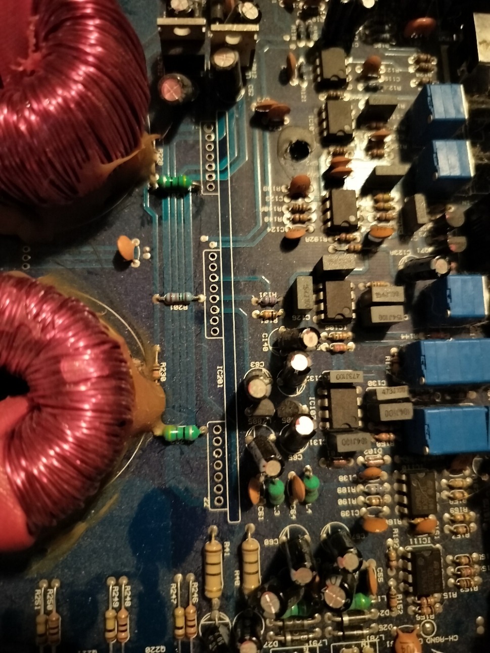

Are you sure that you can remove the 22 pin board without damaging the vias? Do you have ChipQuik?

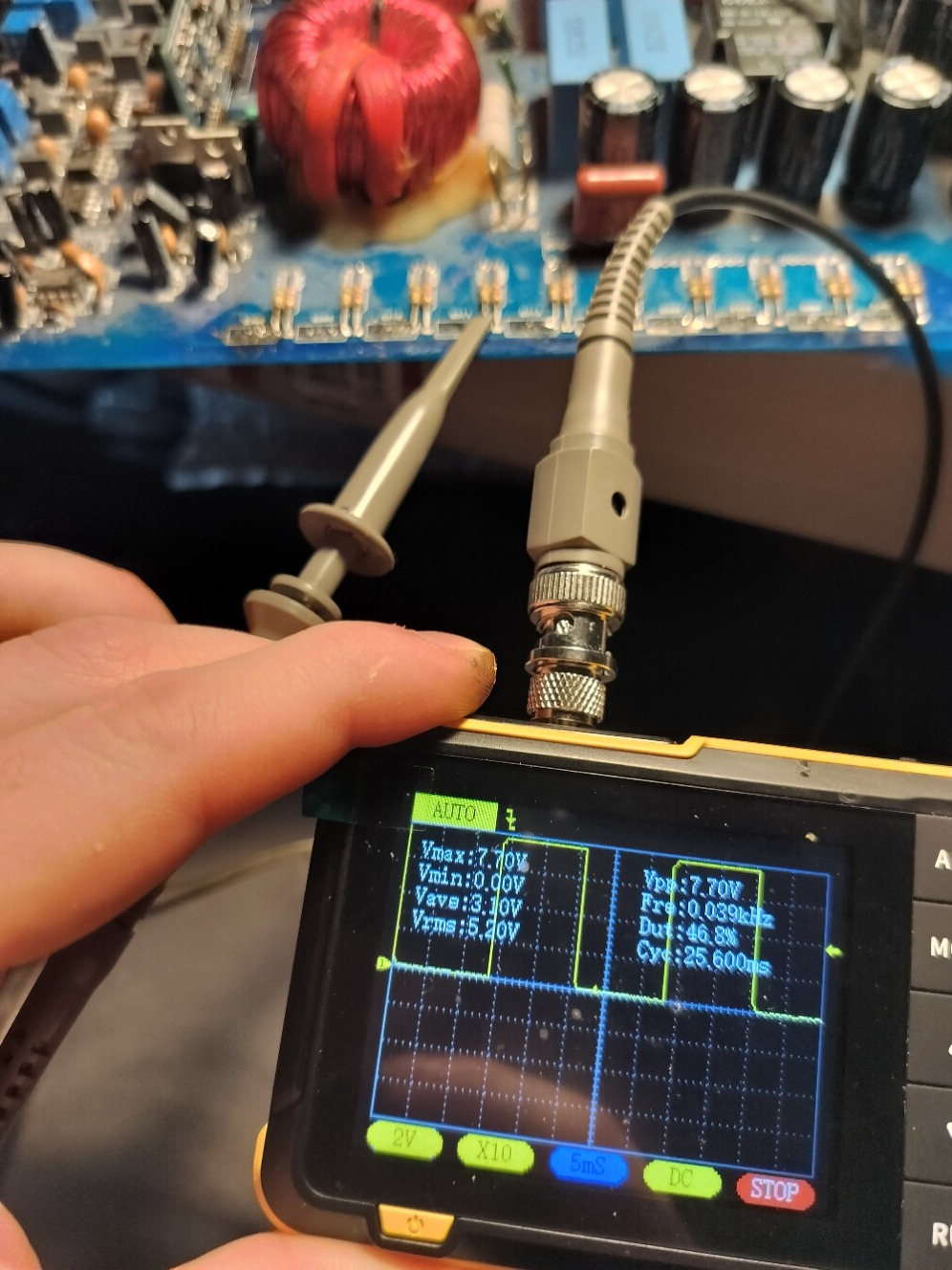

22pin driver board and Output FETs removed. Constant 12volt and 0.7 amp of current draw. Clean waves again. I probed the high side gate and got some photos.

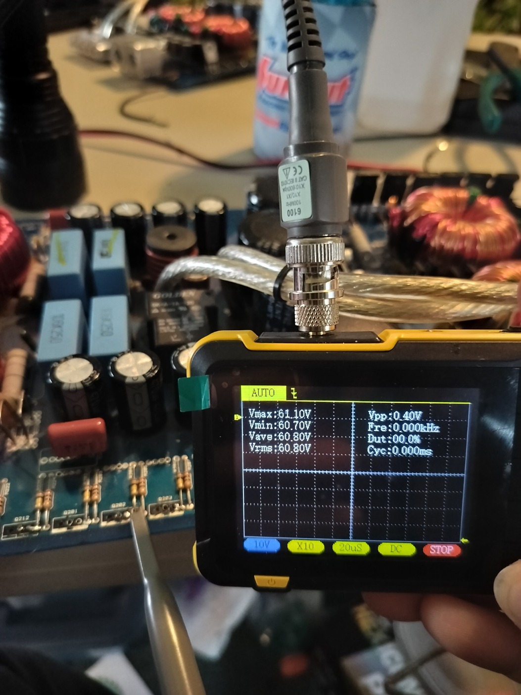

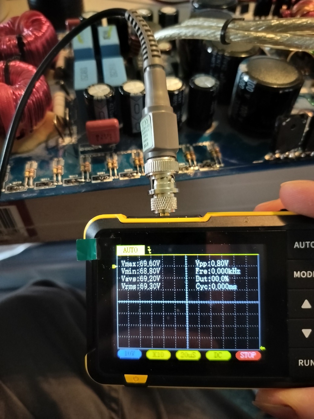

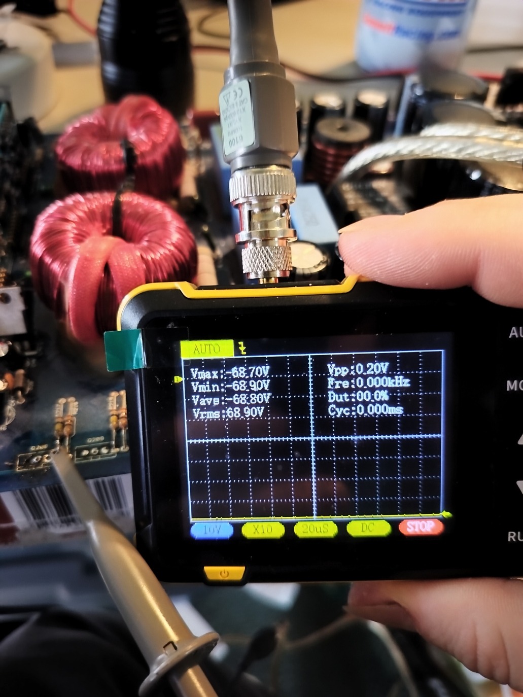

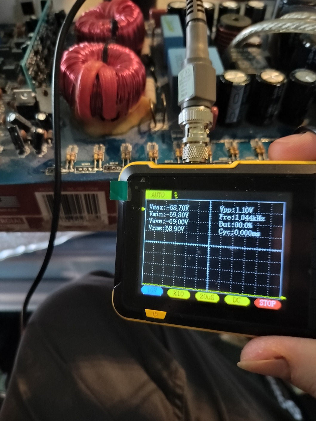

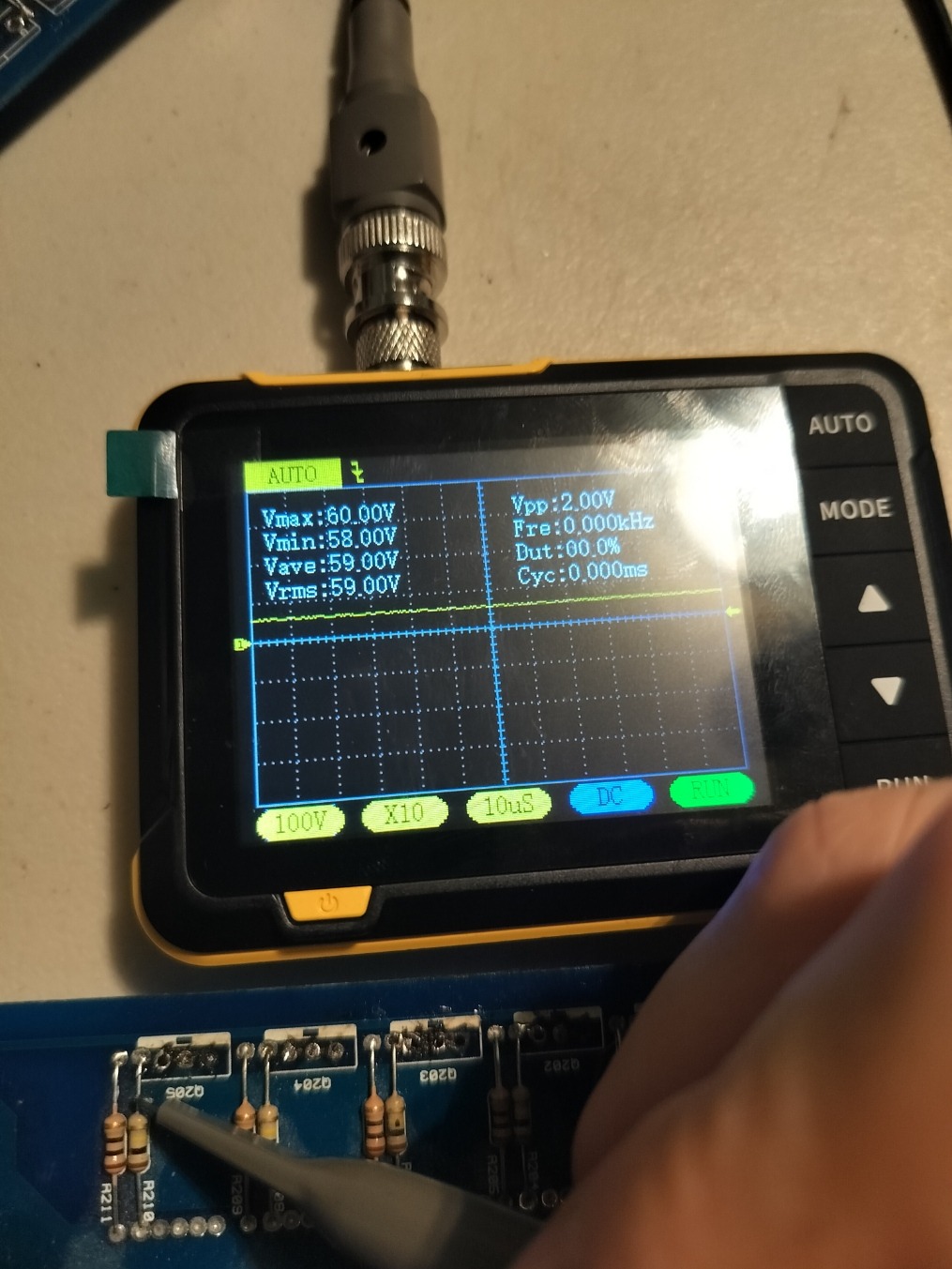

When probing high and low side, shouldnt high and low side measure as such below or is my scope set improperly? On a x10 scale it reads 60volts at the gate, so 6volts when it should be 0v?
High Side
gate Leg 1:nothing
drain Leg 2positive rail
source Leg 3:nothing
Low side
Leg 1:negative rail
Leg 2:nothing
Leg 3:negative rail
High Side
gate Leg 1:nothing
Low side
Leg 1:negative rail
Leg 2:nothing
Leg 3:negative rail
You should leave your scope on DC coupling. You lose too much valuable information on AC coupling.
Have you ever viewed the square wave on the outputs of an amplifier with this scope? Was it a perfect square wave?
What's important is the gate to source voltage. I don't know why the high-side gate is at 60v.
If the relay is engaging, connect a load across the speaker terminals and re-check as you are now.
With or without a load, place the ground on the source terminal and the probe tip on the gate. Connecting across the 100k pulldown resistor is the same (as far as connections are concerned).
The relay is engaging. power suppply side is fine. With the 22pin driver board in place but none of the outpet FETs, on outputs I do not see a sqaure wave, while ground is source and probe is on gate.
Under this condition the power supply functions normally.
When output FETs are in the board the power supply drive wave is funky looking and serious voltage drop as well as excessive current draw heating the PS mostfets. Same applies for 1 mosfet in place for both the high and low side on both sides of the board. Ruling out bad output mosfets.
What actually occured was that i had negative ground source on the main negative of the amp and I had probed the gate to the output FET nearest to the rail caps, which caused sparks to fly. Prior to this the board was running fine.
Im beginning to think the ICs of the 22pin pin board shorted

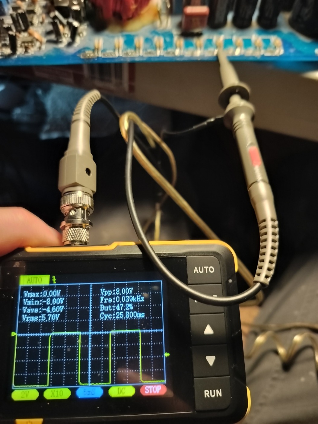

I do get DC square wave on all the output fet gates when i play test tone.

Since you are using a battery powered scope, you can ground to the source pad. Are all drive signals going back to within about 1v of the rail? You'll need to use DC coupling.
Are all good, clean square waves?

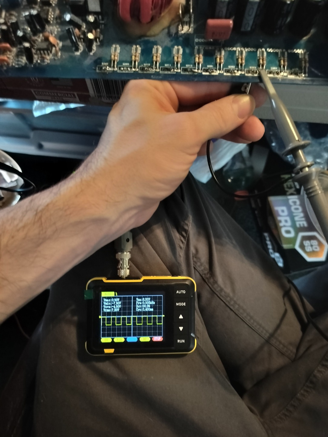

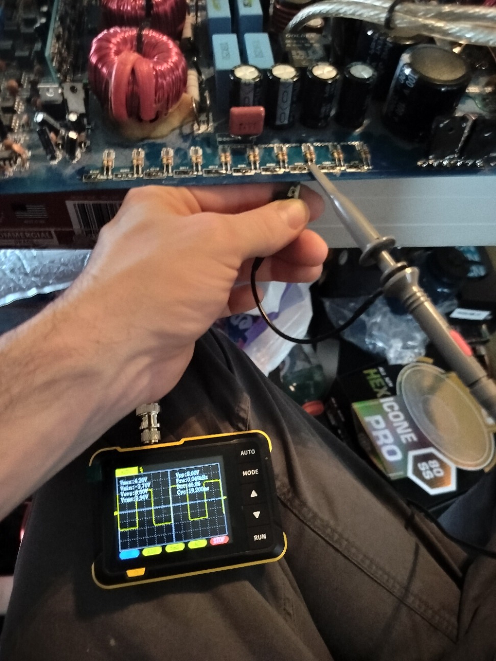

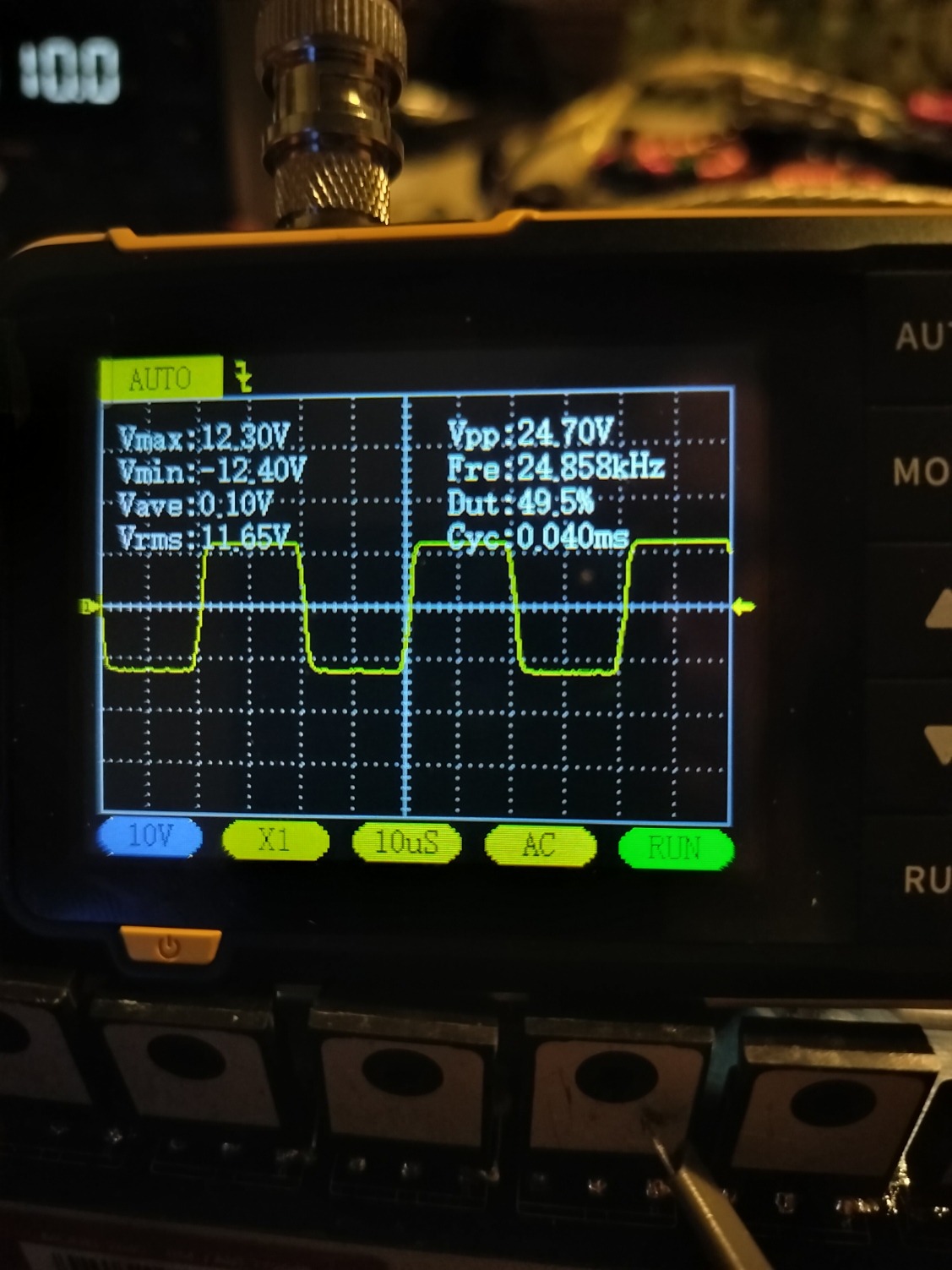

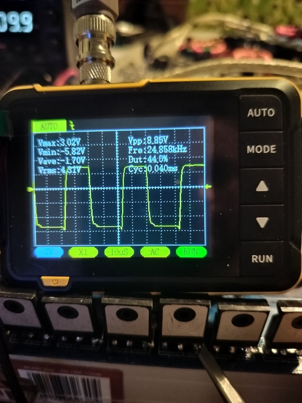

Regardless here are the waves on the gates with source as ground
Explain the last post please. Should i use the rail shunt as ground, and should i probe the collector of each two way or three way transistors?

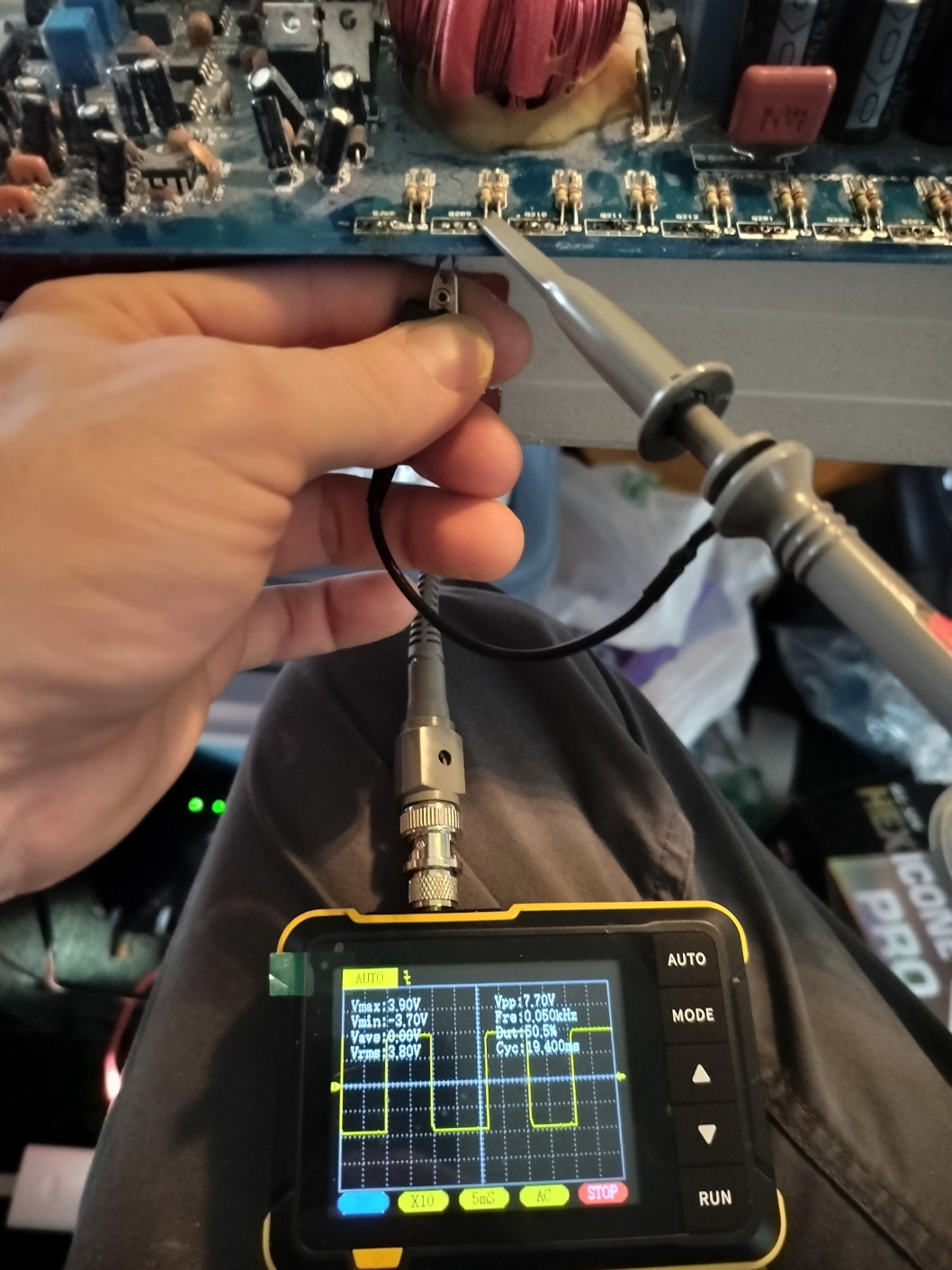

You should connect the scope across the source and gate pads.
You need to measure the regulator voltage with the black probe on the regulator's ground terminal. Then the red to the input and output terminals.
The photos taken in post #35 are when i had needed to free my hand from holding the negative side to the source. Those are square waves are scoped using source and gate measures.
I rechecked data sheets for ka7812 and ka7912 and confirm that they function normally, outputting 12v.

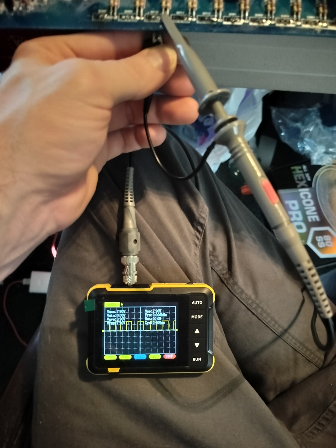

"High/Low" - "Source/Gate" photos have probed gate and source with negative on main amp negative in DC. Showing high and low voltage between gate and source on high and low sides.
Photos of High side AC/DC have probes on source and probed at gate at 50hz
The moment I place a transistor IRF9640N in each bank of high and IRF640N on the low side, the low side 640N gate-on one side of the board - draw excessive current and cooks itself. I have replaced tranasistor from same batch twice with the same result.
"Confirm that you read 12v from collector to collector for each emitter-follower pair of drivers on the driver board." - Which transistors in question, Q7, 11, 19 and 22? Also where should i place probes? one on the collector and the other on the emitter to see 12v?

I don't see a problem with those drive signals.
Do you believe that there is still a problem?
For future reference, solder a short piece of wire (like the leg of a resistor) into the source pad to clip onto to free both hands.
