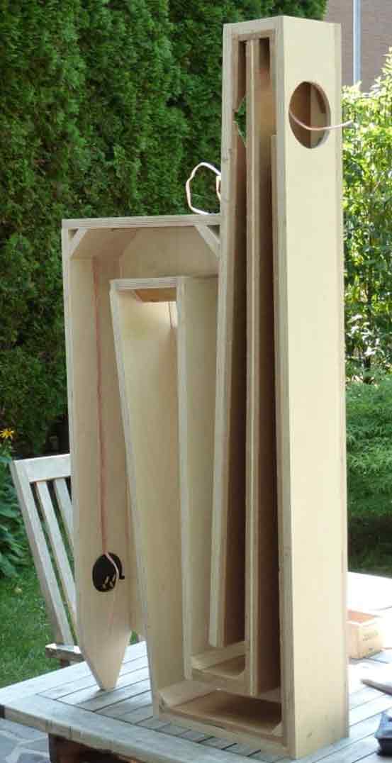

Like this. I listened to them too.
![1005a.jpg](https://www.ratch-h.com/1005a.jpg)
If two differently sized drivers share the same enclosure volume, the larger one will have a tendency to push the smaller one. The larger driver will rarify and compress more air than the smaller one. I'm talking about a sealed enclosure, not as much of a problem with a vented enclosure and even less so with an open baffle.
