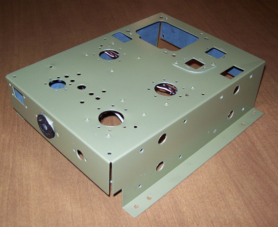

The style can that I have has the four "ears" that go through the chassis and are then twisted to secure it. Normally I have seen these with one of the ears soldered to the chassis to make the electrical connection. There are two places on the chassis where one of these cans can be installed. One is cut right in the metal of the chassis and the other is an insulator (some kind of fiber) which is attached to the chassis. I could easily mount to the insulator and then run a wire to the desired ground point but the insulator is closer to the output tubes than the other mounting point and I would prefer as much space as possible to keep the cap cool. That is why I was wanting to use the direct to chassis connection.
You can see the two mounting choices here...

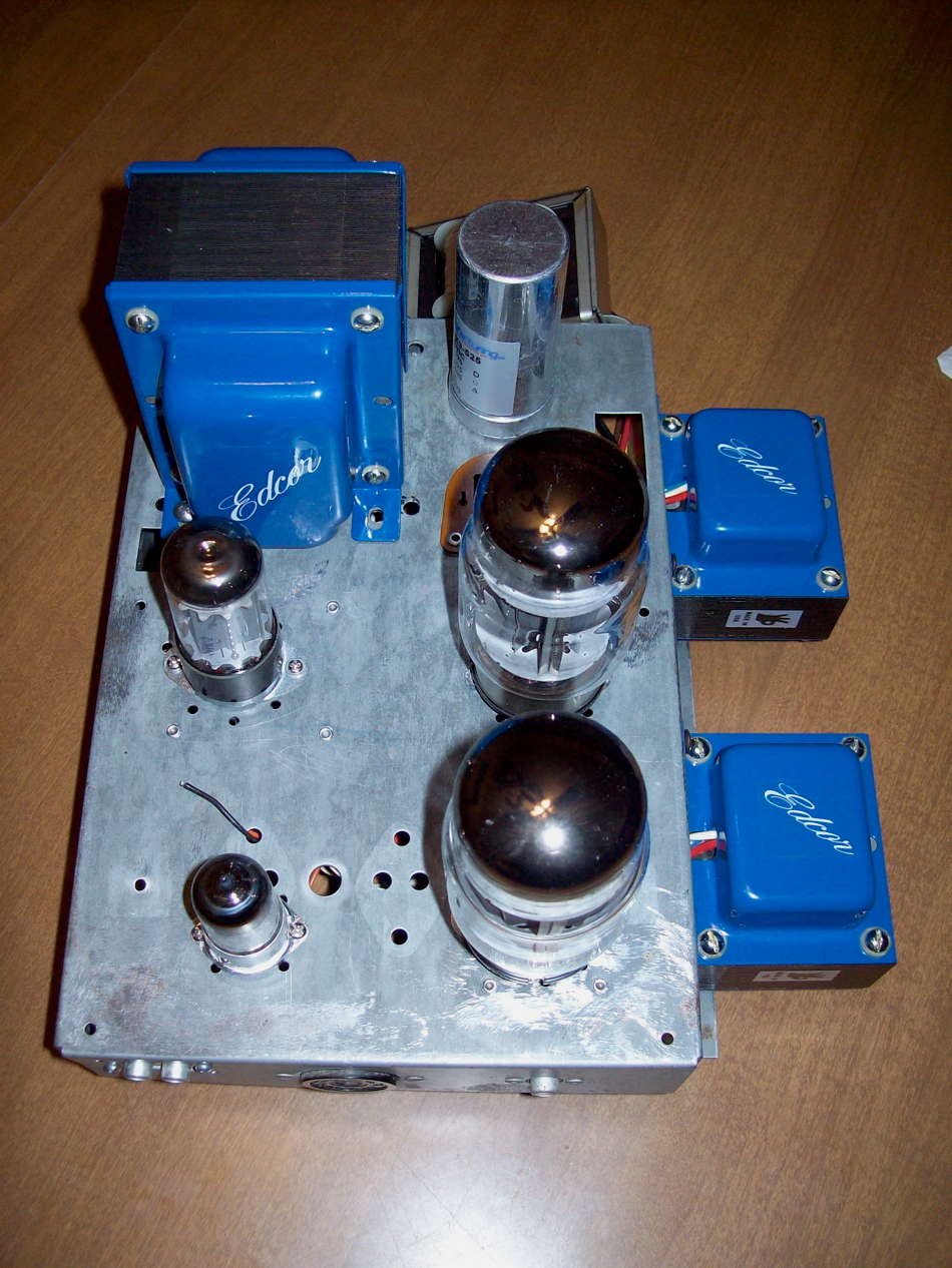

A point I may not have made clear is that even though these are separate chassis they will both be in the same wooden enclosure (console) and only the preamp chassis will be available to the touch unless the back is removed.
I don't have a close up of my cap but it is like this one except it is 3 section.
CE - USA 30µFx20µFx20µFx20µF / 525V
Here is the chassis before painting with the cap on it.

Looking at the caacitor, I have worked on these in the past.
You push the tags through the holes in the chassis and twist. The problem with them is that no matter how well you twist the tags they come loose and rock side to side and twist. This brakes the wires off the connections over time. So people solder the tags- then when they blow or go dry you cannot get them out. So they solder one tag- this brakes off with the rocking motion. The way around this is to mount with the twist and slip a standard through hole mount over the top bolt to chassis. (the ring that goes around a standard cap and the tags bolt to chassis). The tags if I am correct should earth the can to the chassis that go loose!
