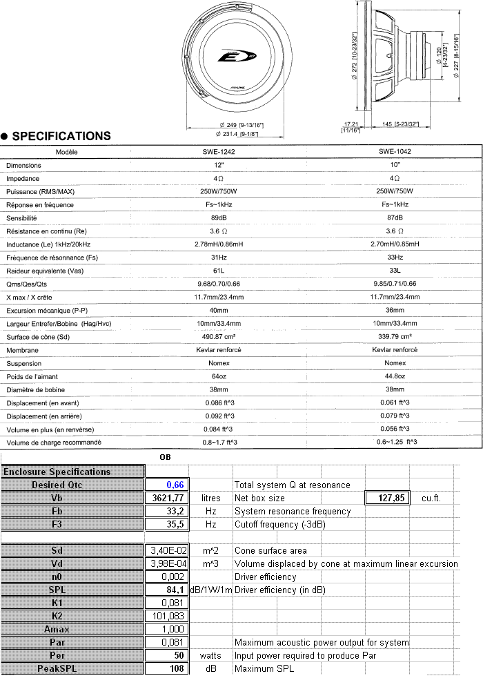

I still think you should look for a driver that's targeted towards the home market, instead of one that is targeted towards the car market. In general, a hi-fi market subwoofer will probably be more efficient, because it has less pretty plastic hanging from its moving structure. A lot of car woofers are just designed to soak up wattage without overheating, so heavy moving structures and stiff suspensions are common. Look at the Dayton Classic 15" subwoofer driver. This is a new one that I don't think many people are taking notice of, but it would probably suit your application well.

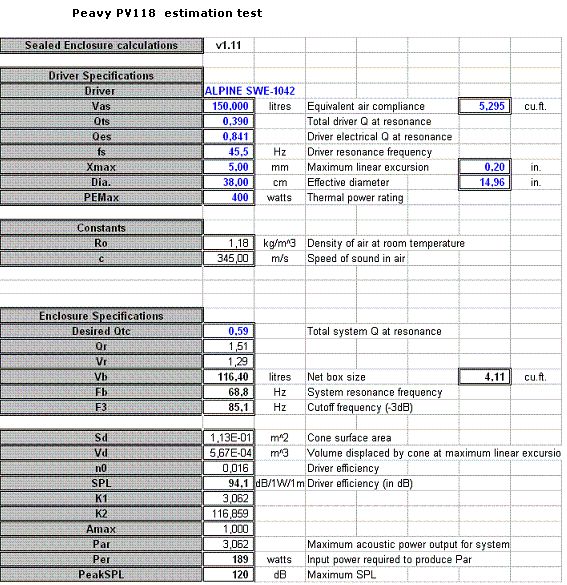

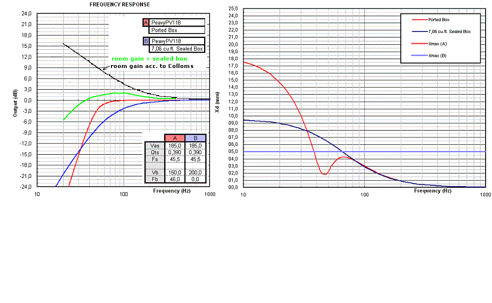

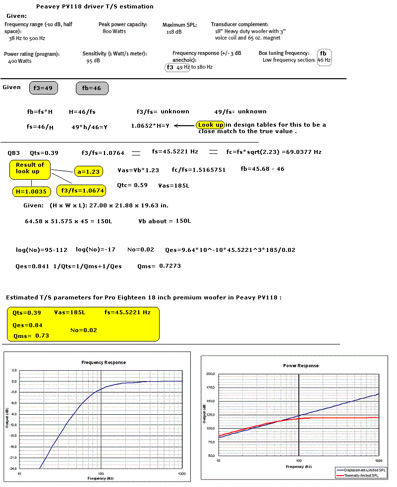

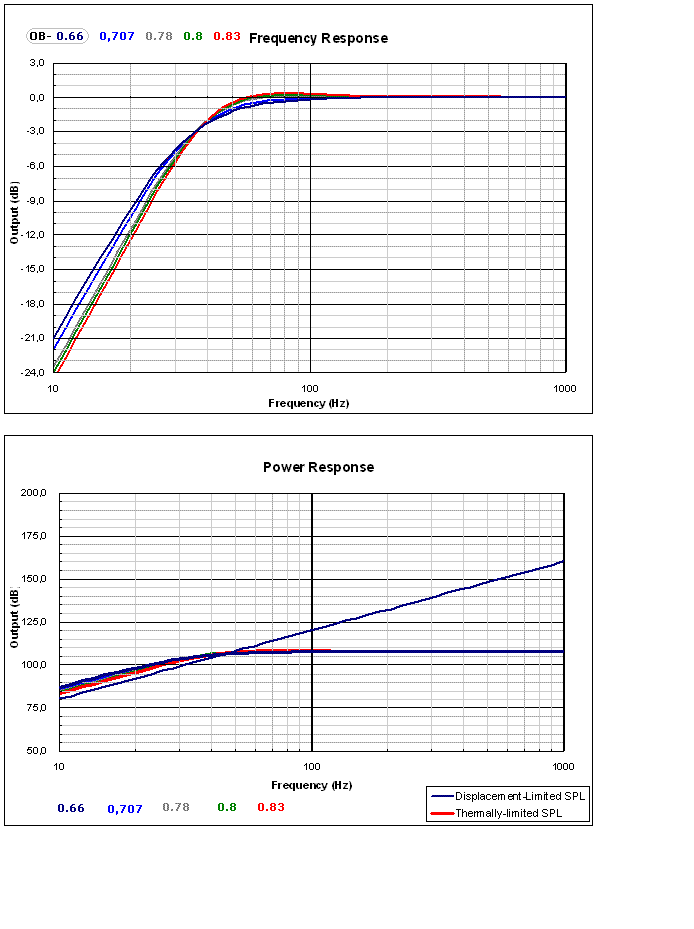

The Peavey PV118 bass driver is custom built in China.

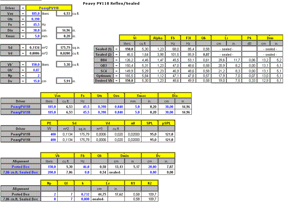

I could not find any data on the 18" driver so I tried to e-s-t-i-m-a-t-e the T/S parameters from the given sparse flyer information I found on the net.
Take a look at the pictures below. First two is for T/S estimation, which can’t be taken for guaranteed but possibly close enough to the real parameters.
I reasoned that the driver was made and optimised for a Qb3 reflex box since this gives the lowest requirements for box size/ f-3dB.
The last pictures are reflex box simulation using the calculated T/S-data.
Conclusions and my opinions: The driver in a 200 L sealed box might sound musical and can be classified as a bass-speaker rather than a sub-bass when placed close to a wall and from possible sound quality reasons I would never use drivers intended for cars or PA for Hi-Fi use at home.
B

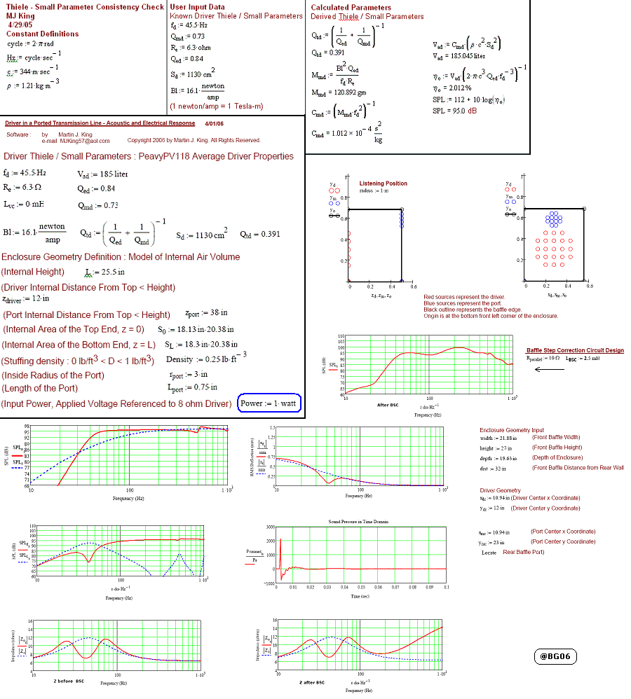

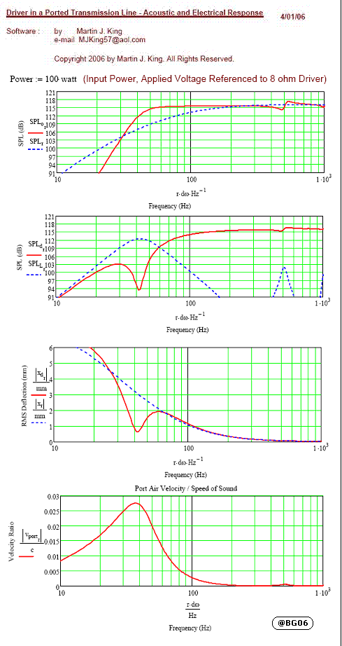

Today I used my newly downloaded software from www.quarter-wave.com and modelled the ported box.
Made first a consistent check of your data included and the T/S data recovered looks ‘plausible’ enough at 1 W modelling level.
When placing a 3” diameter minimum length port = 0.75” the maximum input power recommended is about 100W.
Maybe your port is even smaller? I placed the port at the rear of the box and know if on the front, disturbing sounds can be expected colouring at higher levels.
Take a look at the short TL port air velocity, it looks much better and this speaker is also better suited as a sub bass at home due to the low end FR slope.
B
1(3)
