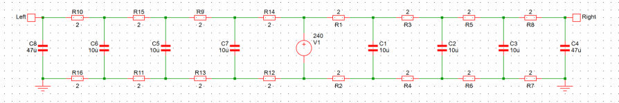

After playing with a network analyzer on an inexpensive valve amp, and realizing the power rails were causing (about -30 dB) crosstalk, I tried the following.
Single rectifier connected to a capacitor, which then fanned out to each channel through resistors on both the feed and return paths. Each channel obviously had its own capacitor. This worked, but not well enough. So a ladder filter was made, by adding capacitors and resistors. See the attached schematic for an example. Imagine the voltage source is the bridge rectifier.
It was a few years ago, so can't remember the number of stages (was as many as would fit) or the component values. Worked well though with a huge reduction in high-frequency coupling and reasonable improvement at the low end. There is a voltage drop due to the resistors, but small as they're low value. The idea is to have a very high-order filter to get rid of high-frequency coupling.
I find resistance in the gound between a rectifier and chassis ground a useful way of discouraging a little noise also. Somewhat unconventional in audio, but soft ground connections are fairly normal in industrial systems.

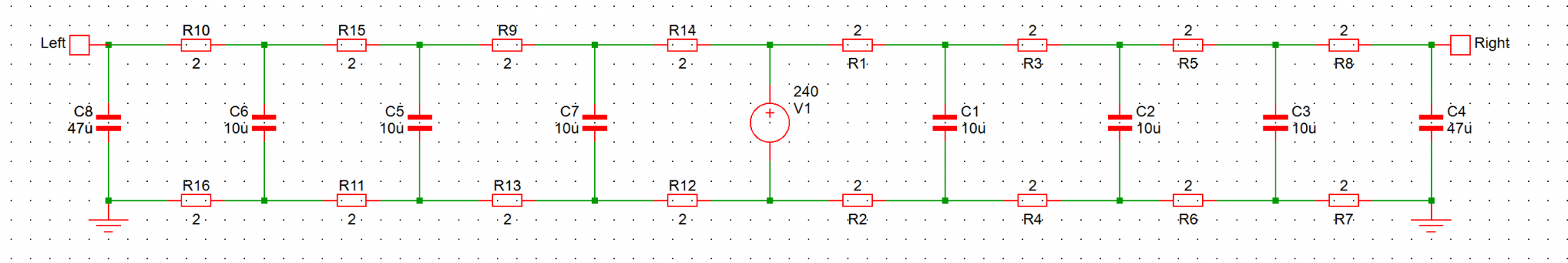

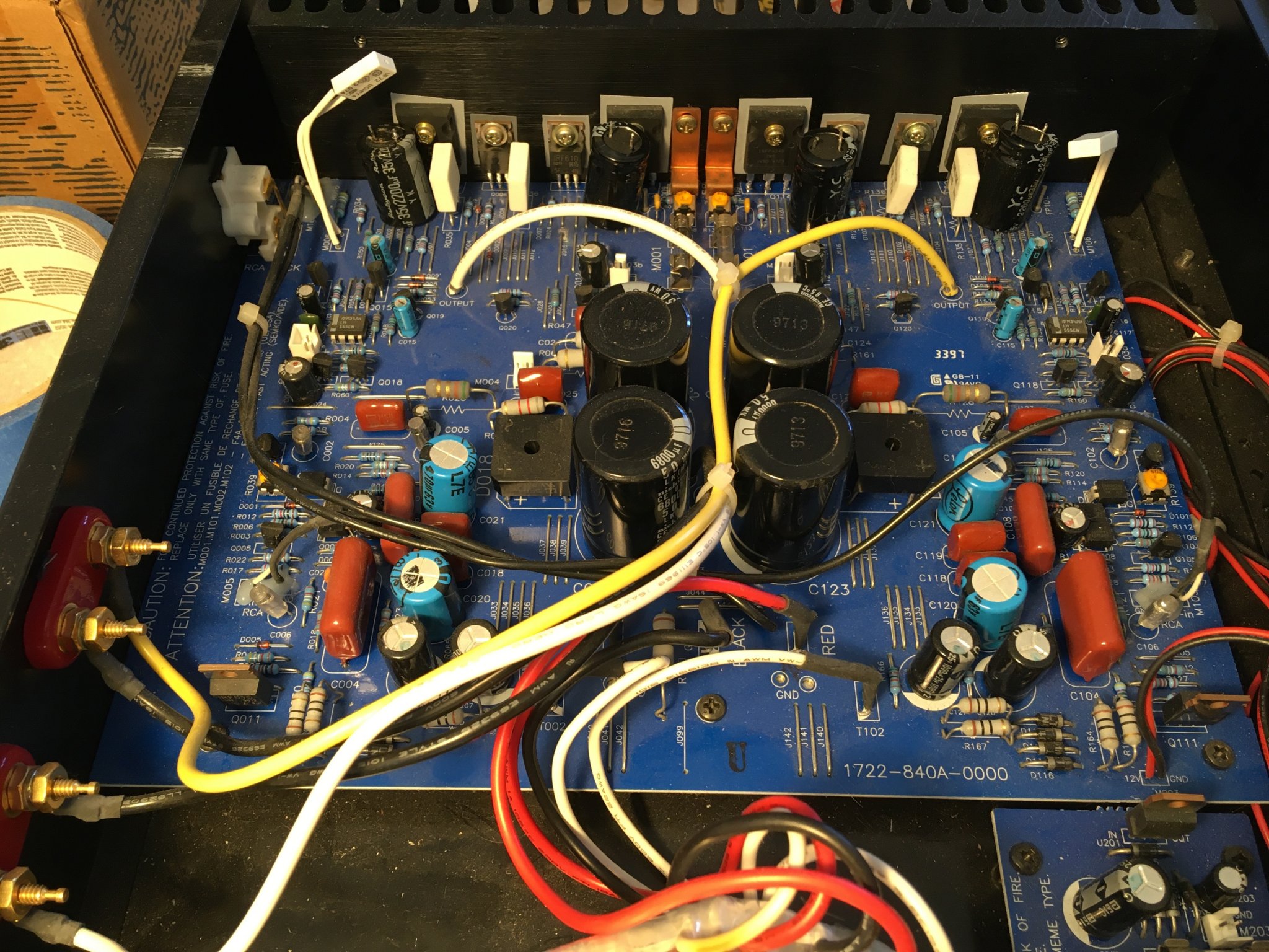

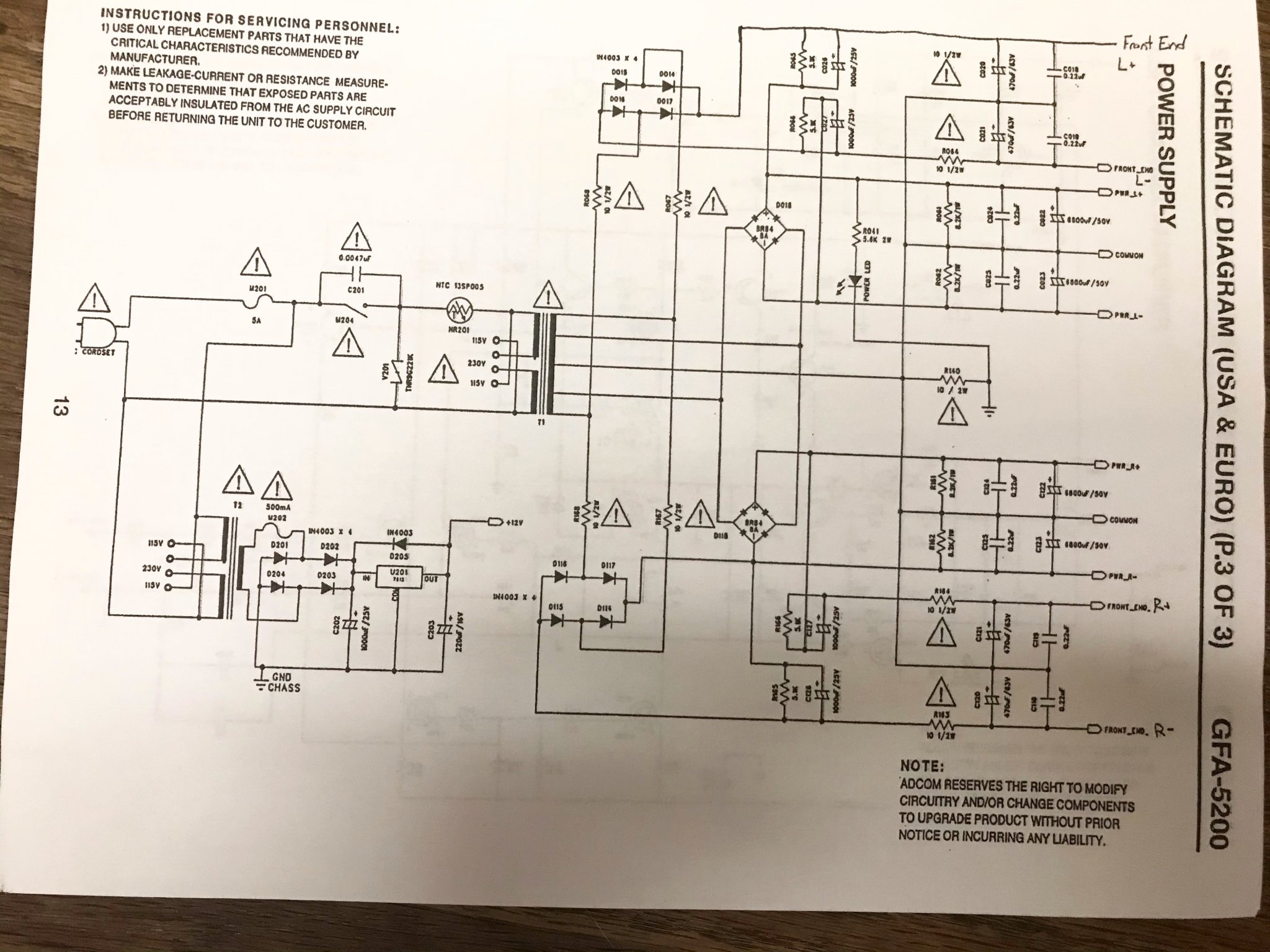

The later Adcom GFA-5200 is also connected this way (as in post #15) to make separate L and R output stage V rails from a single center-tapped secondary.
In the 5200, the front end gets separate PS rails also, but here 10 ohm resistors are inserted between the secondary and the diodes.
Could this arrangement be improved upon?
