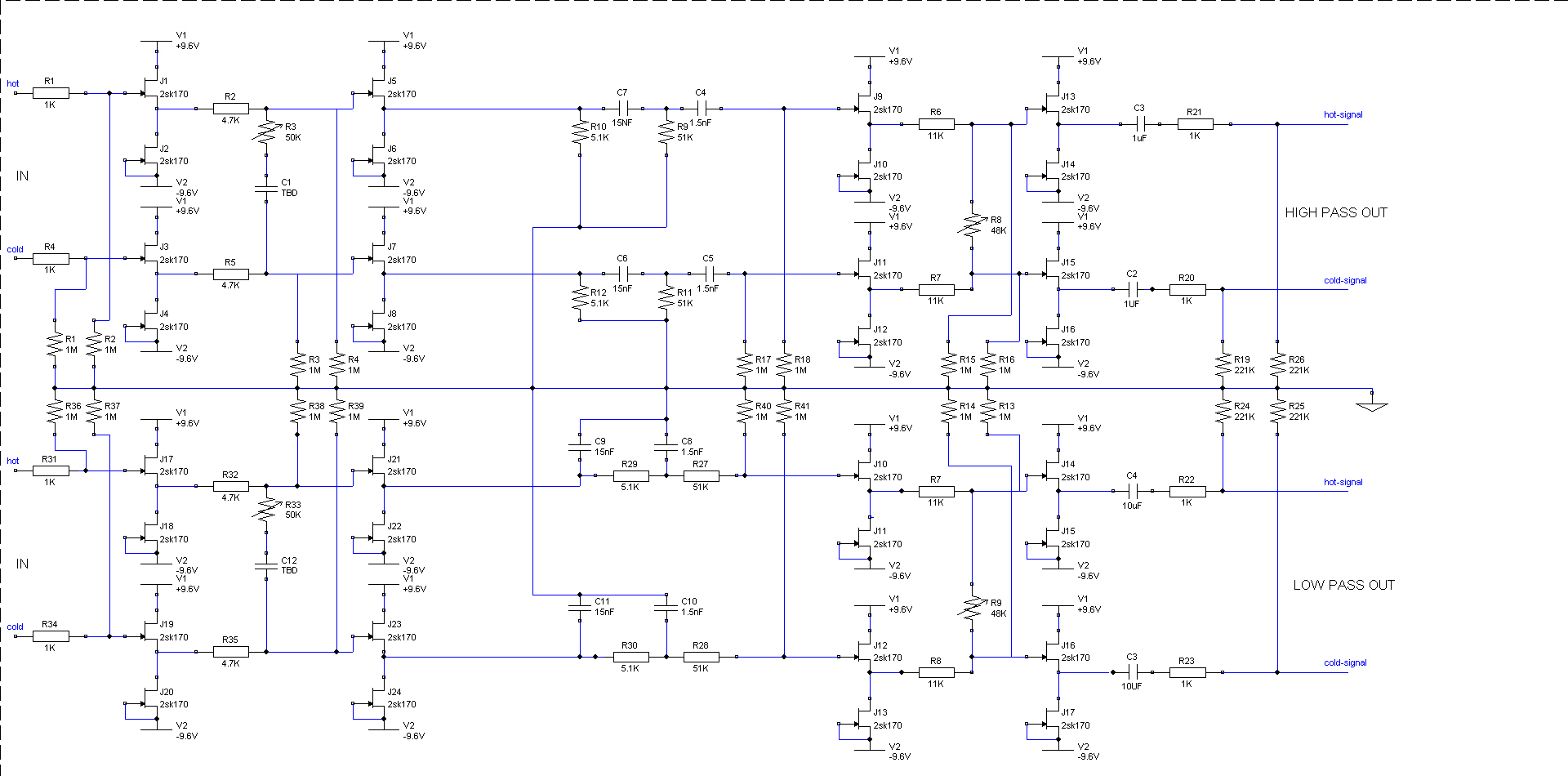

Baflle Step Compensation
An ideas on how to add a baffle step compensation to the XO. I think i need an additional buffer after the circuit and i would need to put the compensation network after the low pass, something like this:
signal in - 10K POT - B1 - LP (1st) - LP (2nd, switched) - B1 - BSC circuit - B1 - 25K POT - B1 - Signal Out
With the buffer you are right. The BSC would have to be of very high impedance (order of 1M) if the LP should be able to drive it on his own.

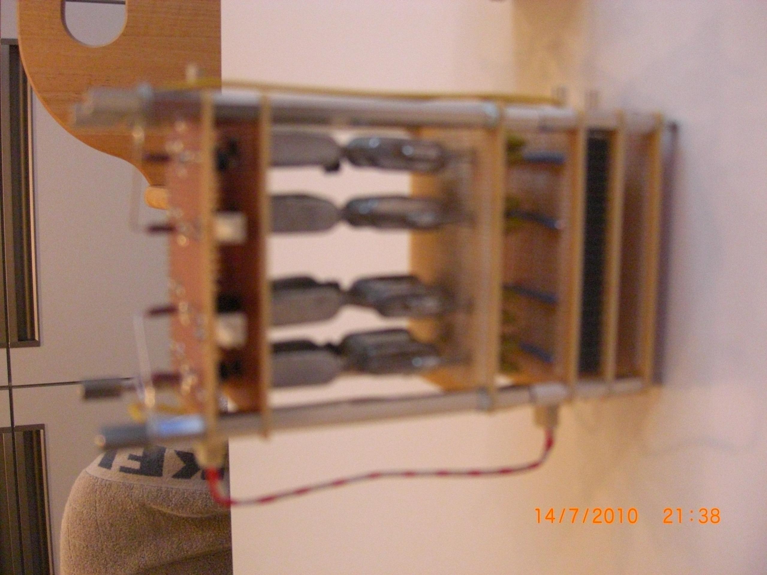

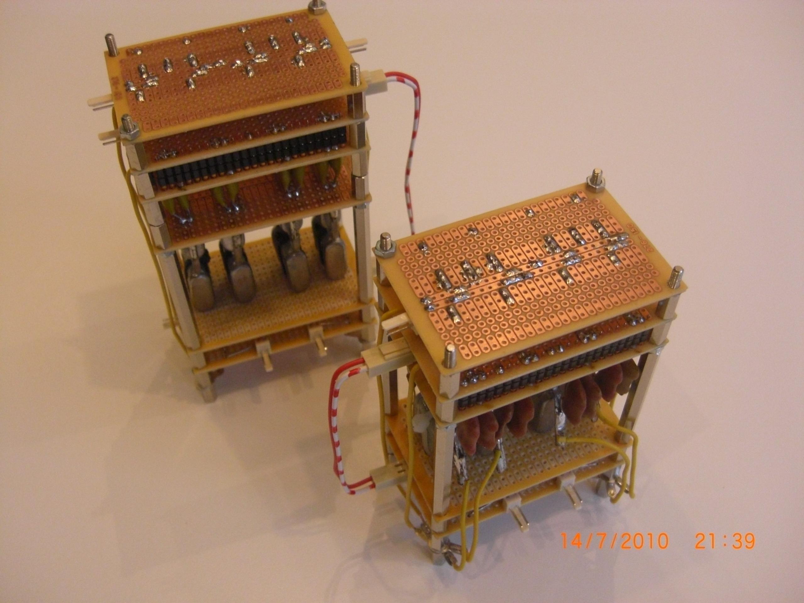

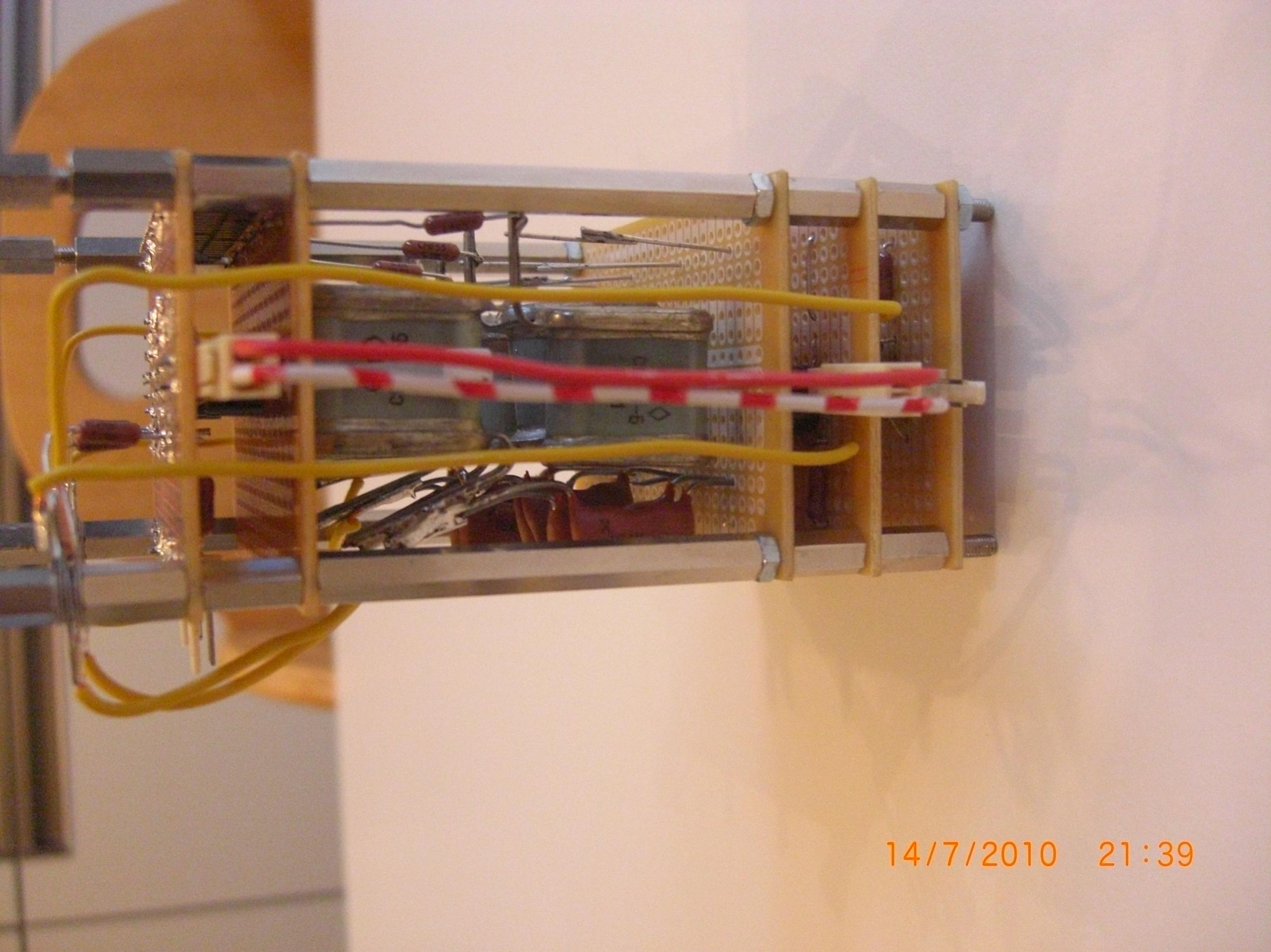

I am currently soldering the buffers and the filters into a modular system. I am still waiting for some components. I will post some pictures soon.

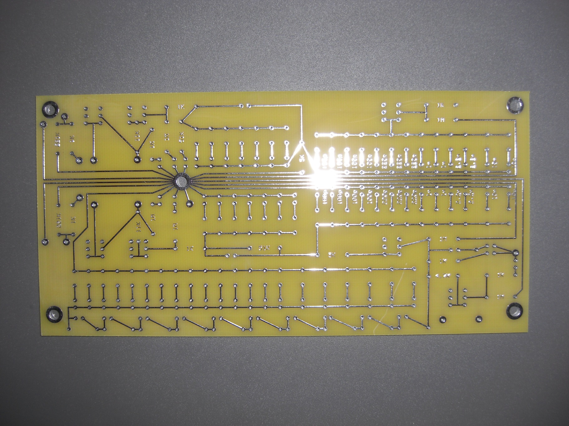

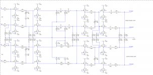

I listened to my prototype for some time and i am very happy with the results. I am now building my final design, but i changed a few things:
- Battery changed to mains power
- Start on audio signal (also for attached power amp)
- baffle step circuit integrated, can be switched on/off with jumper
- pcb's from pcb express no veroboard
- optimised circuit
- 1st + 2nd order filter, 2nd order can be switch on/off with jumper
- HP-filter and LP-filter use fixed resistors and variable capacitor for setting frequencies. I do this by adding capacitors from a capacitor bank using jumpers
- same applies for the baffle step circuit. But here i also need a resistor bank. Combinations of capacitor + resistor values give me a my shelving frequency and the amount of "baffle step", depending on the width of the speaker.
