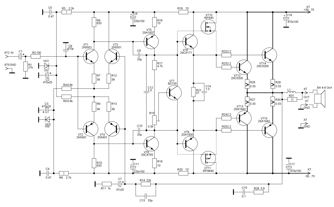

Now, what's wrong with 50 years old design? 2 differential cascades with current mirror is highly linear, robust design in principle.
I design and build very new stuff, including non-standard CFA designs, however my VFA, based on Pioneer M3 Exclusive (1973) is an excellent amp I often use as a reference.
In which part DX Blame is newer than the 50 years old one?
The right one, symmetrical, simply has design problems - I already mentioned them in the other thread. It will not work properly as is. The left one will, even in the hands of not too experienced builder.

Agree, we have to encourage people to discover new horizons😀 No more 50 years old designs.
How about it? Looks familiar? Have for more than 10 years. Enjoy very much, enjoy myself and all my neighbors.
The left one is hundred years old design. Nothing special about it. I always was wandering why people stick to old stuff ?? How you can say it is HI quality by looking at the schematic? =) It is so called Marshall design, 50 years old, nothing special, parameters depend purely on elements selection.
The right one, is the same. Pure symmetrical amplifier. Nothing special. Why bother make it? 2014 year outside the window.

I am not a fun of symmetrical amps. No experience. I have the one that I posted above. The thing why chose it was damping factor. The author claims it to be 1000 in range of 5Hz..20kHz.

To be specific: Which amplifier recommend this the first or the Russian Lanzaro?🙄
Or maybe this could come into consideration?🙁

The schematic is Russian (look alike) and it is clever.... it is confused because the way was made.... too much informations, too much crowdy to let us understand easy.
This way, supported by better layout and more simulations, you may see the amplifier is not bad.
Maybe you did....i have not read the entire thread...go ahead folks...it is not a bad amplifier.
