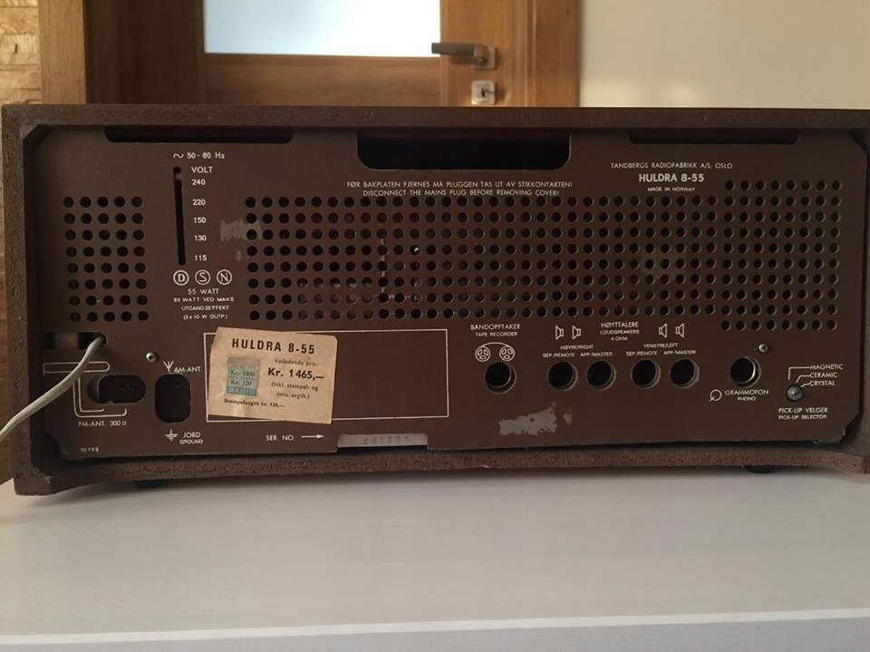

Hello, fellow audio folk. I'm really new to this whole scene so please excuse my naivety. I recently inherited a Huldra 8, a Tandberg TR200 and a pair of Tandberg speakers from my parents. I love their design and sound, but they are pretty old and have limited cable inputs/outputs. The Huldra 8 is a tube amplifier, so I would prefer to use that one. However it only has phono for input. I have been able to connect the TR200 to my computer (using a HDVD800 as a DAC) and it plays wonderfully.
On to my question, and sorry if this is the wrong topic to post this in. So I want to use the Huldra 8 mainly, but seeing how it only has phono input it can only really play music from a record player, right? Based on what I've read. So the compromise I've come up with is to use the Huldra 8 for records and the TR200 for computer audio. The problem though is I only have one pair of speakers. Is there a way to somehow connect the one pair to two amps? Or connect the two amps together? Even better would be if there was a way to get computer audio on the Huldra 8. I don't have the space or the money currently to buy another pair of speakers, though I know this would be the easiest option. Any help is really appreciated!

The type of pre-amp in use in the Huldra 8 is chosen by a selector switch on the rear of the unit (see attachment). Selecting 'ceramic' will give you a high impedance input which should work OK with your computer/DAC.
I would obtain an external two-way input selector switch unit to connect to the phono input of the Huldra 8 so you can toggle between your computer input and your record player input (selecting the appropriate pre-amp for each using the Huldra's inbuilt selector switch).
It is not a good idea to switch two amps between one set of speakers when one of them is a tube amp - you could damage the tube amp.

I could be wrong, but I think the Huldra 8 is a solid state amplifier with tube tuner section, and the phono input need a Inverse RIAA circuit to accept normal line input.
BTW, why not use the tape recorder input?

Okay! Thank you both for your inputs! I was slightly confused, but I think I understand now. So the amp itself on the Huldra 8 is solid state, the same as the TR200. I just got a price estimation to fix the Huldra 8 at about $170 from a service company I delivered it to. The TR200 works perfectly, beautiful sound. Should I just keep the Huldra 8 as an antique? I guess that's up to me personally, but do you have any arguments for or against?

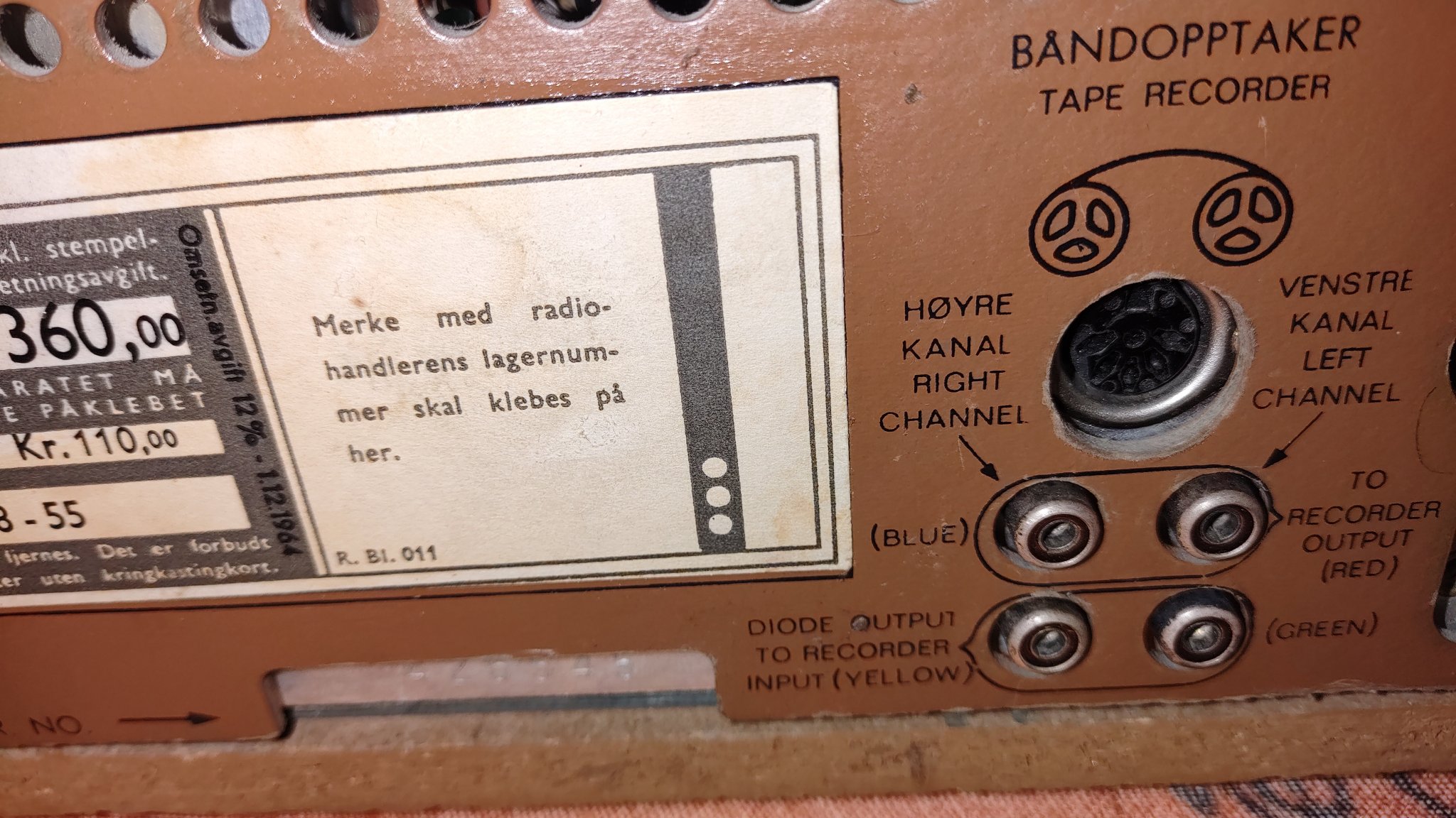

Also, what kind of plugs are those for the tape recorder? Banana plugs? I might try and get a radio antenna for the Huldra and use it as a radio
The tape recorder plug will be a 'DIN' plug. Either a '5 pin DIN' or a '3 pin DIN'. I can't see the socket clearly on the photo I supplied. There should be information in the manual.

I was thinking on the plugs for the Huldra 8. They look like brown rca plugs or something. I am currently using a 5 pin DIN plut on the TR200 on the Extra input. Had to buy 2 XLR to RCA plugs and a RCA to 5 DIN cable. It's of really low quality though so I want to get a custom one made once I have the money for it.
Oh, of course! That big one on top is a 5 DIN! Sorry, completely forgot about it. I decided to get it fixed since it has sentimental value for my family. It's nice to know I can use the same cable I use for the TR200 to the Huldra. Thanks for all the help and wisdom!
