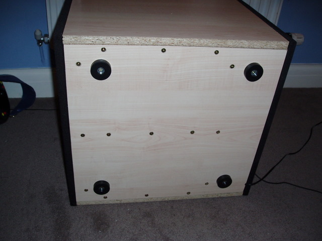

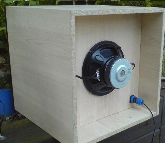

Ok - subwoofer all built - even mum is pleased
I decided on a cube shape
drivers in push/push configuration, with one driver facing into the cabinet, and one facing out
This removed second harmonic distortion.
Then I built the thing
I was forced to use chipboard, because we have loads of it, and it matches the furnature in my room...

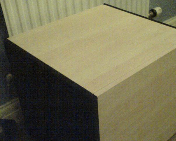

made 2 black covers (MDF + speaker cloth)
stuck those on with sticky pads
I have only braced it vertically so far
Plan to make some horizontal braces, weather permitting...
I also "borrowed" dad's 17 year old PA amp - I know it's not ideal, but it was that or a 7W/channel amp I took out of some rubbish 2.0 speakers.
Pictures attatched...

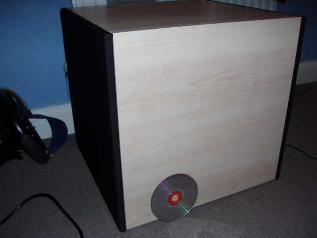

The review
and with the covers on, in my room
Well, it's not the loudest I've heard, but it's (easily) the lowest (not including cinemas)
The bass is fast, low, and generally chunky sounding - which is good
The thing is that i spent £32 on drivers
£5 on LT circuit components
£5 on MDF + speaker cloth
The rest I already had (eg amp)
so - my £42 project, which created "the best-sounding reasonable-sized sub I've ever heard" - according to dad, who is (past 40) positively ancient, and must have heard some systems in "his time".
I will draw up the design, and post that, with pics of bracing etc, when I find the time...
