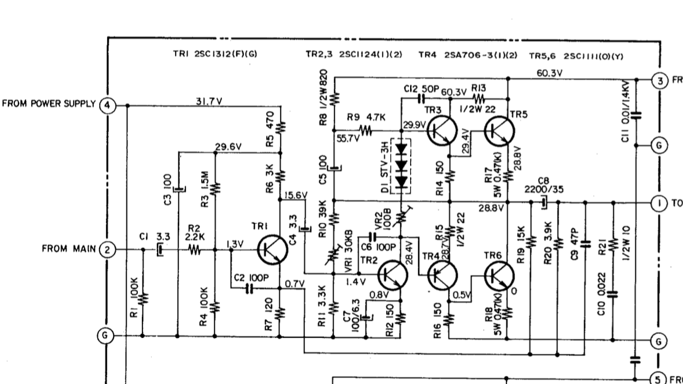

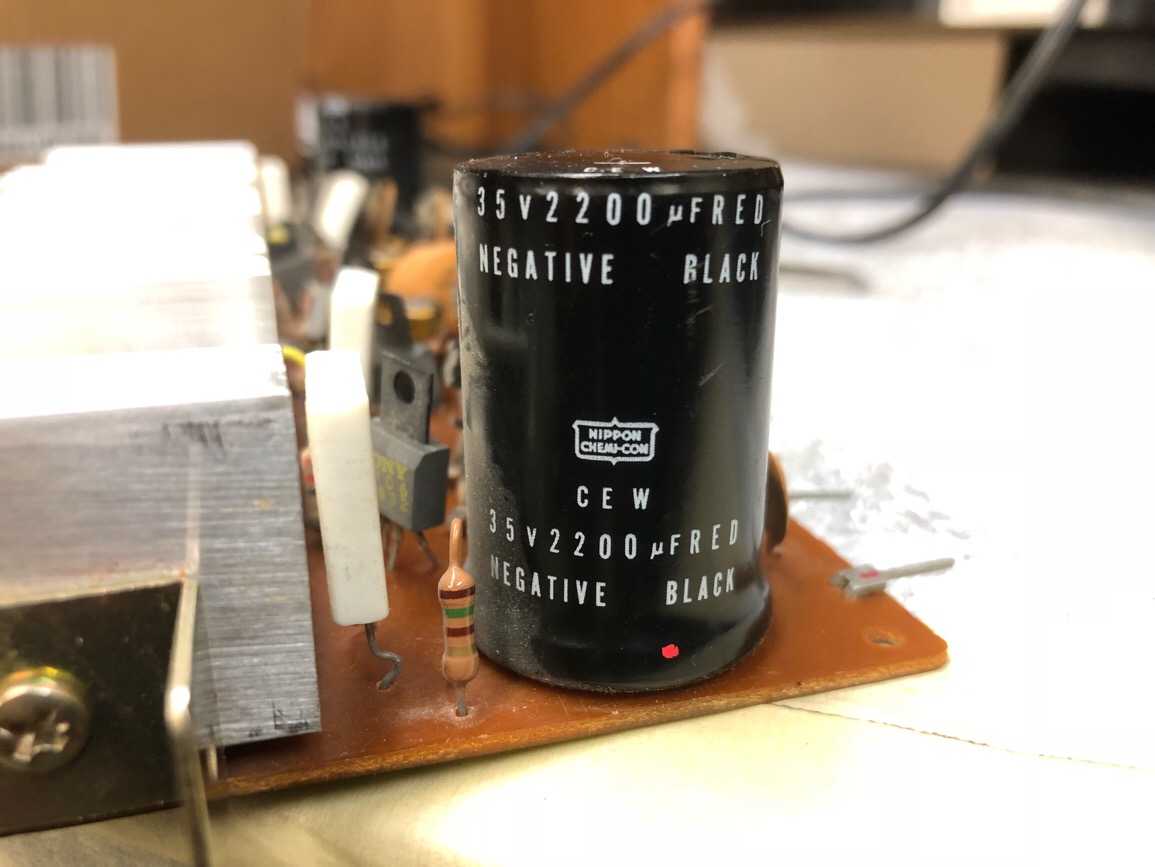

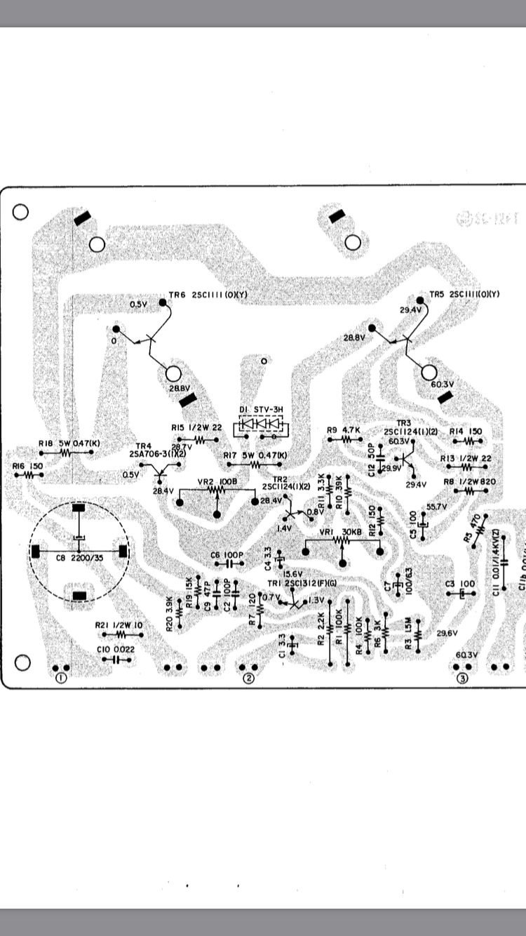

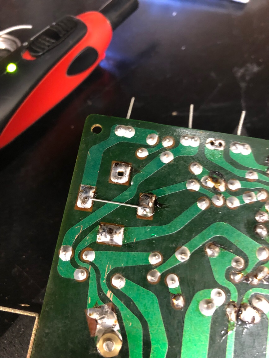

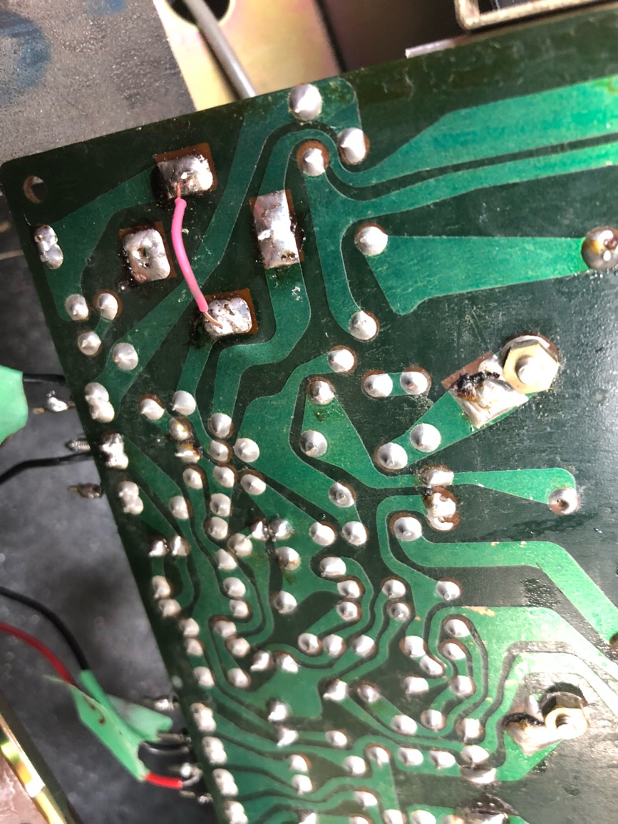

Two 4 pin capacitor on the power amp PC board of my receiver

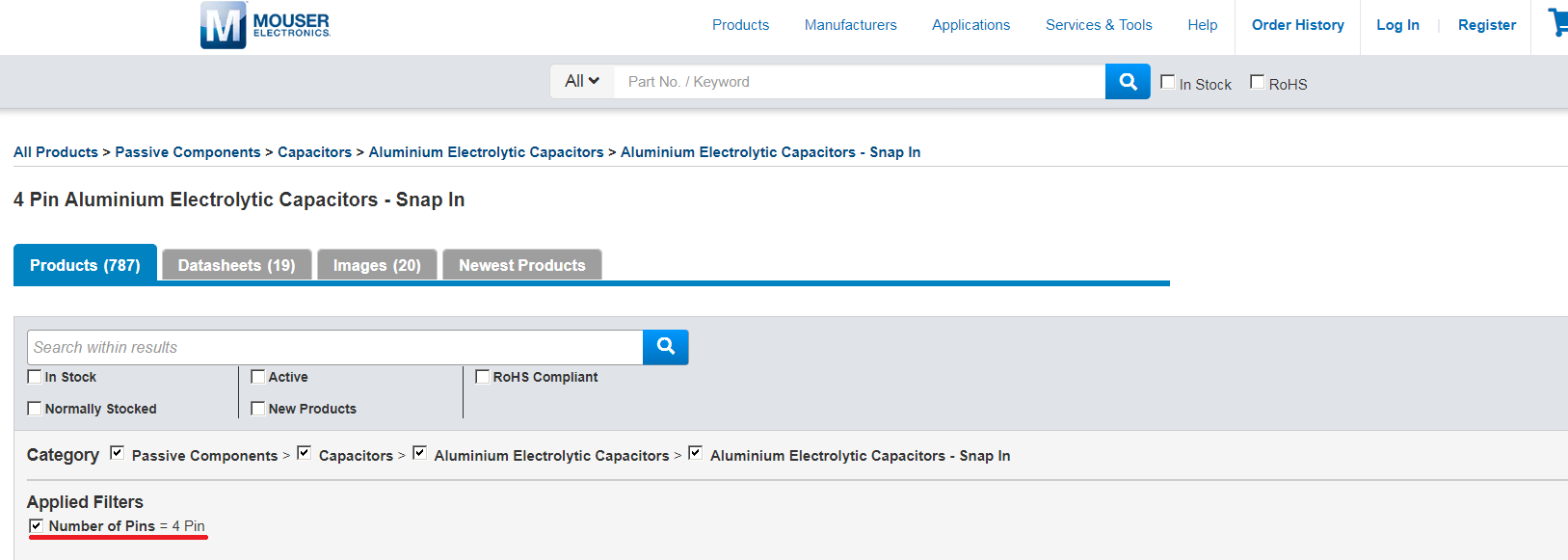

I’m changing the capacitors on my receiver and I found two big capacitors on the power amplifier board. They both have four pins and when I look at the back of the board I found that oly one looks like a dummy. Hi Can’t find Anything the Web that looks like that. Somme People talk about 3 pincapacitor that are in fact two capacitors in one with a common negative pin. Is there someone familiar with that kind of capacitor that could help me?

As both label, schematic an PCB layout show, you have a single 2200uF x 35V capacitor.
4 pins?

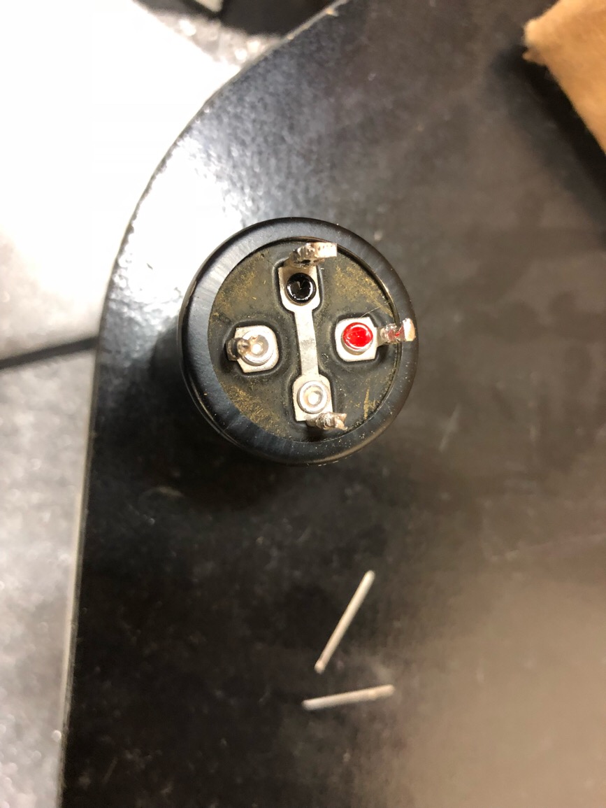

One of them is positive, other 3 are negative and most probably connected to aluminum case (they *might* float though).
Check for continuity between them.
Why 4?
For mounting and stability.
If you look at the third picrture inside the capacitor drawing showed in the middle the four connections of the capacitor. The top it is the positive, the bottom it is floating or doing nothing and the middle ones are the ground. Hope it may help

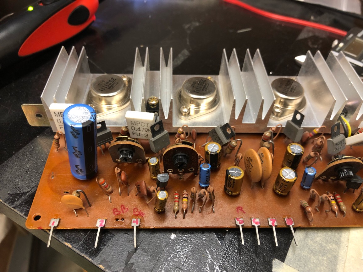

Thanks to everyone! It was more obvious what it was once remove from the board. Here are some picture of the work done.
