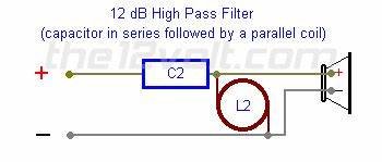

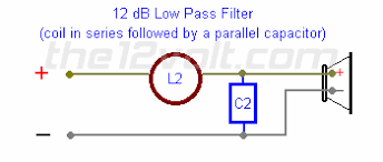

I know that woofer is 4inch 12-25w 8ohm and tweeter is 1 inch 12-25w 8ohm
In that case, I can only suggest a simple crossover circuit. It will divide the frequencies, but won't be the perfect match for the unknown drivers.
Would that be good for you?
One other question, how did you arrive at your requirement for a 2.8 kHz crossover frequency?
Oh! What about photos of the drivers?
I can take a photo but not today because im not home but i will post it as soon as possible. 2.8 khz was the highest frequency at which the woofer was still somehow loud. When I went higher it was much quieter
And also tweeter at that frequency was loud. Lower frequencies was quieter
It sounds like you could run the the woofer direct from the amplifier and simply put a high pass filter in front of the tweeter.
We just have make sure the tweeter is adequately protected from the low frequencies.
The circuit for the tweeter high pass filter is shown in the first attachment.
The capacitor (C) can be a bipolar (non-polar or NP) type of value 4.7 uF.
The inductor (L) can be an air-core type of value 0.60 mH.
If the tweeter turns out to be too loud, then put a 5W or 10W ceramic wire-wound resistor of value 1.0 to 2.2 ohms in front of the capacitor.
(If necessary, you can put a low pass filter in front of the woofer. Use the same L and C values, but arrange them as shown in the second attachment.)

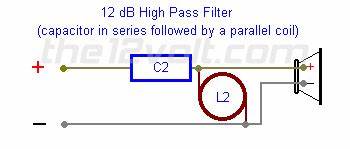

Thank you very much, and also I completely forgot that when i look into the enclosure, there was 4.7uf capacitor in series with tweeter if that somehow helps
Yes, the very simplest form of crossover is a capacitor in series with the tweeter.
If you want to keep it very simple, then run the woofer direct from the amp and put a capacitor of value 2.2 to 4.7 uF in series with the tweeter.
The tweeter is less likely to get overloaded by low frequencies if you use the lower capacitor value.
It's worth experimenting with the capacitor value!
EDIT: Changed higher to lower capacitor value - a slip of the brain!
