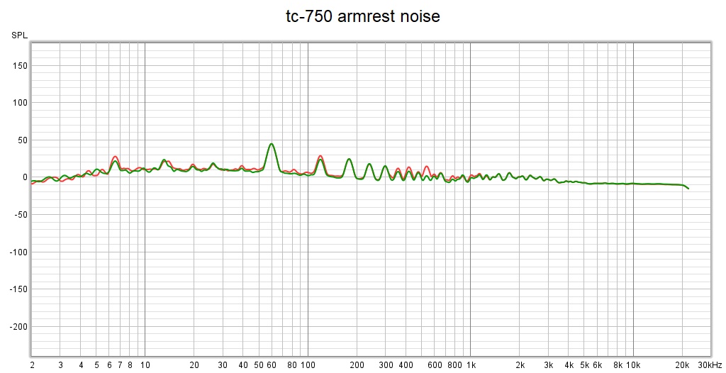

noise != noise
There are many kinds of noise. To get an idea of yours, you should record that noise to a mp3-file and publish it here.
I've done that, actually. With the arm on the rest, I record a sample and then use REW to take a look. I've attached a screen shot.
FWIW, I've improved cord routing since this point, and noise has dropped. But I'd like less sensitivity to the cord routing.
Thanks for any/all help.
I see peaks of 60Hz,120Hz, 180Hz ...
This is the spectrum of rectified 60Hz mains. This is rather hum than noise.
I suspect this noise will disapear completely when you connect your secondary cicuit with mains PE. In that I could give an explanation.

I got it sorted for now with a couple of 470uf 50v caps I found in an assortment I once purchased to help fix something else. I also reinstalled the 470-Ohm resistor that had been removed.
I then swung the untwisted cord around and couldn't detect much (any?) sensitivity to placement. So I guess the question of whether twisting the cord makes sense is moot.
