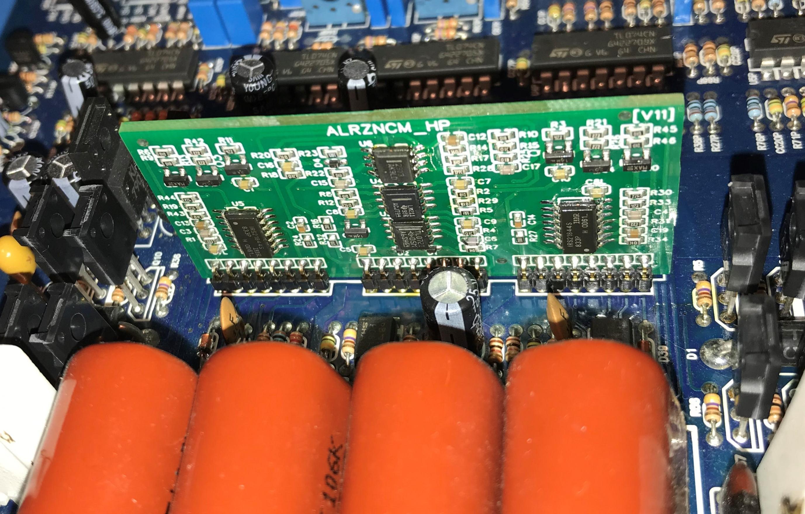

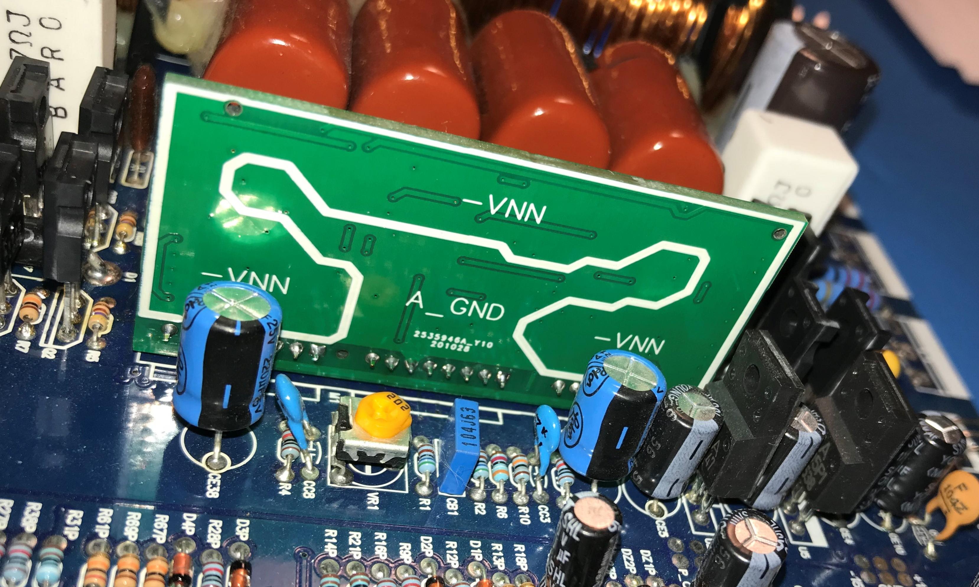

Perry, I also initially though it must be probe settings, but alas it was not. I continued to see voltages on pin 2 of the IRS21844s and eventually came to the conclusion, after removing allot of components, that the PCB itself had become conductive. This is without any visible defects.

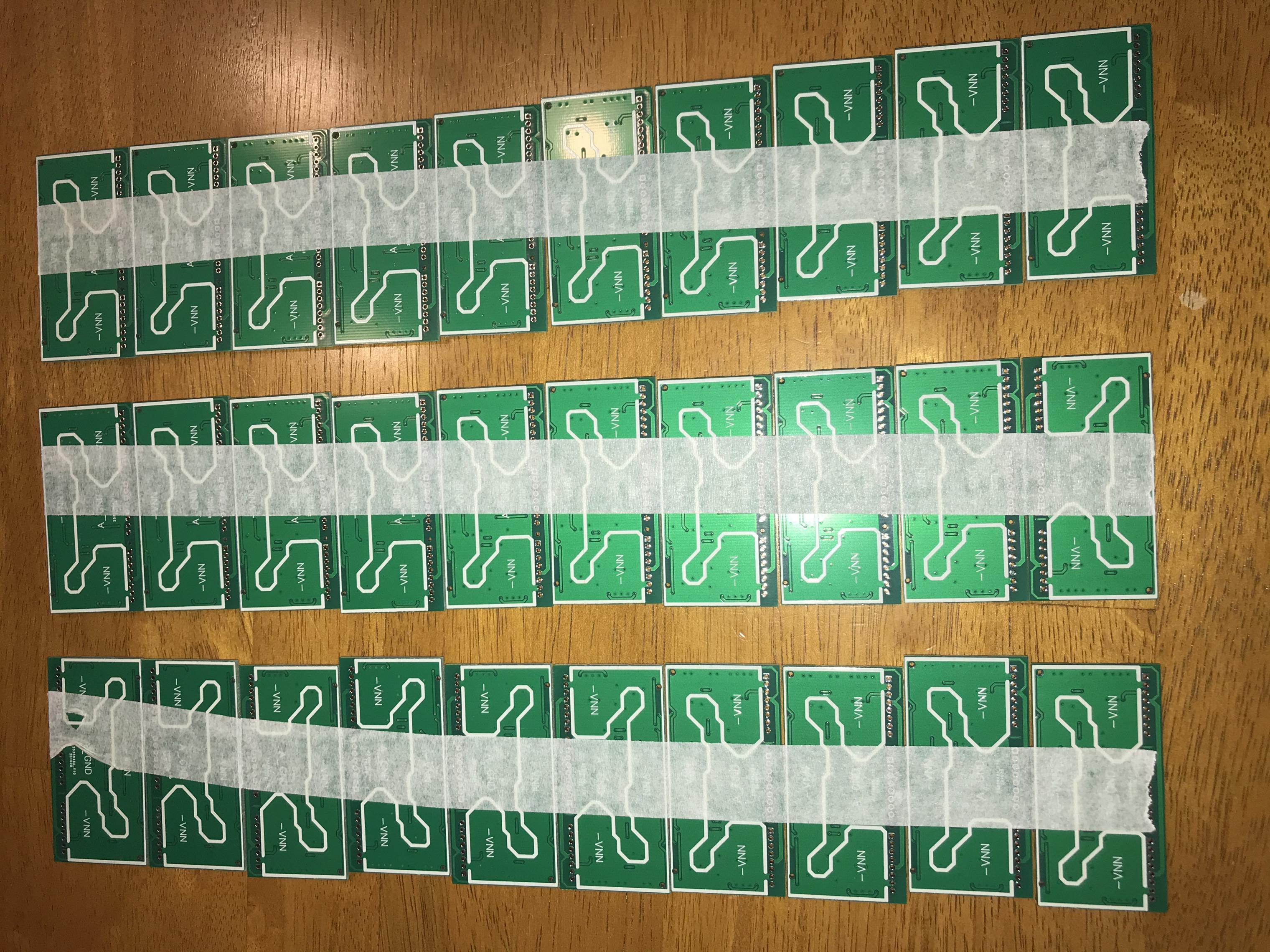

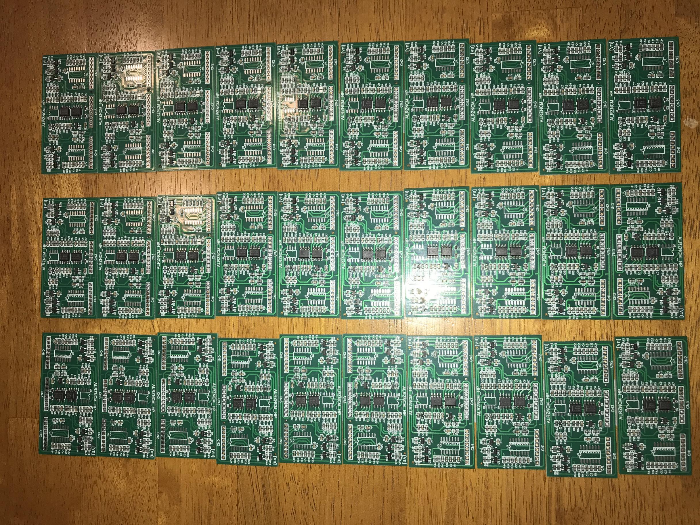

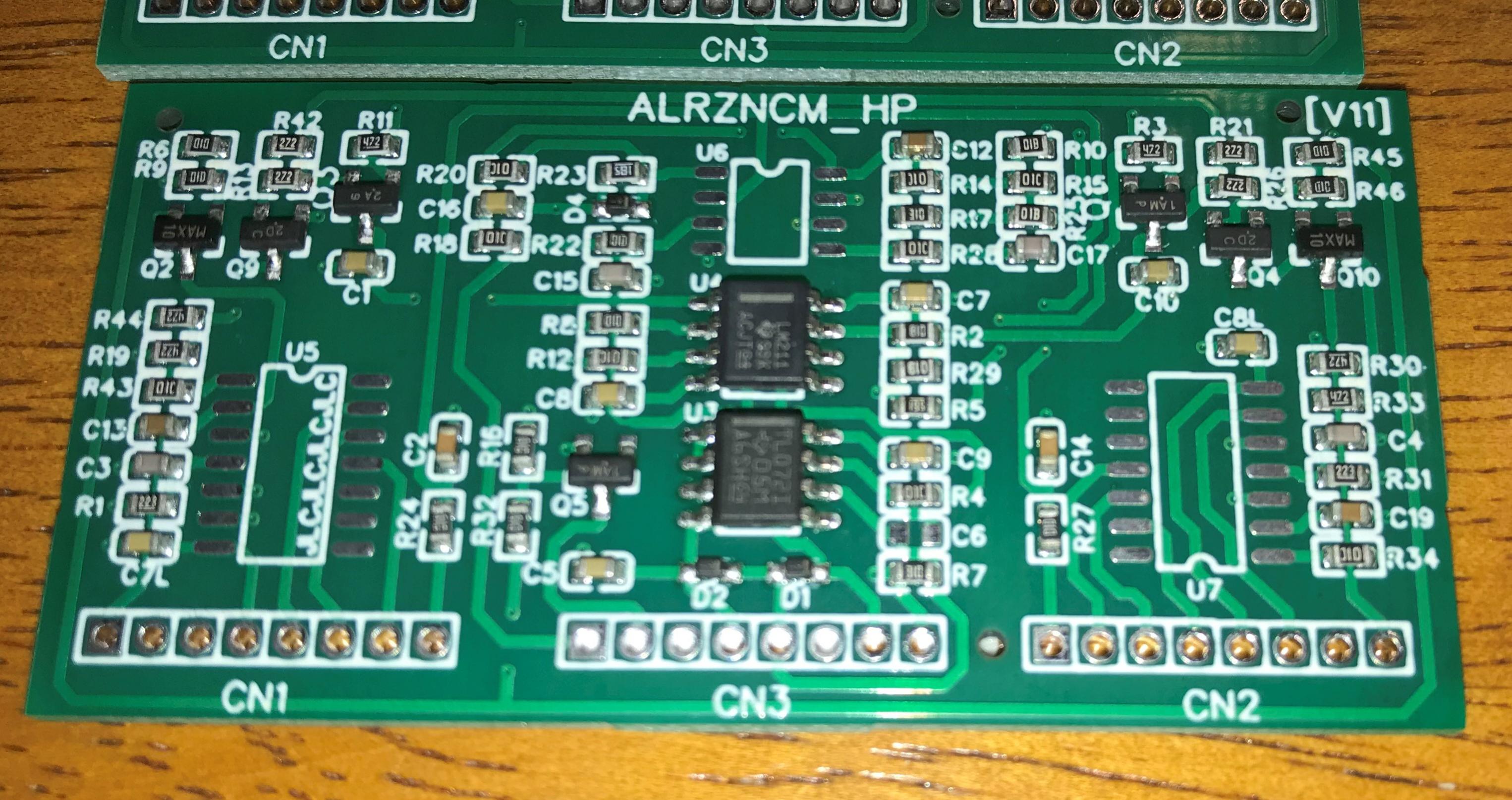

I ended up reverse engineering the driver board like other have, with a few minor changes and had some manufactured. The changes was nothing significant and included correctly connecting the unused portion of the TL072, slightly thicker traces throughout and also slightly larger pad footprints for the IRS21844s, that should make it a little easier to replace drivers in future.
I used Texas Instrument devices and had to add the 2903, a 5% NP0 capacitor in the feedback path, and the 21844s myself.
I have a good understanding of this particular design, because of this repair.
Thanks again for all the help!
