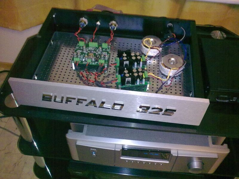

Here is my version of B32s. Started with the electronics today and could not help finishing it. It even worked the first try. I guess i am not all thumbs with DIY stuff after all.
I gotta say, i love the sound compared to Benchmark DAC1 (vanilla). Well, i think i just love the sound, with or without comparisons.
