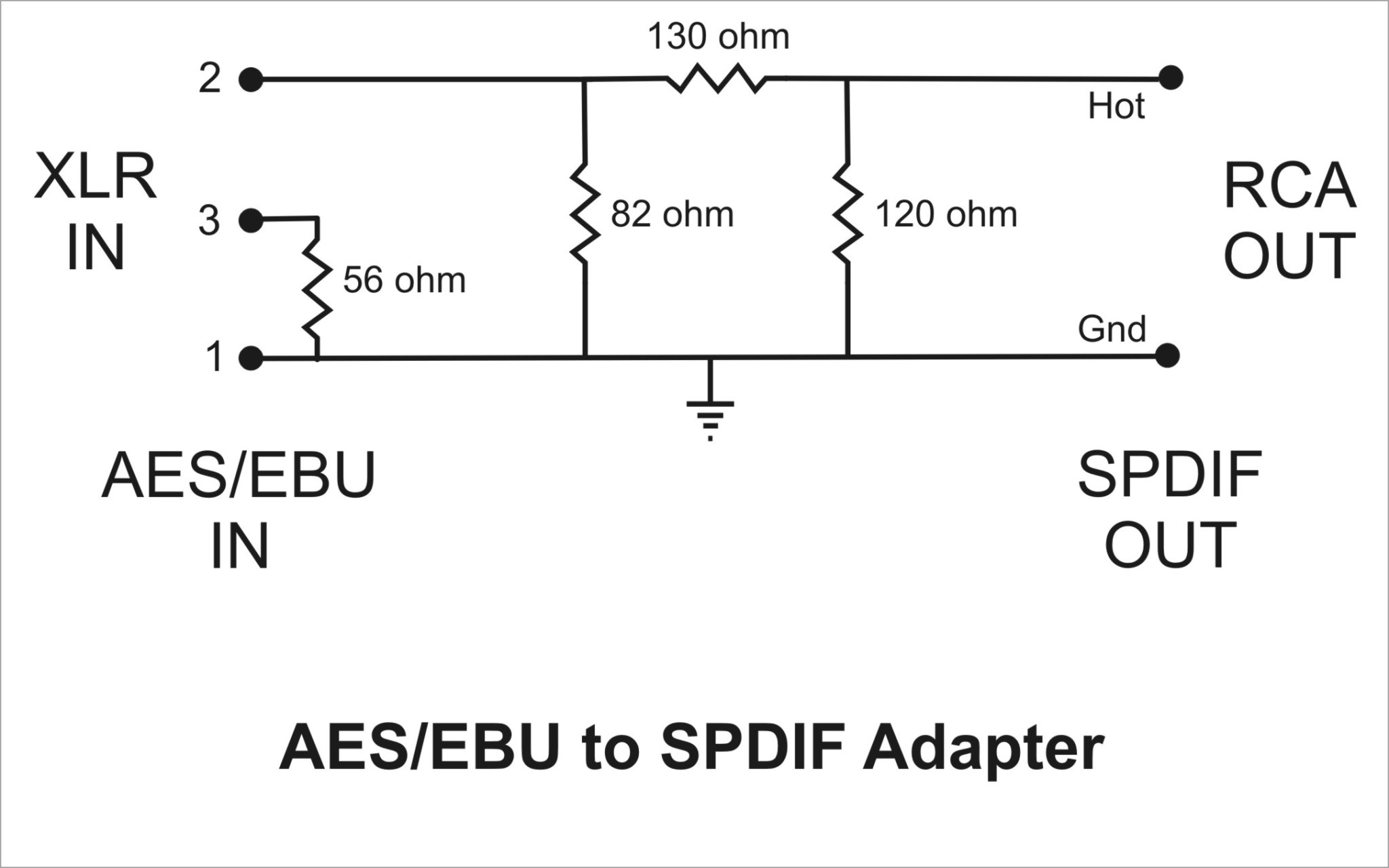

I'm having problems with a TW 4:1 mux /demux switch and hope someone can help! I'm using the switch to switch between Optical, SPDIF and AES.
Everything works perfectly until I connect the AES input. Then the output from the AES input comes out whatever source position is selected and any other source does not come out.
I'm using an impedance /voltage converter circuit for the AES input but I get the same problem when using a Canare conversion transformer.
I tried connecting the AES input to another input position and the same thing happens. Anybody any clues as to what's happening?

Thanks for the reply. I have used both a resistor output /impedance adapter and a Canare transformer adapter with the same results. In fact, I checked yesterday and the same thing is happening with SPDIF input as well.
David
Here's the resistor version. The Canare transformer is a transformer solution
In terms of grounds:
1. The MUX power ground is shared with the TW optical board
2. SPDIF output ground connects to the Buffalo 11se Pro DAC Board spdif input
3. AES, SPDIF and Optical grounds connect to the respective input grounds on the MUX Board
