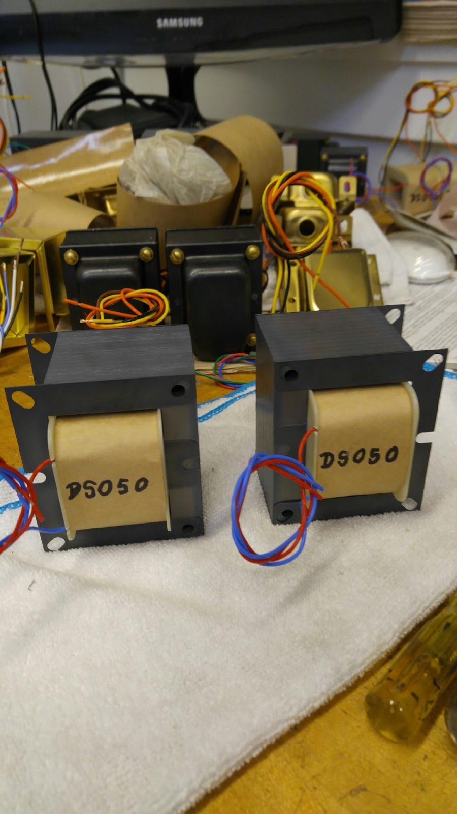

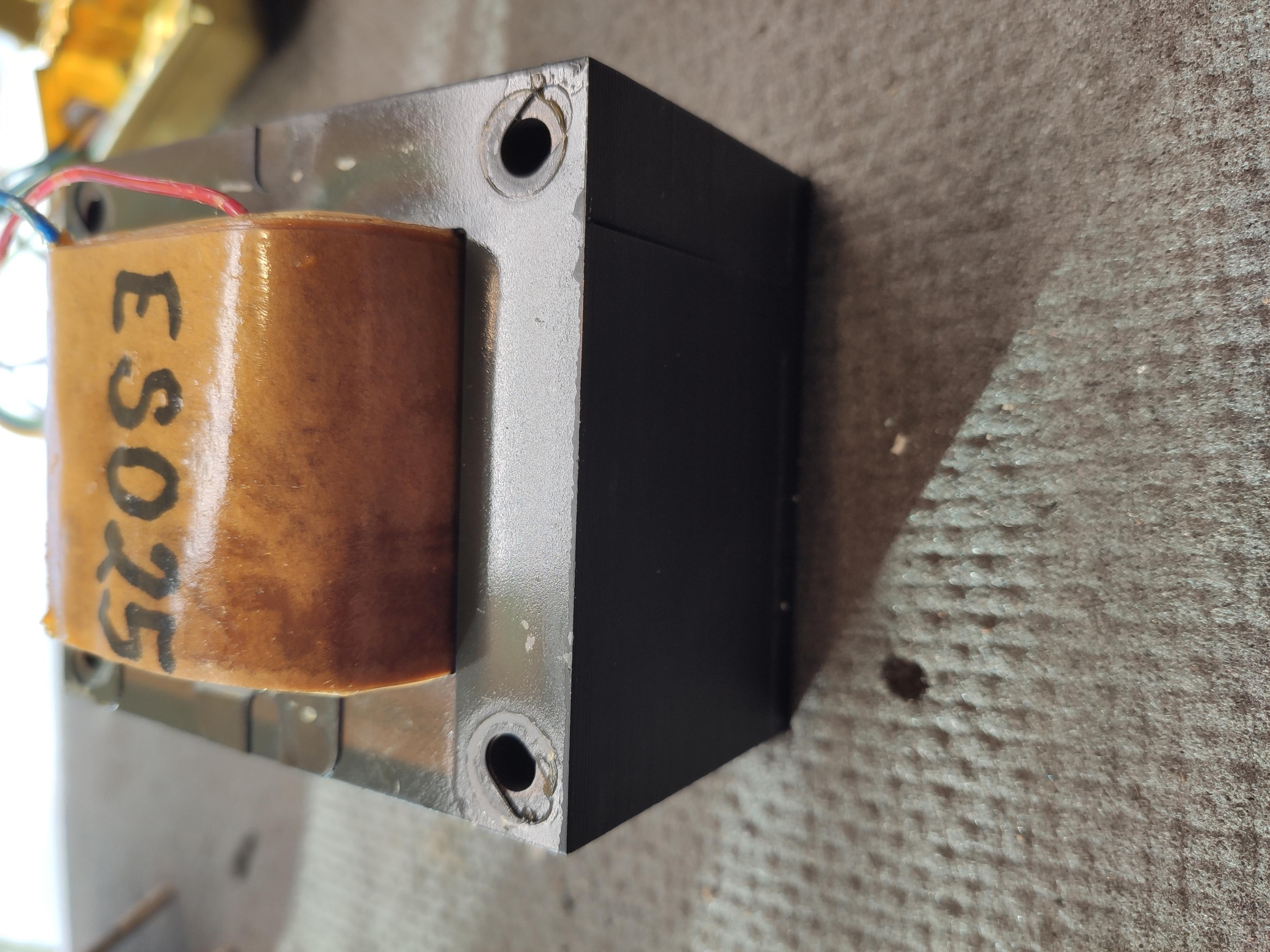

Magnequest messaged me personally that he retired. In the rare case someone wanted to replicate my preamp, what OPT would you folks recommend? Price (please specify unit #).
Considering the performance, gain options, and low maintenance cost I am surprised OPT are not more common in tube line preamps. I can not more highly recommend others building this 5842 OPT preamp with tube OPS.
