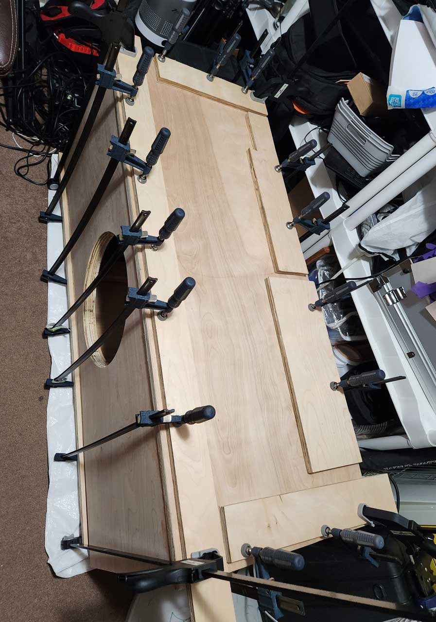

Hi all,

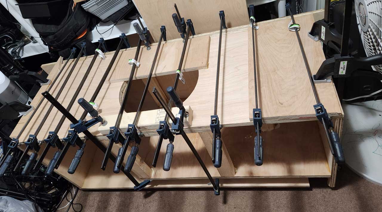

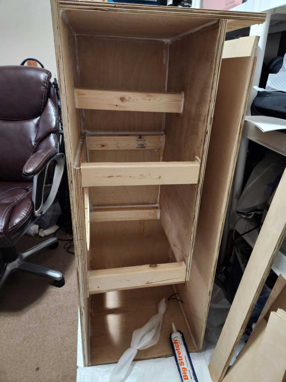

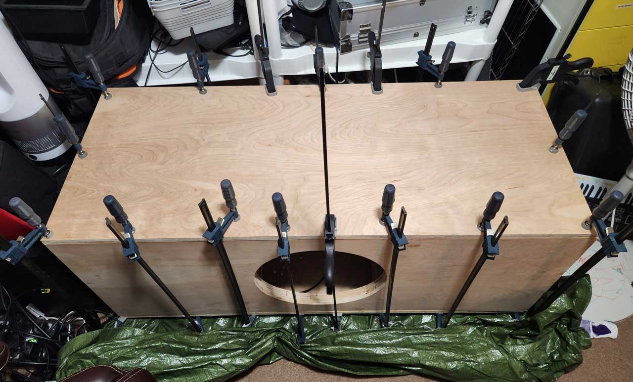

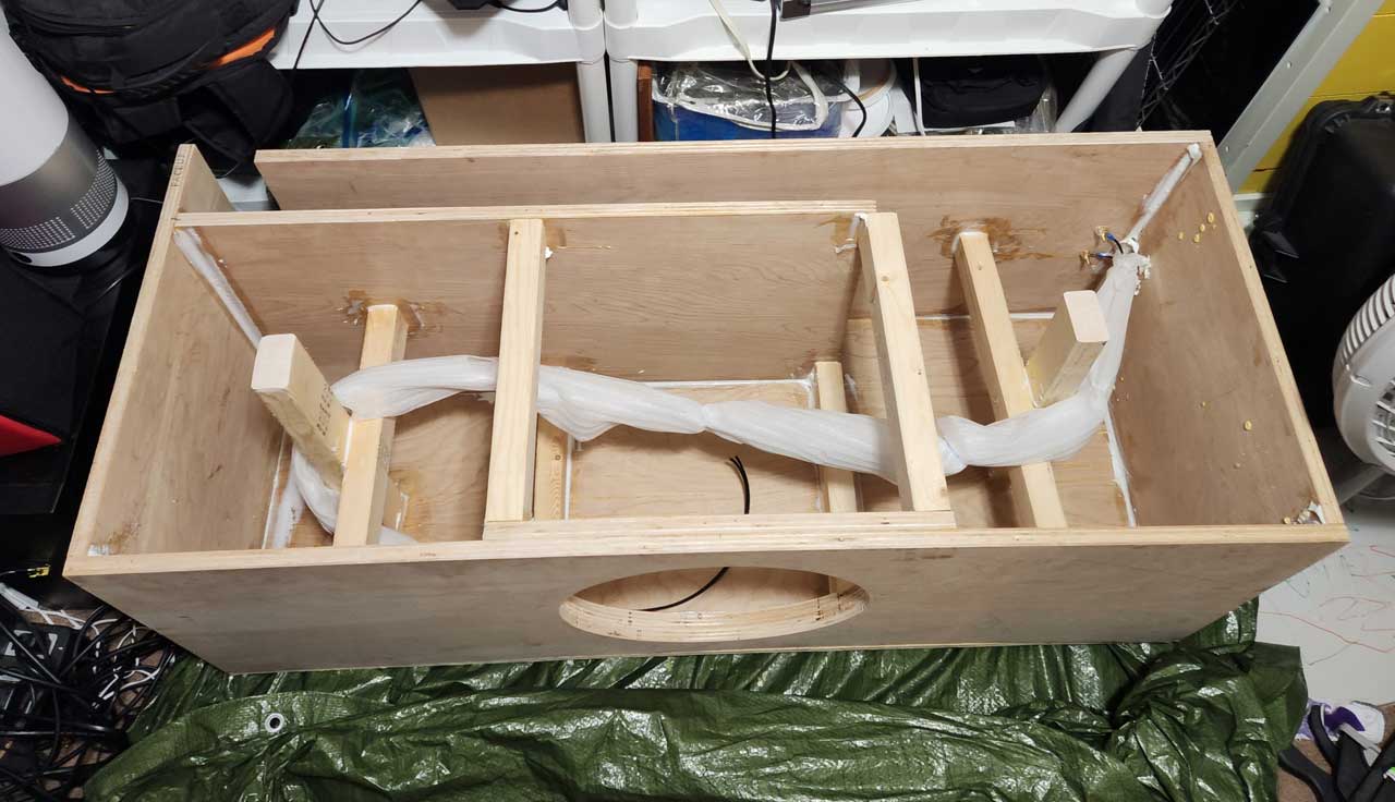

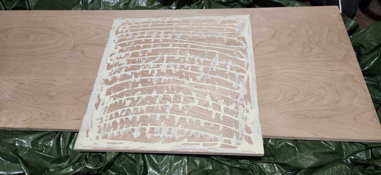

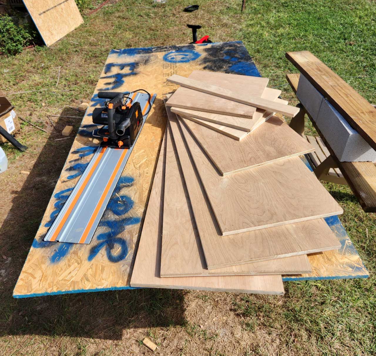

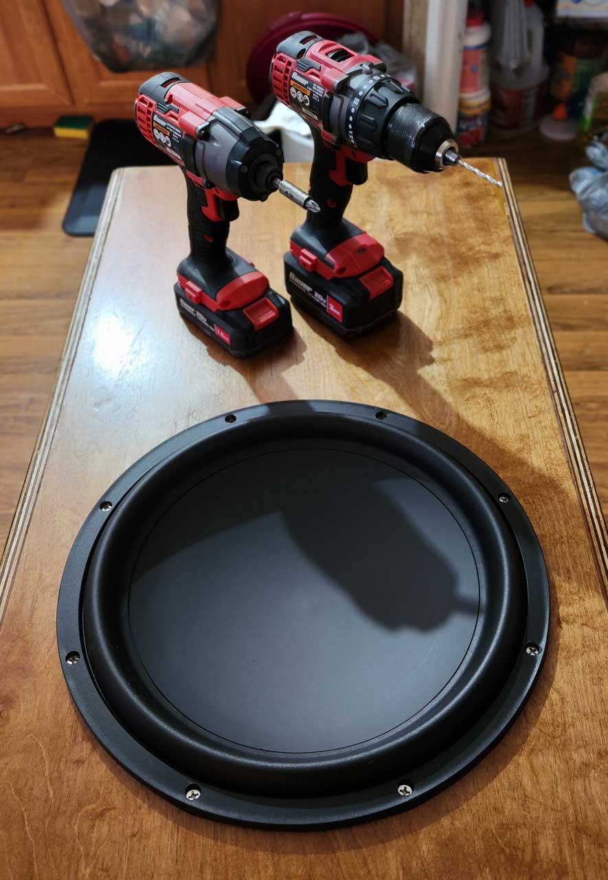

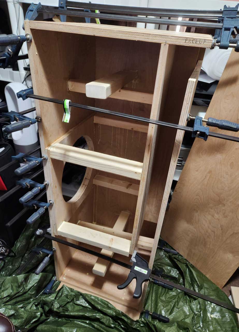

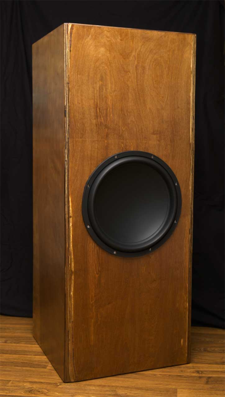

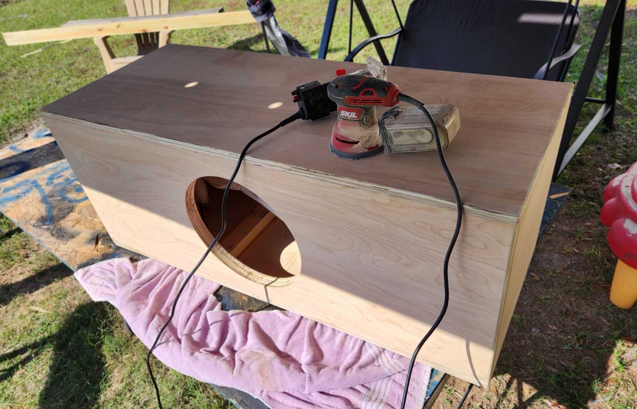

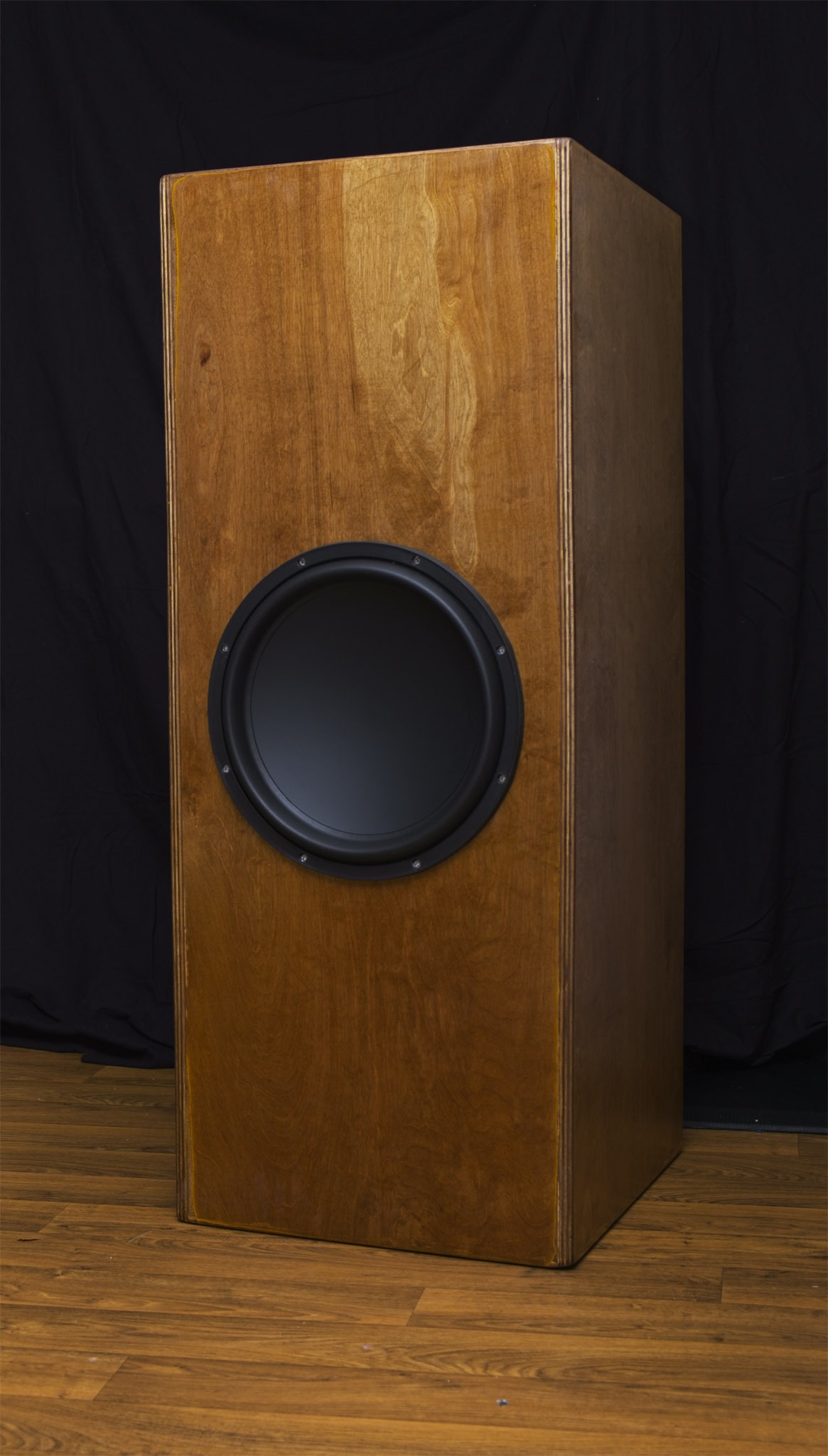

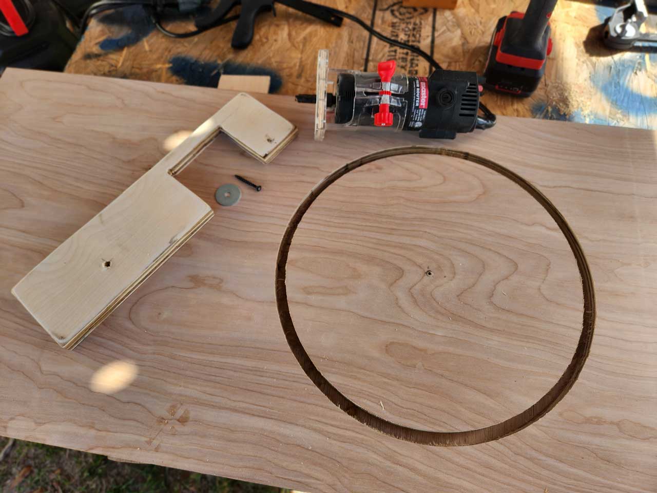

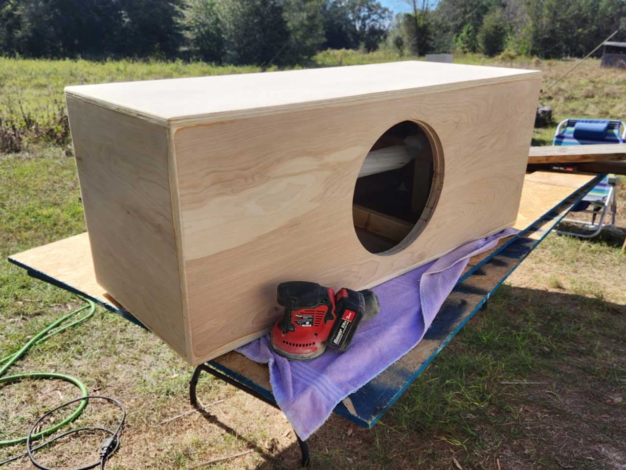

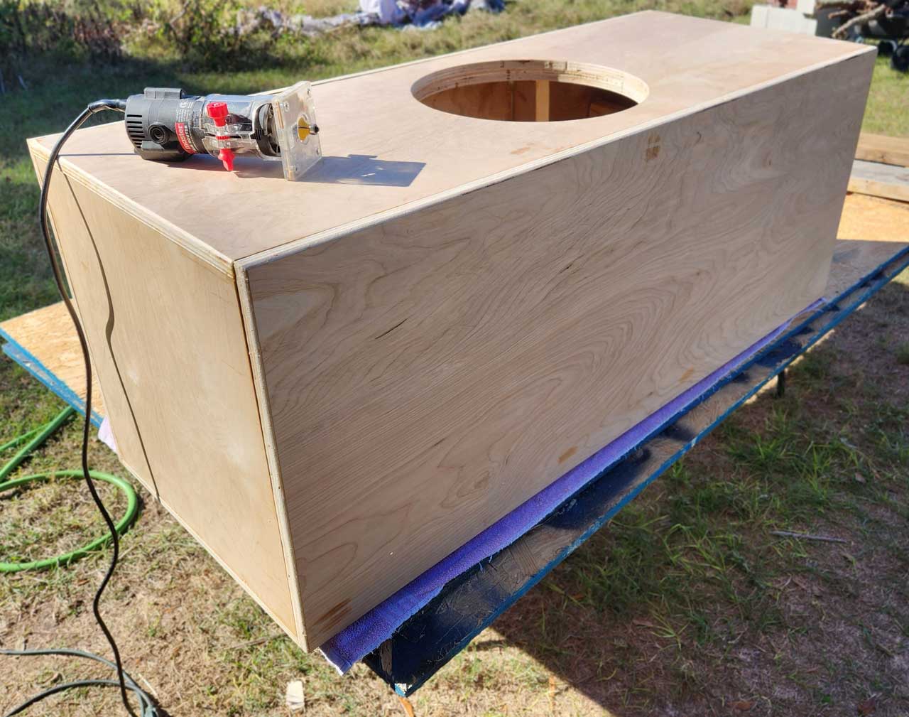

I completed my latest project, a high value inexpensive build based on the Dayton MX15-22 drivers that were on sale a while back for a pretty deep discount from PartsExpress. Pretty decent driver for the cost when on sale. These towers are 50 inches tall by 20 inches by 20 inches. The slot port is at the top and exits behind it with a 3" x 18.75" opening and a total length of 34.6 inches. I modeled them in larger cabinets in WinISD and then built a physical model with scrap to verify my calculations for my port and my final cabinets show the 20hz tuning pretty precisely so I'm happy with how it all worked out. The front is double baffled and I used 1.5x2.5 stud for bracing. Each driver is powered by a single Behringer NX3000 that I got on deep sale (50% off) in bridged mode and they're handled by a miniDSP 2x4 HD. The cabinets are made with 3/4th inch ply that already had Birch veneer on them that I found at Lowes for an ok price and I stained them with Early American minwax and sealed with a satin poly.
50" x 20" x 20" Cabinets
Bass Reflex, 20hz Port Tuning Frequency
Net Internal Volume 8.2 cubic feet
Dayton MX15-22 Drivers (wired in series; 4ohm)
Behringer NX3000 Amplifier (Bridged; each)
MiniDSP HD 2x4

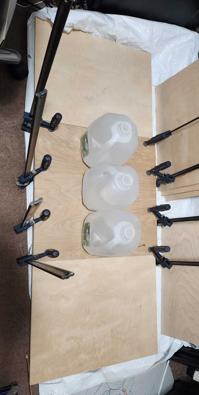

I’m stealing the milk jug clamp idea👍🏼

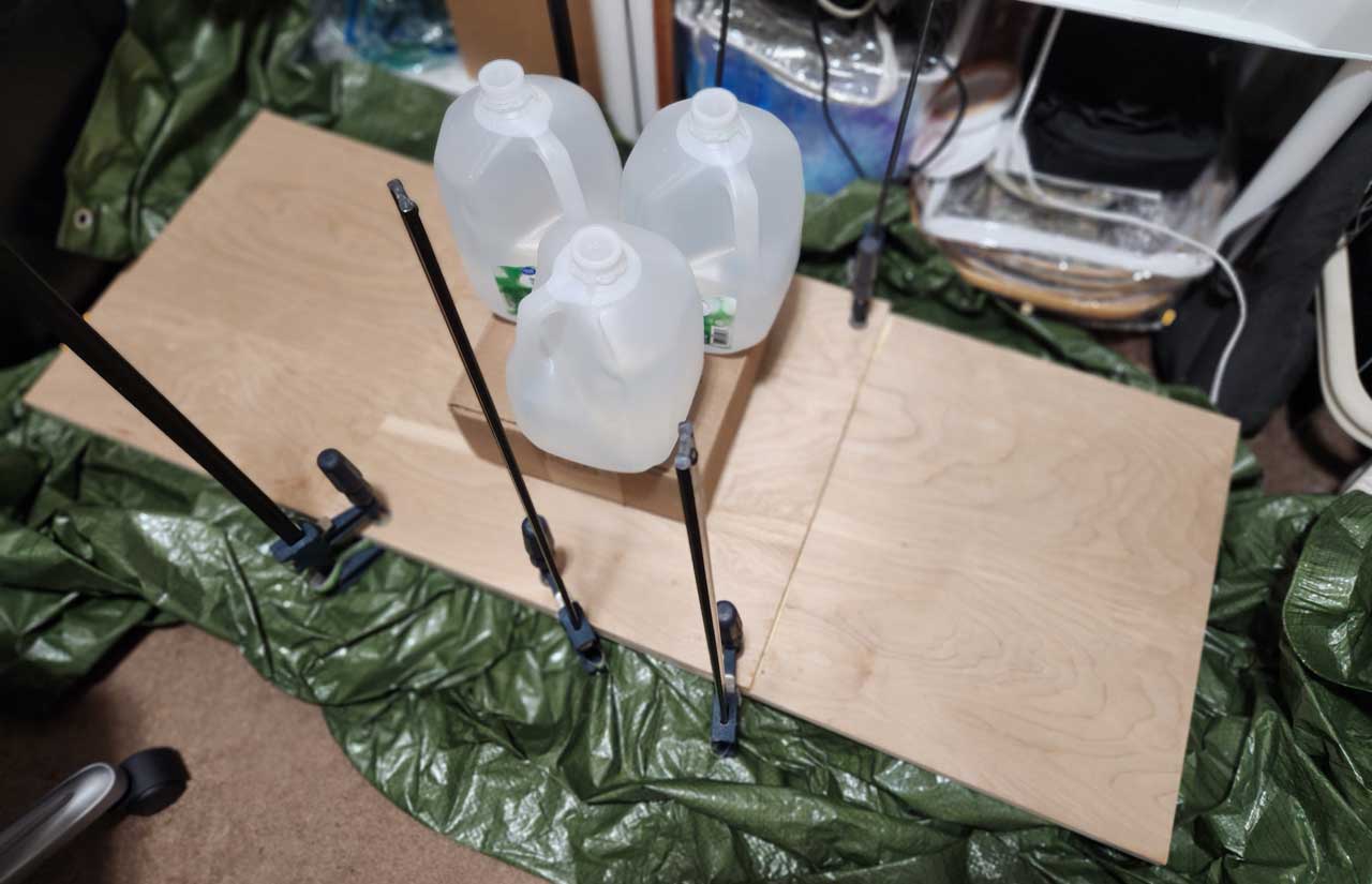

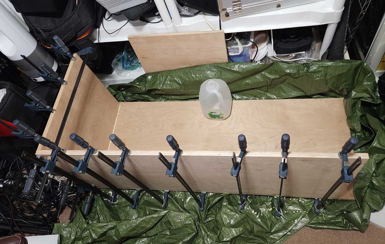

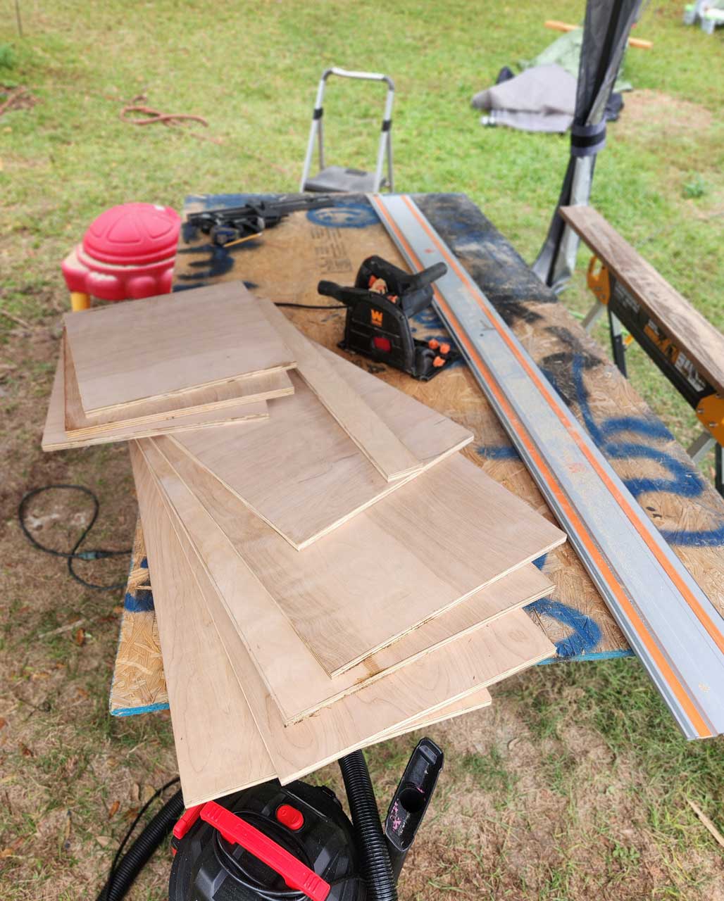

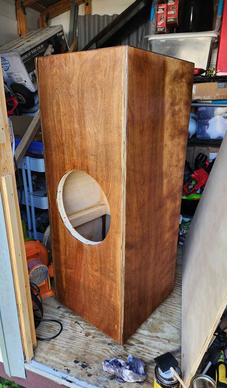

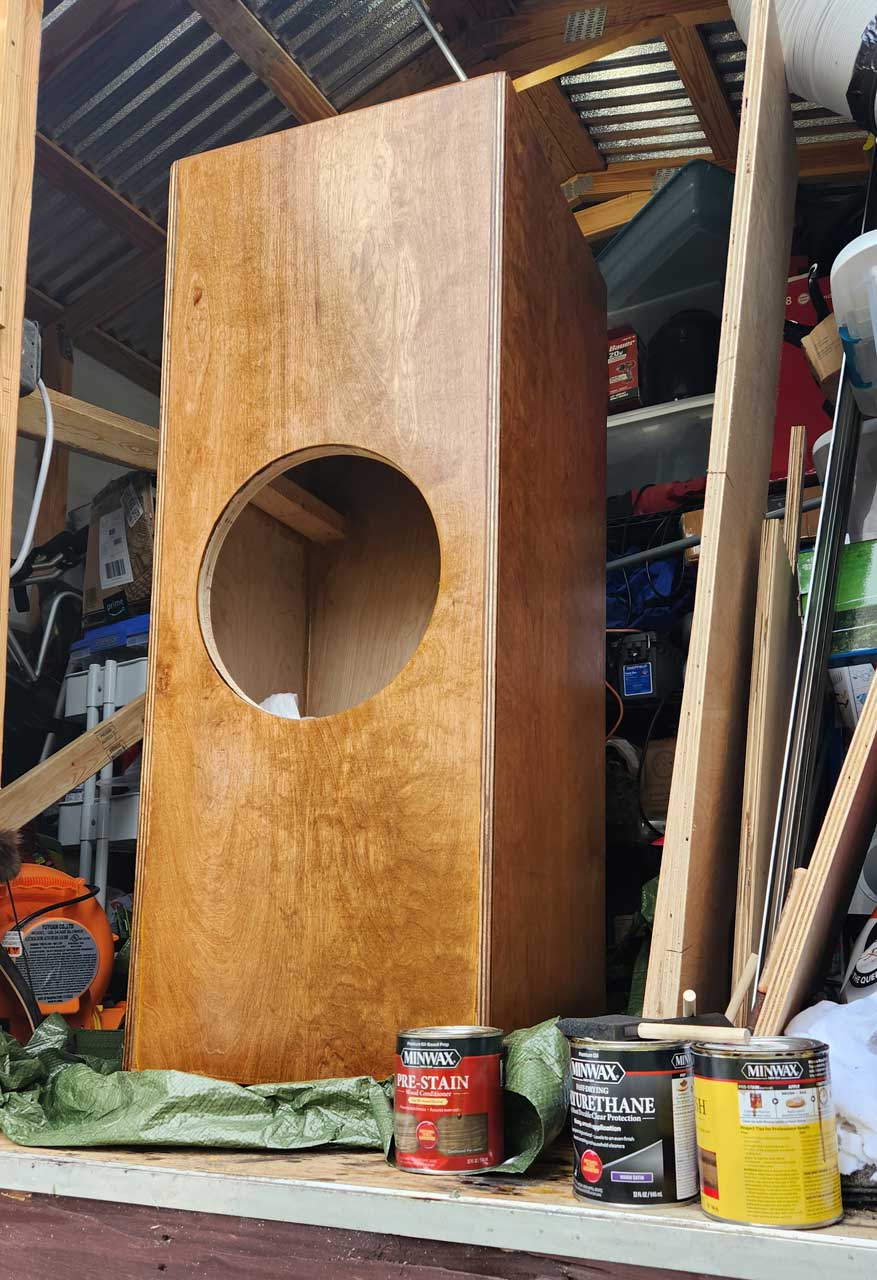

Haha, I had to. The humidity in Florida is unreal and it's been storming all November and quite a bit into December. So most of my building I have done inside on a tarp and used weights in the form of water jugs and lots of cheap clamps (Harbor Freight, $6~7 a piece). I did the staining outside in my shed to avoid the smell.
Each tower was under $600 USD (that's cabinet materials, it's own amplifier, wiring and terminals, driver, etc).
Looking back, I wish I would have thought about doing 48 inches x 21 inches x 21 inches instead, to save on extra cutting. Sigh, dunno why I was so hung up on 50" when 48" would have been so much simpler to cut.

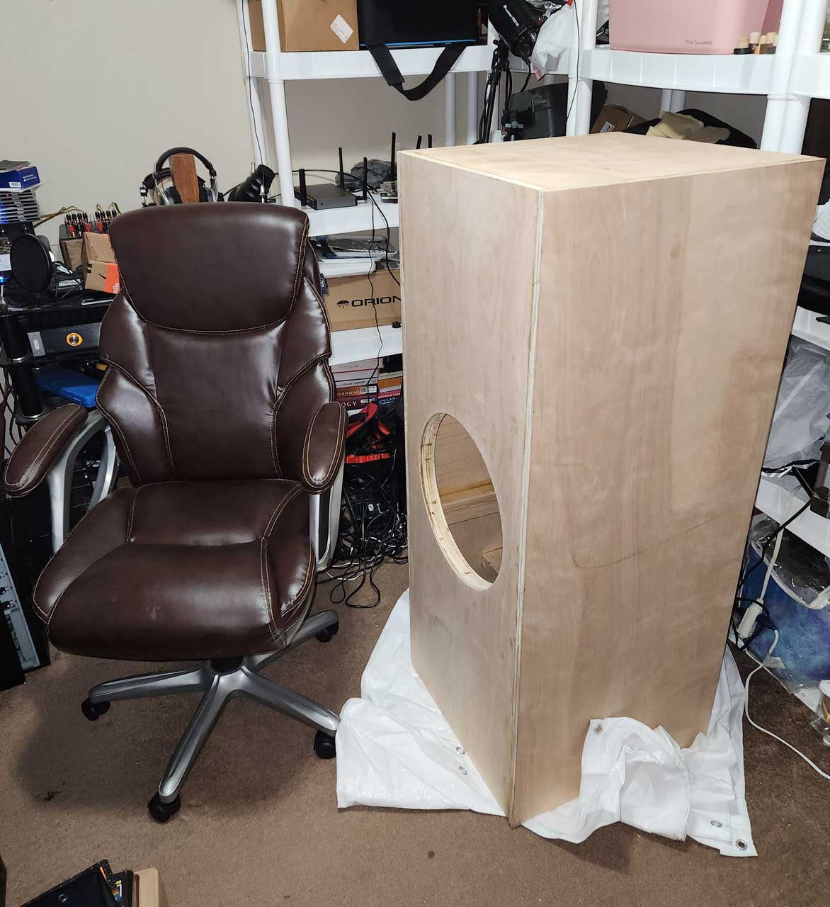

20 by 20 inch sides?
Perhaps I'm too Old School in my beliefs, but it seems to me that manufacturers have always held to a strict principle of not having two identical cabinet sides due to resonance/reflections that could result.

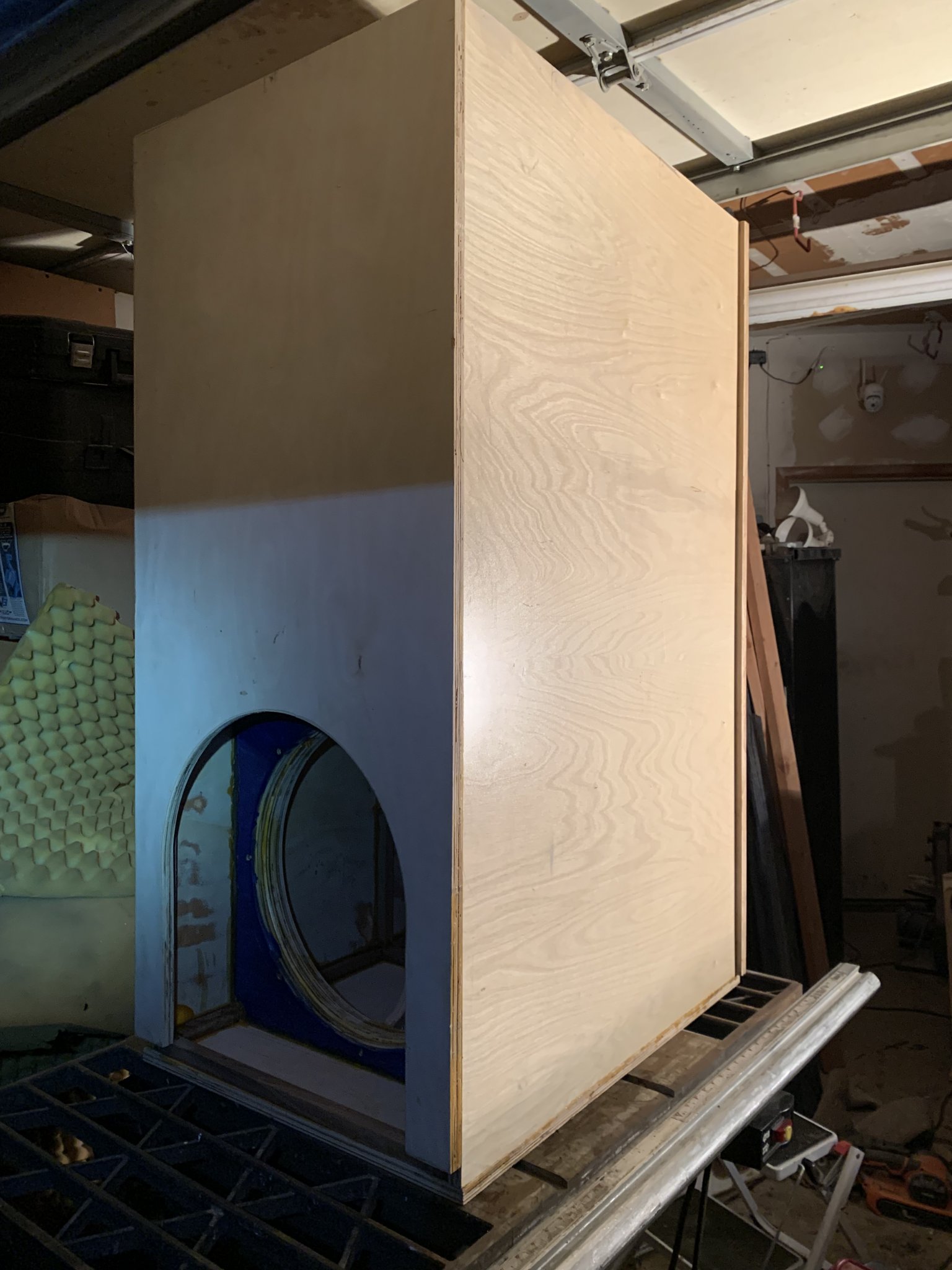

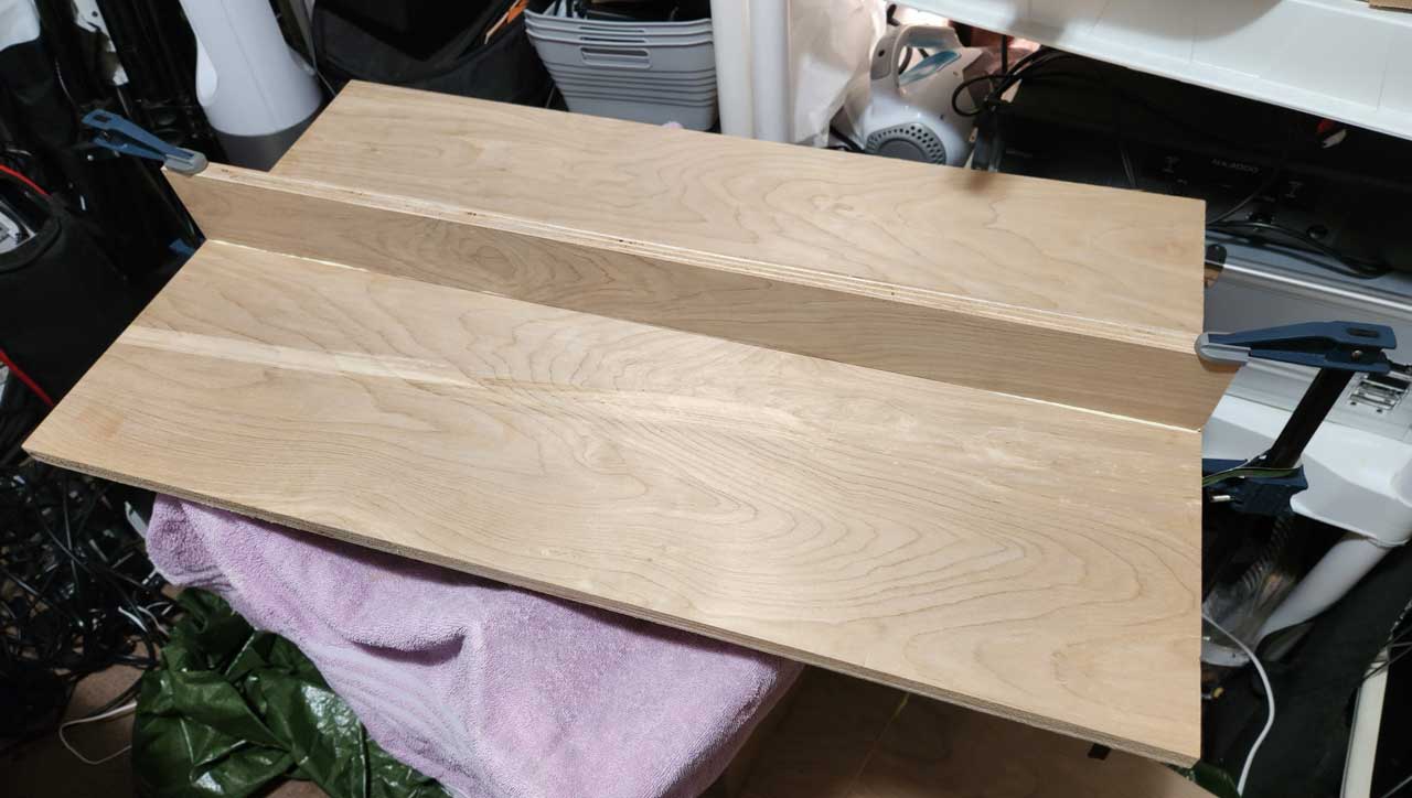

Yes, 20" x 20" give or take a few mm. Those resonances you speak of would manifest without bracing. But with bracing, they're not there in an appreciable way. 64% of the two walls are also part of a large long port. The front wall has two baffles and a cage bracing of studs. Each wall is stud braced every 8~10 inches on all 4 sides. The inside of the port is fully braced down the center. 8~10 inch total distance from one brace or corner joint to another in the entire cabinet.

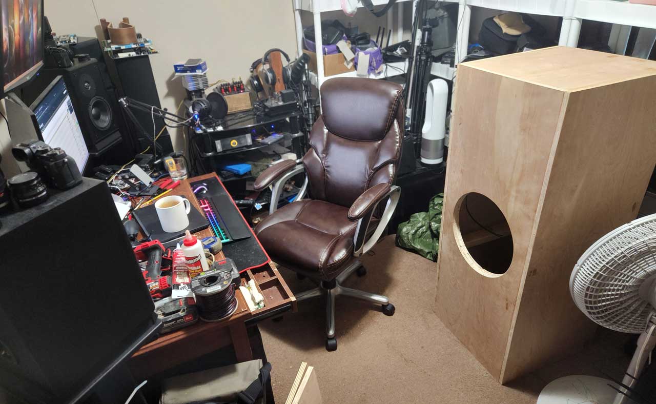

My back hertz! Hows yours? 😝 Same size almost exactly
Youch, that looks heavy!
With the driver installed, I don't want to ever lift it, but will move it with a dolly/hand-truck. The cabinet itself without the driver, I can pick it up and carry it, but I won't want to do that in 20 more years.

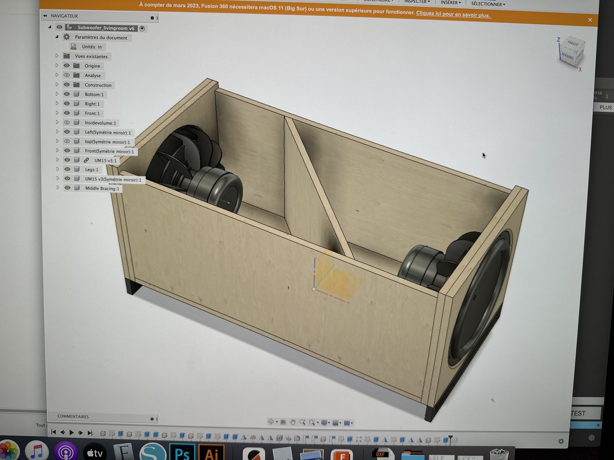

It’s a table subwoofer. Going for dual opposed driver, ~2.5ft^3 sealed box. Illustrated with um15 in the screenshot, but cost of the um15 is a bit high for buying 2.
