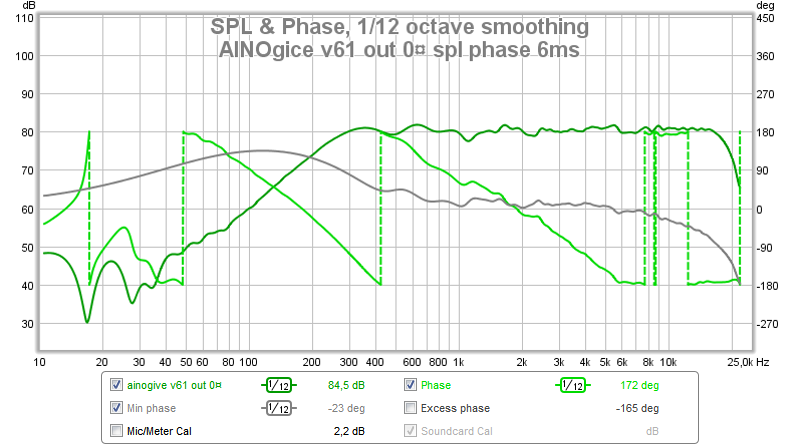

My MT vs MMT vs MTM parameters
Mids Peerless/Vifa NE95 flange diameter 95mm
Twwet Fountek NeoCD3.5H flange height cut to 95mm, width 98mm

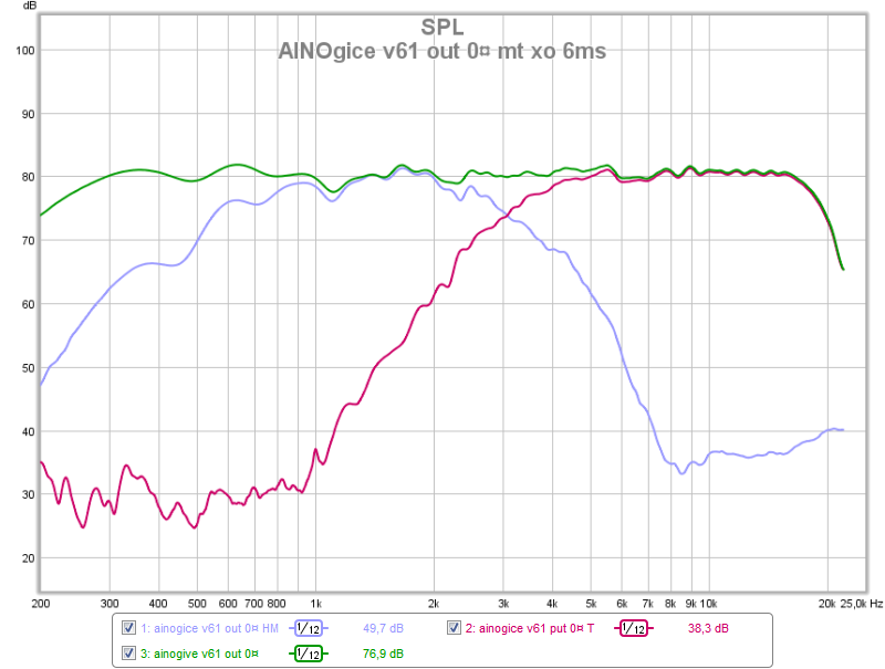

Measured m to t xo responses and phase of the system (when playing mtm), outdoors at 150cm distance mic at tweeter level.

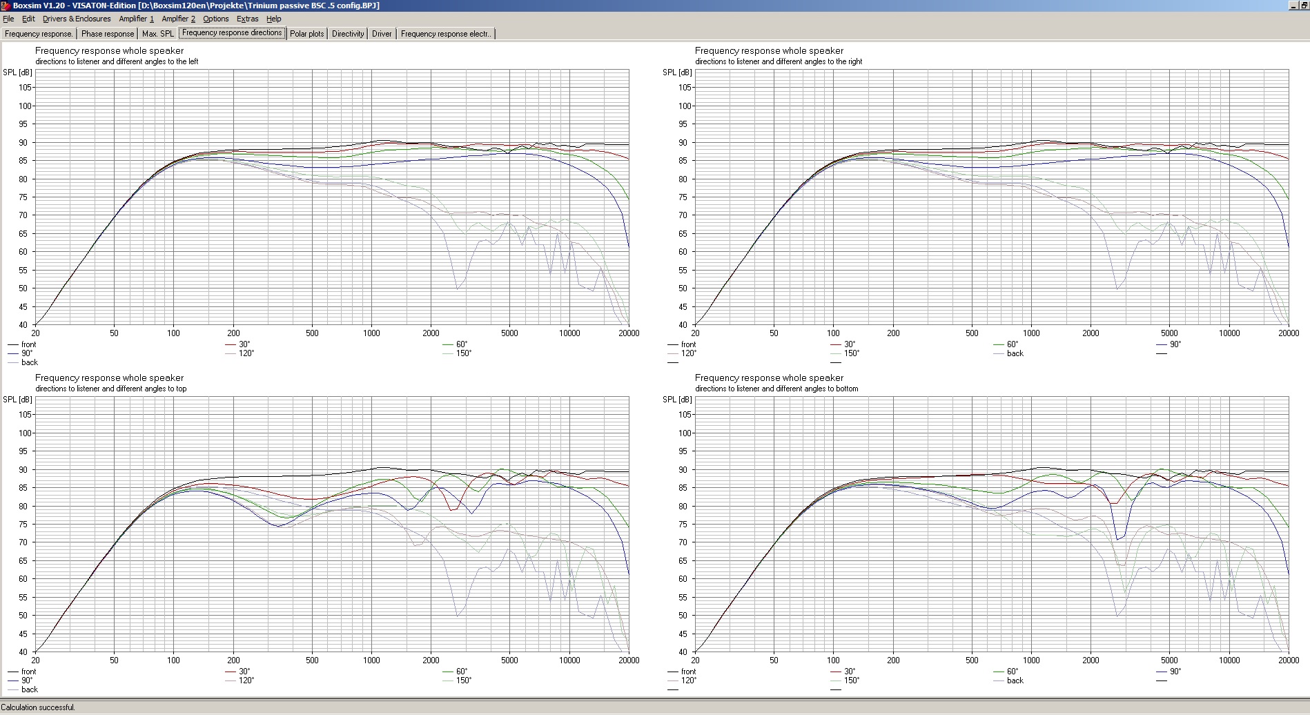

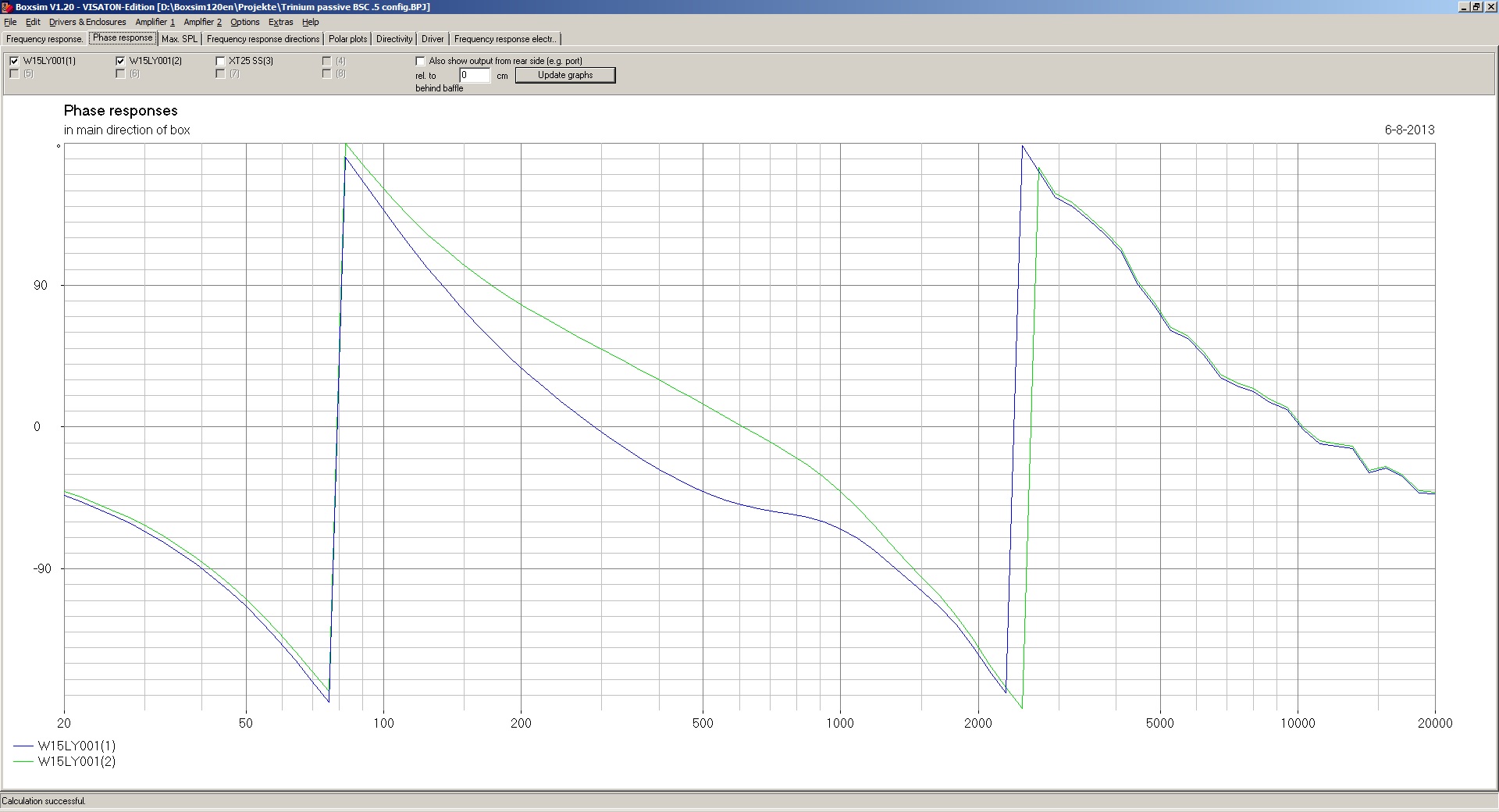

You could use 1 of the mids as a ".5" driver (BSC). That should help with lobing / comb filter effects. I am looking into this to improve my MTM (http://www.diyaudio.com/forums/multi-way/207159-trinium-my-latest-build.html), which has a hugh MTM spacing because of the NeoCD2.0 tweeter used.

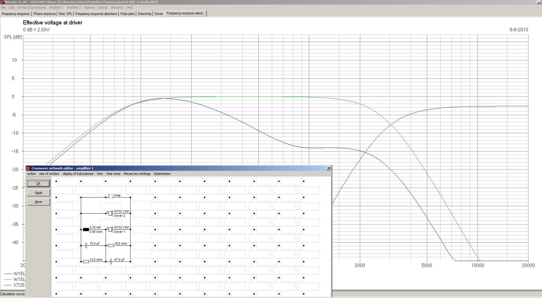

After alot of sims in Boxsim I think I like a notch + lowpass (effectively forming a shelving filter with a second order rolloff) best for this application, at least in my case. I attached a snapshot of the directivity of this config, in the Trinium thread there is a sim of the "old" config. Should give you an idea of the effect.
Mark, sorry I am using all channels in my minidsp - but perhaps i can do a passive filter for the other M?

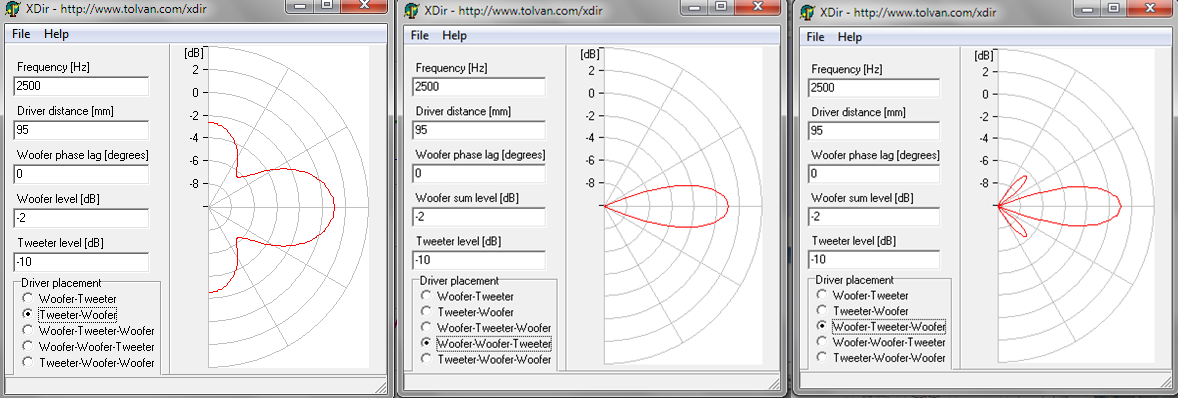

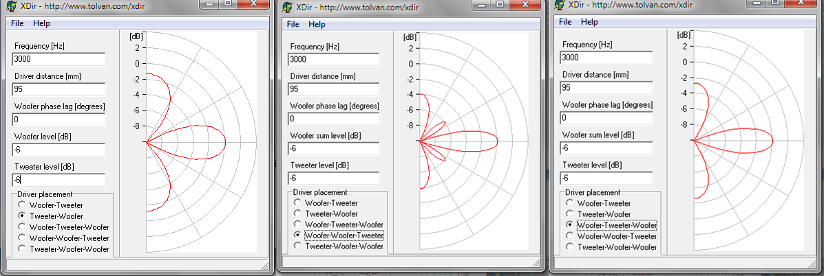

But here are Xdir simulations of the system above. I use phase difference=0

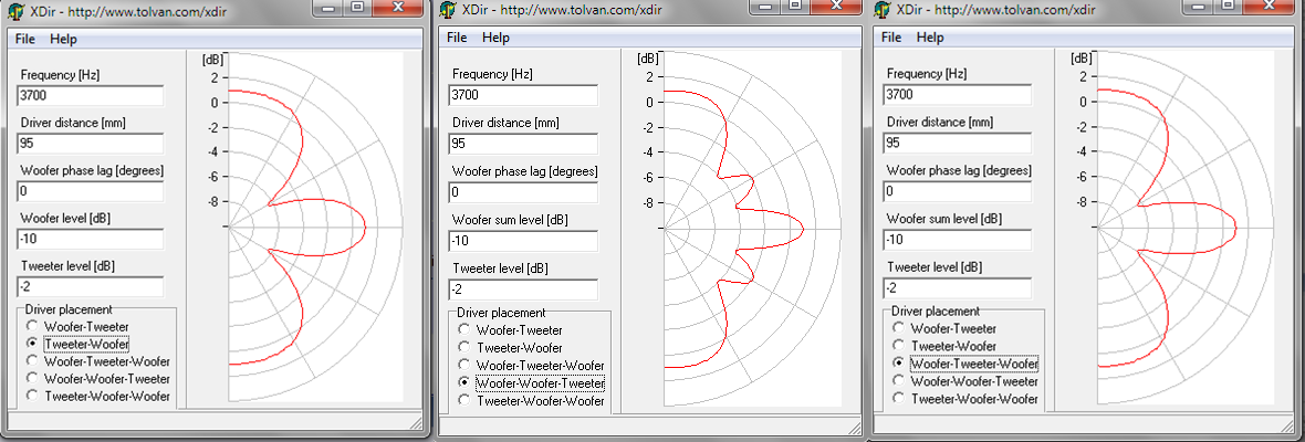

Xo is unchanged but we look at simulation at xo point 3000Hz (both -6dB (LR4) and at 2500Hz when T = -10dB and at 3700Hz when M = -10dB
Analysis, please!
Analysis, please!
Hi Juhazi,
That looks like a narrow dispersion pattern, don't know if that's your goal? You can try simming your design in Boxsim like I did (Downloads). Should give you a better idea of the response. I also have "only" 2 channels of DSP / speaker available so I am designing a passive filter for the .5 config. Not that hard to do if you use Boxsim. I attached a sim of the filter to show the idea.

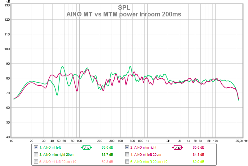

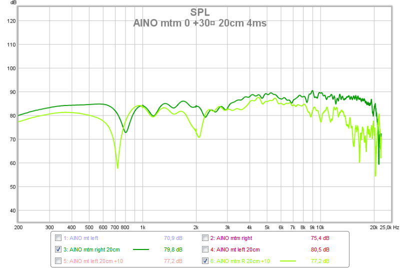

I have done also inroom measurements (quick and dirty) of MT vs MTM using the left speaker as MT and right as MTM. Position is similar as it can be in a living room but mic position is not exactly equal - so pay attention to major outlines only!
Farfield (power response) 200cm 200ms and nearfield 20cm 4ms (30¤ angle upwards but poor summation because of small distance).

In this measuremnt the MTM looks slightly better, what's the angle of the off axis measurement?
Edit: just noticed 30 degrees, duh...
Those dips are pretty deep -10dB on axis, could be the room interfering with measurement? If so, not much can be learned from these measurements.
This subject is really troblesome...
I analyze data and simulations above like this:
- There is not a significant difference in simulations at this configuration and xo 3000Hz
- power response in the range of Ms of a MTM is hotter than MT's (on axis is same, not shown here)
- my nearfield measurement are reliable but not valid - too close --> do outdoors at 100cm distance
A measurement doesn't always measure the phenomenon in question (poor validity). How to get valid data about this (the ill lobing)? Listening tests are problematic too, unless there is a really big difference. I can't hear a difference between these in a room. In my project I was aiming at high directivity both horizontally and vertically to minimize early reflections. On-axis and power response relation shows that this is achieved, also imaging in stero is better than average 2-way speakers with waveguides. However the question about problematic lobing is not answered.
I will do better outdoor measurements some day with a friend - perhaps next weekend. I must make some kind of guide/ruler for angles.

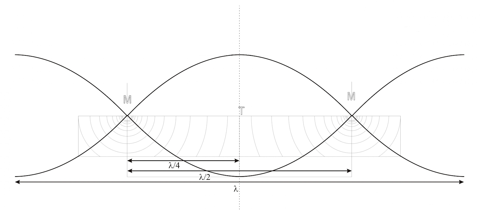

Now if the drivers are too far apart visualize the same wavelength but two of them separated by a gap created by this excess distance. This physical gap induces phase shift causing your issue in the vertical axis.
In my mtm system m-t center to center distance is 95mm and m to m 190mm
L/2 is 3600Hz and L/4 is 1800Hz. My tweeeter can't go with 1,8kHz xo. I will simulate and measure it after setting xo to 3600Hz (now it's 3000) There is no way to make m-t shorter any more, so mt should be better but they have always some lobing too.
Vertical lobing is not so bad as horizontal. If I can't eliminate lobing, I want to minimize it. By simulations mmt is not a the way to go with my dimensions and xo.xo
.5 config creates phase difference below xo and I don't want that at these frequencies. I must study the hint that Pallas gives.
