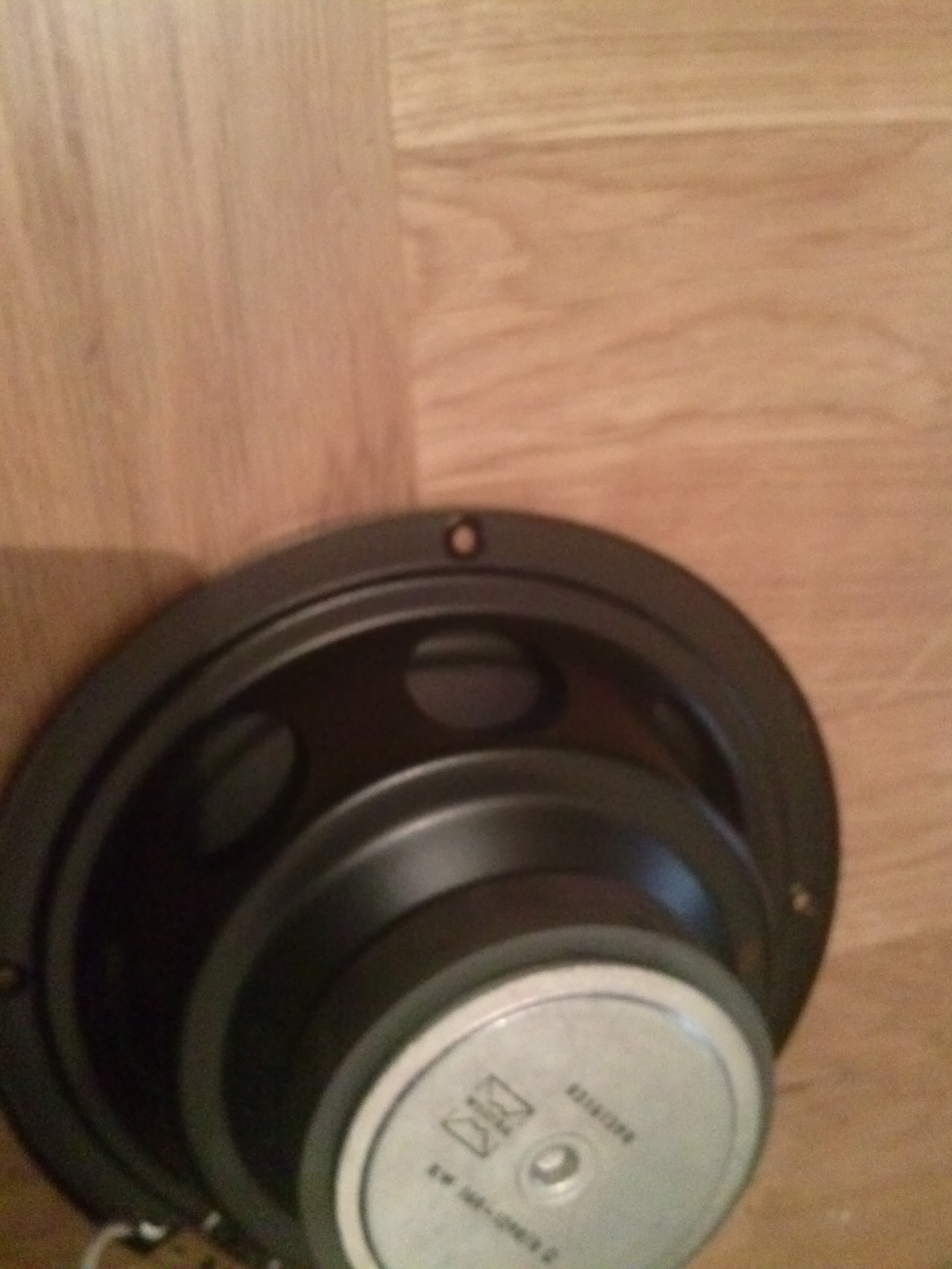

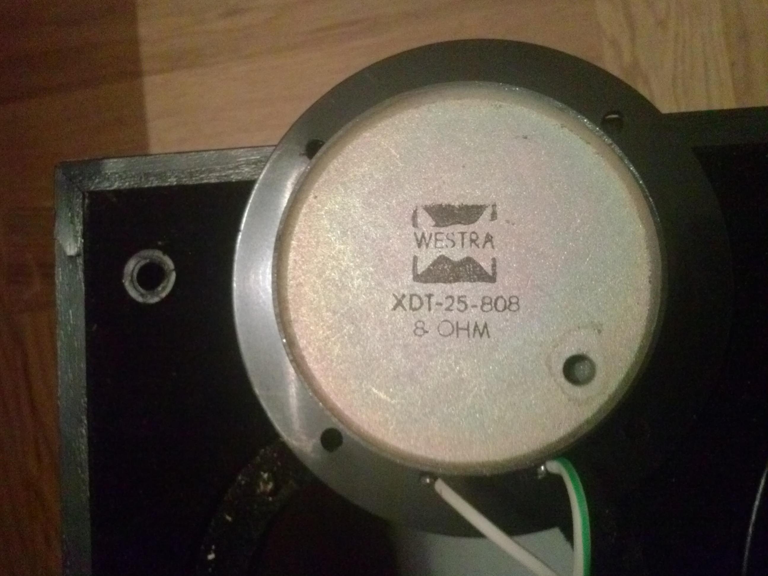

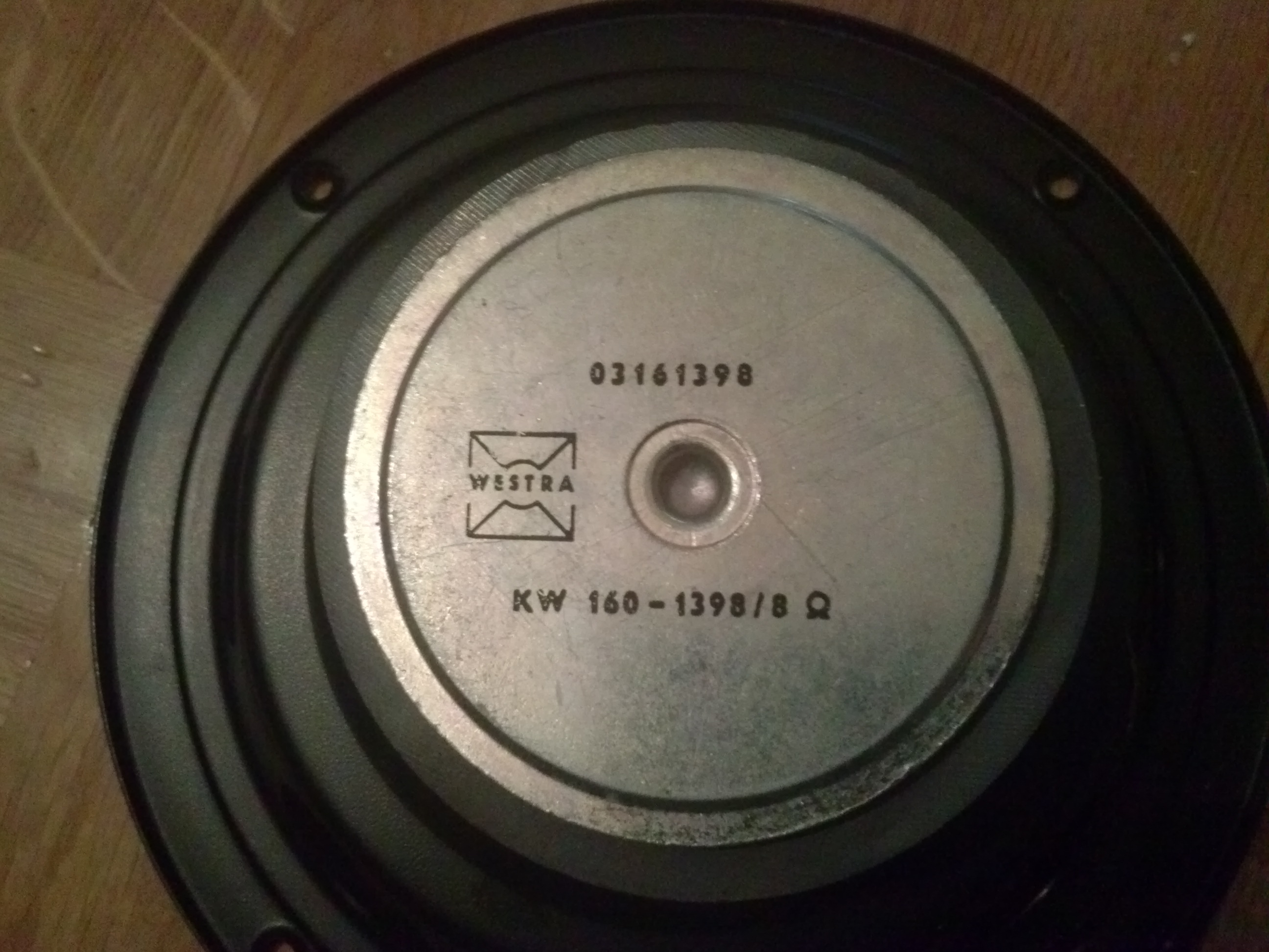

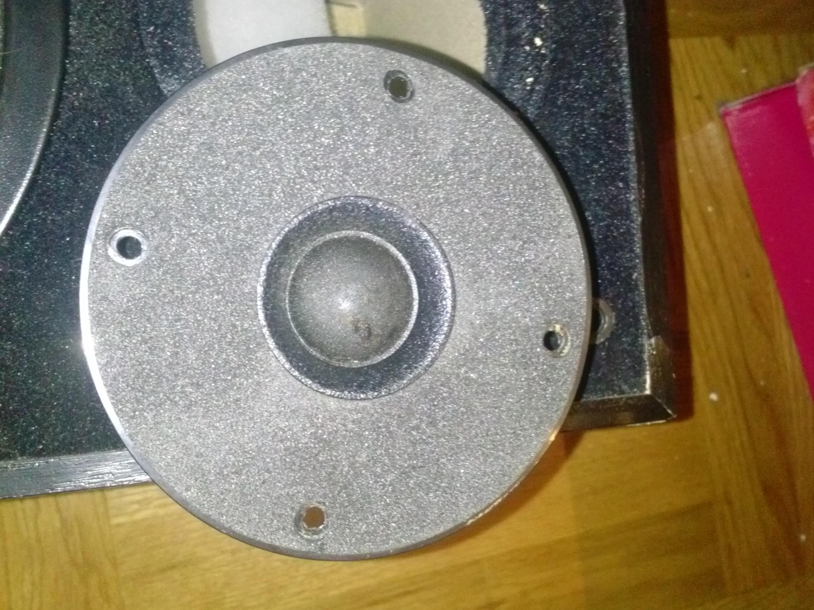

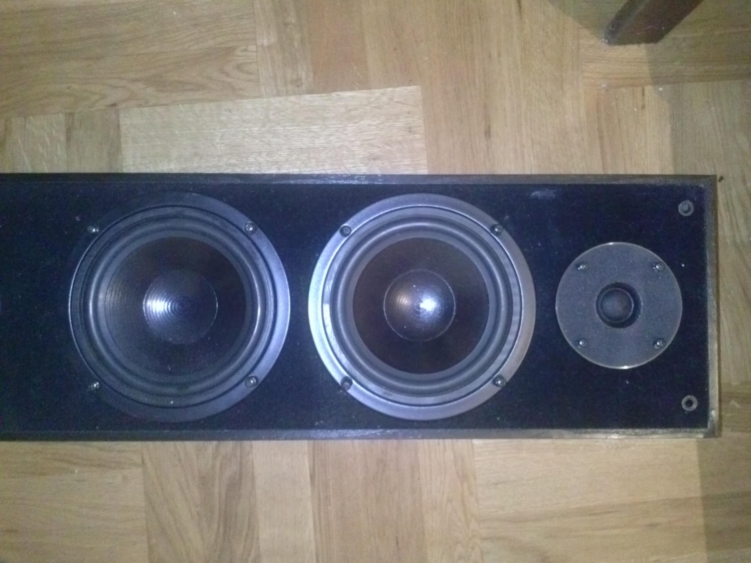

At first i would use them with woofers from I.Q LK3 boxes (bought them with blown twetters-all WESTRA drivers(woofer KW 160-1398/8Ohm, and twetter XDT-25-808/8Ohm ), and later i plan to get something better(better woofers, and a sub)..... and go into some hardcore DIY speakers waters 😀

I know it`s a compression driver ;-)
Those woofers whould be just temporary solution 🙂 and i plan to add neodium magnets on those toys(more sensitivity, stronger motor, experimentacion, learning a bit, and having fun with it ) , and later on i whould get some real drivers to match the twetter.
My plan for begining is to L-PAD the beyma-s, and as i said to add/double the magnets on woofers, for a while, and then do something more serious.
