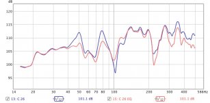

I mention this now and then, but here's the data.
When re-decorating our music room, I placed a sub (AR-1 about 1956) in a dozen (or so) locations. These were mostly against the far wall but also adjacent along the sides a bit. The mic location was stationary where my chair would be towards the middle of the room.
The dB scale is not calibrated.

Some run the sub below 40Hz. Looking at your responses, below 40Hz is similar.
How high do you use it?
Can't make sense of your first sentence.
I don't use the AR-1 in my every day system. Being a small box, it was useful for these tests.
For about 50 years and several crossovers, I've used about 135 Hz, 24dB/8ave, electrostatics mostly. And all kinds of subs. With cone mids, a bit lower would make sense.
If I look at your responses, they are similar below 40Hz, that means not a location dependent. Good enough explanation of my first sentence?
Got it.
It is fair to say speaker location influence (within my set of test locations, room, absence of furnishings except for wall to wall carpet with underlayer, and using a "bookshelf" woofer on the floor) is substantial for every freq below 500 Hz but not much below 40.
B.
So, measurements follow theory and experience well. We see room mode dips and peaks below 100Hz, and some variation in amplitude of those because of different location of sound source. Above 150Hz variations are wider spread, Schröder effect weakening. Below lowest mode response is almost constant (one measurement being exception - why?)
Listener/mic location has much more influence on the response in modal range below Schröder.
