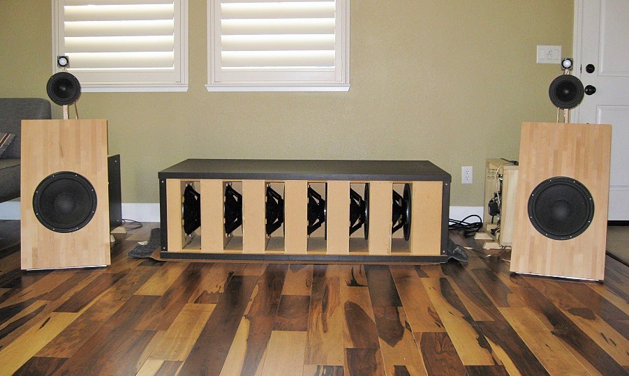

Yeah, what you get for your $20 pretty amazing! It's (of course) a stamped frame driver, and the packaging is quite lean. A couple of mine arrived with minor dents in the lip of the frame where you mount the driver. Luckily these straightened right out when I screwed the drivers down. But seeing how the TS parameters were all very close to spec I am very happy with these. Not sure if the MFG Xmax value is really accurate, since I could not test it. The suspension quickly stiffens as the cone moves away from the rest position and there is definitely NOT any extra excursion capability. I am even questioning whether the Xmax is really a peak-to-peak number.
I'm not including any kind of room response corrections in the EQ. It's just what is needed to flatten out the free-field response model prediction. The classic dipole correction is a 6dB/oct boost below the first dipole peak...
Since I am planning to cross over to the main speakers around 80-100Hz the stuff going on between 100Hz and 250Hz is not all that important. I would not want to try to include that in the sub's passband anyway.

Looks good on paper at least. I haven't sat down to calculate the potential output SPL, but I don't think it will be all that high. The dipole arrangement causes quite a lot of SPL loss at lower frequencies. For instance I need to apply about 9dB of electronic boost to flatten the response. One way to think of it is that the 97dB@2.83v sensitivity is reduced to about 88dB. Also, even with 12 drivers the total displacement may not be enough to maintain high SPL at the lowest frequencies. Getting exact numbers for this is not really high on my list right now.

The sub cabinet is five feet wide and will sit directly in between the two satellites, oriented horizontally. Because there are 12 drivers, sound is eminating all along the length of the cabinet. I am doubtful that there will be any integration problems like you would for a single driver sub, especially one not centrally located, e.g. in a corner, etc.
Quick update: since my last posted I have manage to accomplish... exactly nothing, except to drag this monster into my house and place in between the open baffle speakers.... I'm quickly realizing that I may not actually be able to bring this system to Burning Amp after all. It fits in my vehicles, but doesn't leave room for much anything else.
Also, I still have to do a bunch of crossover work, build the amps and computer into the sub cabinet, etc, etc, etc. So even if I wanted to I just might not have enough time. I'll focus on my other project(s) for now and maybe leave this one for next year's show.
In case there was any confusion, a pic of the present setup is attached... For a sense of scale, the dipole subwoofer in the middle is 5 feet wide.

So, is the force-cancelling configuration working well in your application? Very little vibration transmitted into the floor?
Dave.
I haven't hooked it up yet in the horizontal orientation. I did some testing when it was oriented vertically (just after I finished building it), and there was some minor vibration but gravity was not helping. I believe that Siegfried Linkwitz discovered that you just cannot get 100% force cancellation, and I will likely find the same. Hopefully it's close to that, however.
@normanbates: Into each opening to the front or rear there is the front of one driver's cone and the back of the adjacent driver's cone. These are moving in opposite directions, e.g. both moving into the chamber or out of the chamber at the same time.

Just taking into account the wiring and number of drivers, the sensitivity should be 97dB@1m for a 2.83 v input.
I believe that the slot loading will actually reduce the efficiency a bit, although I have tried to keep the open area per driver as high as I could. It's about 0.75*Sd per driver.
