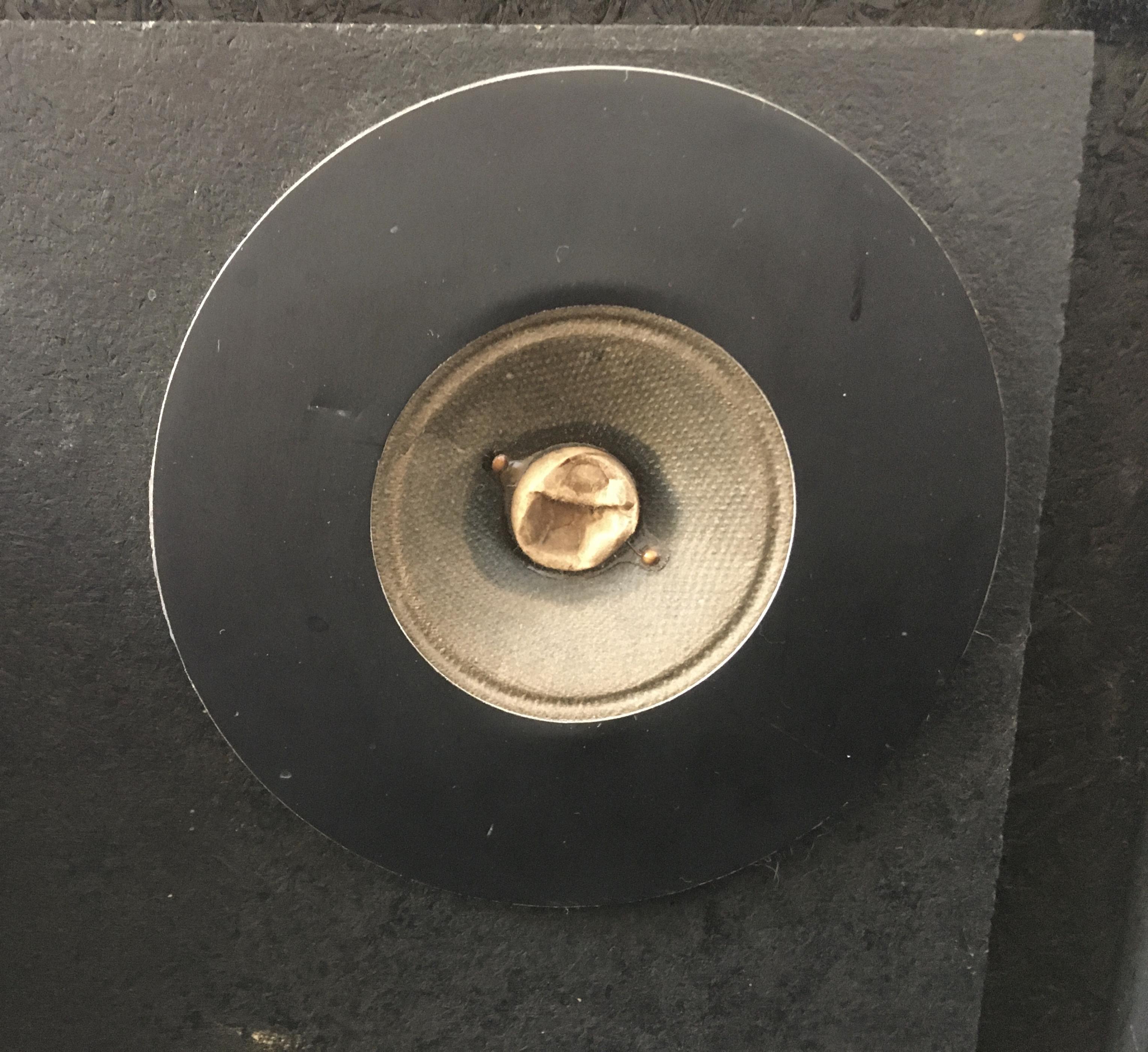

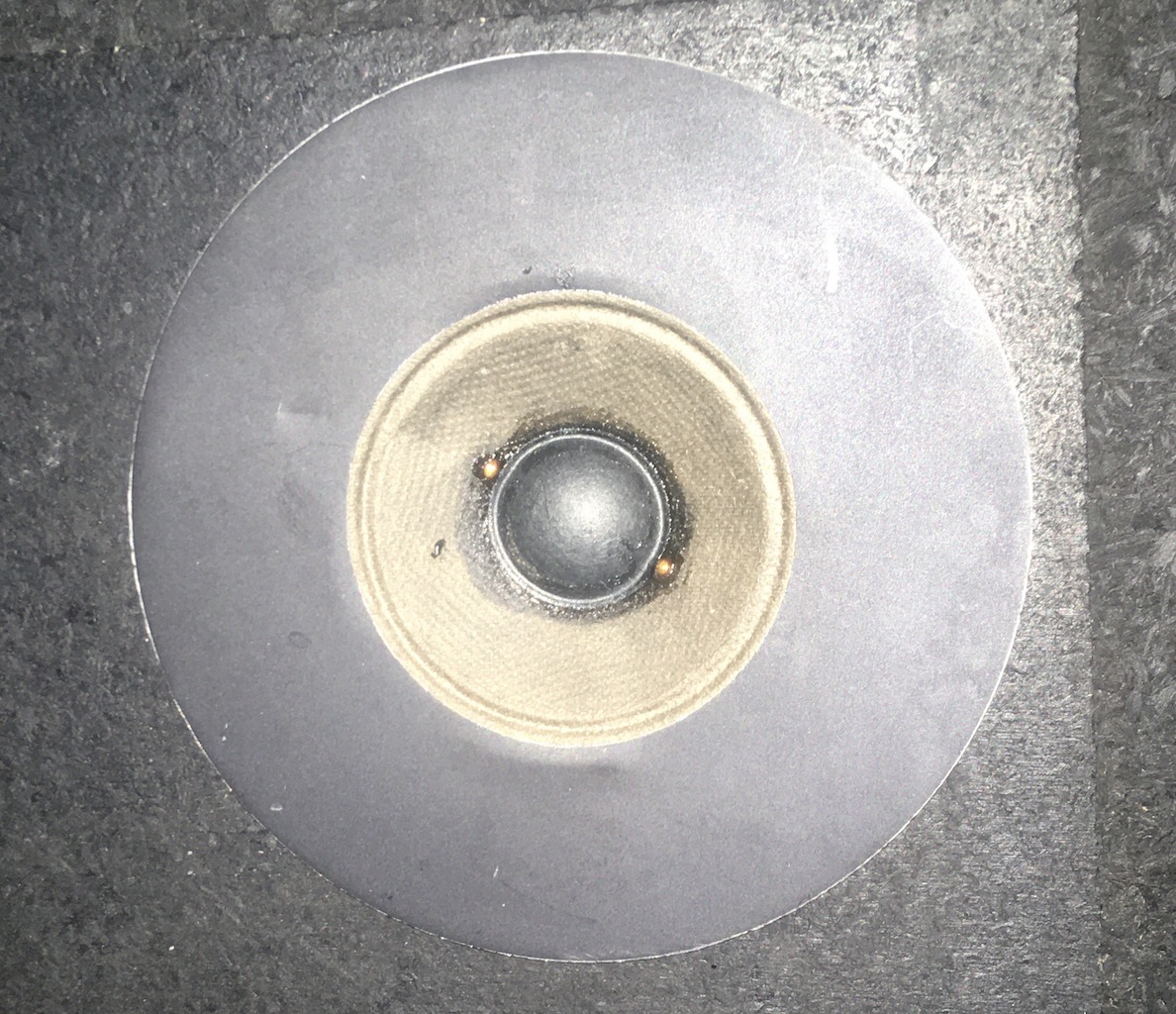

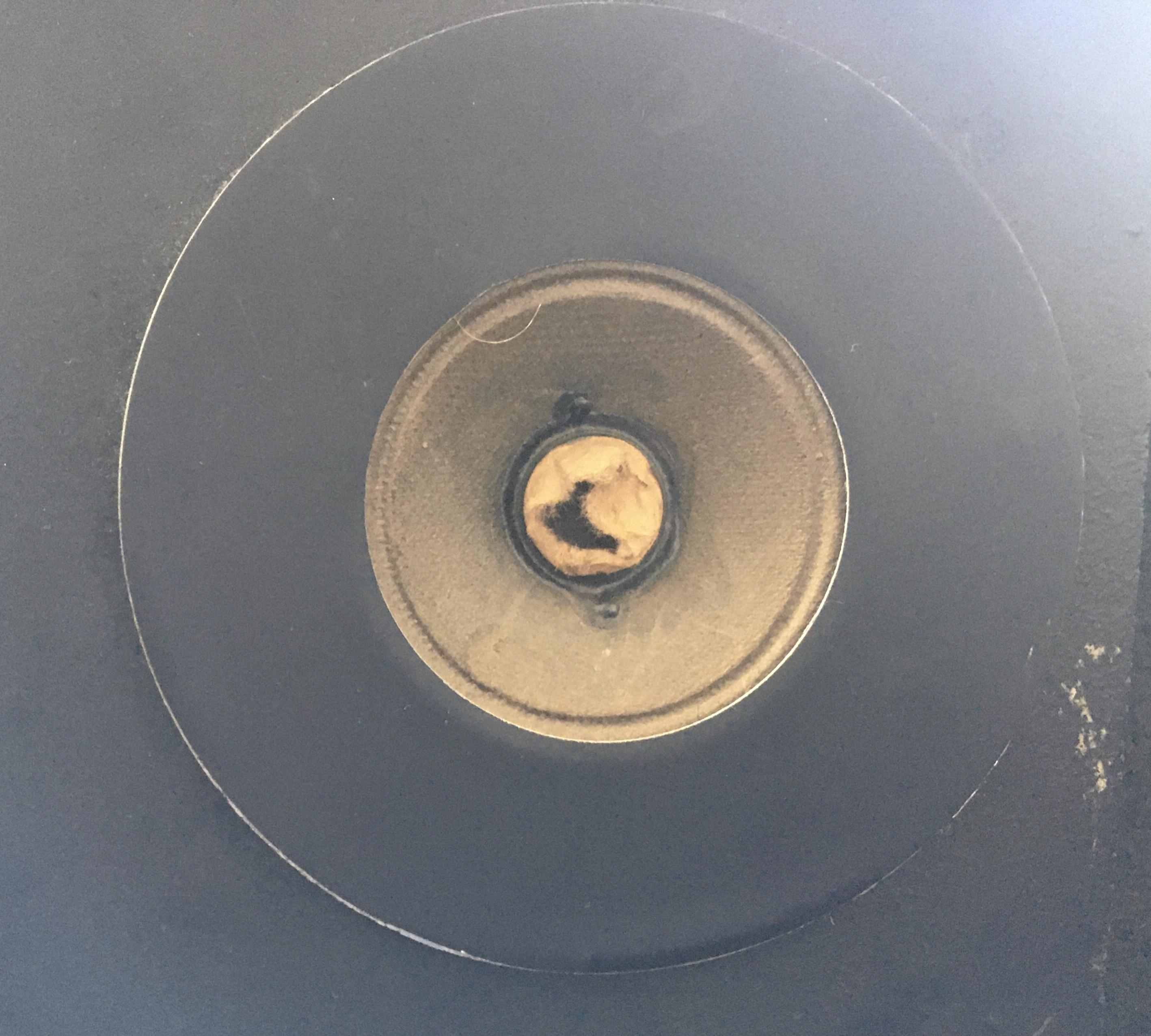

here is the condition of the two tweeters-- pretty bad!

1. It's only the central dust cap that is damaged, the main tweeter cone looks intact. The dust cap could be repaired, perhaps with PVA adhesive and tissue paper.
2. The distortion may be occuring at the resonant frequency of the tweeter cone which is the region of 1.8kHz. This may be because of the simple series capacitor filter which doesn't adequately protect the tweeter from energy at this frequency.

1)The holes in the domes completely change speaker's parameters, the resonant frequency of the tweeter cone will no longer be what it was, so whatever value capacitor originally used won't be correct for the "modified" driver.1)here is the condition of the two tweeters-- pretty bad!
2)Would replacement caps work? has anyone experience with them?
2)Replacing crossover parts won't solve the lack of acoustical resistance the missing dome parts cause.
The damaged tweeter area could produce a "kazoo" like buzz excited by the woofer.
Replacing crossover parts in this situation is like buying a new wheel for a tire with a hole in it 😉
Cut out the damaged paper, vacuum out the debris, replace the dust cap.

To avoid confusion, shzmm, the 'dome' you refer to is actually the 'dust cap', and it is this part that is damaged.
The major working part of this tweeter is the 'cone' which appears to be undamaged.
As Art says, the dust cap is easily replaced, see the link below for how this may be done:

I have replaced the dust caps on both speakers, the new ones fit pretty well. My tweeters were easy enough to just slice out the old paper and clean out so I didn't remove them in the end.
At the same time, I recapped the crossovers which makes them sound much more lively. I can finally listen to my Nina Simone records again without distortion! Piano and female vocals were intolerable.
