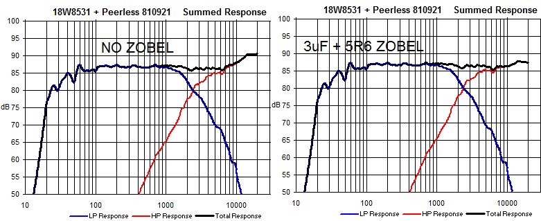

Peerless 810921 zobel
I've used a zobel to good effect on a Peerless 810921 tweeter in an AR Series crossover. The plot on the left has no zobel and the one on the right has a zobel. In effect it causes a drooping impedance (<4R from 10kHz - 20kHz) on the tweeter which stops the rising FR. Over the years I've found a lot of the Peerless tweeters have an rising FR when used in series and low order crossovers where other brands do not exhibit this trait.

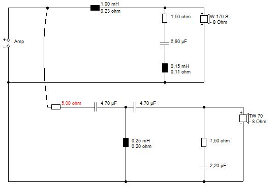

The simple answer is that a tweeter Zobel circuit can give a much better/higher impedance at the top end than an attenuator topology, which will make for a sweeter sound from most transistor amplifiers. Amps don't like supplying a lot of current quickly.
Typical Zobel values are 7.5R wirewound/1uF. This particular Visaton TW70 cone tweeter is 0.15mH Le so it's a bigger capacitor. But all things being equal, I'd go for the better impedance every time. 🙂
Impedance Equalization (L-Pad) Circuit Designer / Calculator
