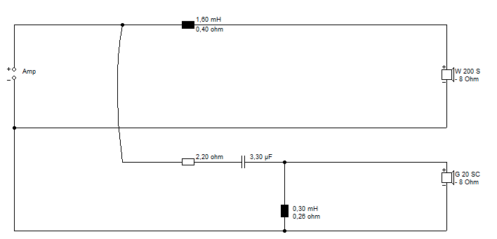

high all - i want to reduce the volume in the tweeter of a two way - i am aware of the one resistor in line and then the same value across the terminals to keep impedance matched - given the tweeter draws a small amount of juice - would it really matter if just one resistor was used in line?
As long as the resistor change is minor, I wouldn't lose sleep over it. Certainly nothing will break since you are increasing impedance.
Try it. Every ohm you add is 1dB reduction with a 6 ohm tweeter, so changing this 2.2 to 4.7R will do quite a lot to level. -3dB is half power.
This is an industry standard way of doing things. The resistor doubles as a fuse! A 3W ceramic should be fine in a low powered tweeter circuit. See how it sounds. This is diy.

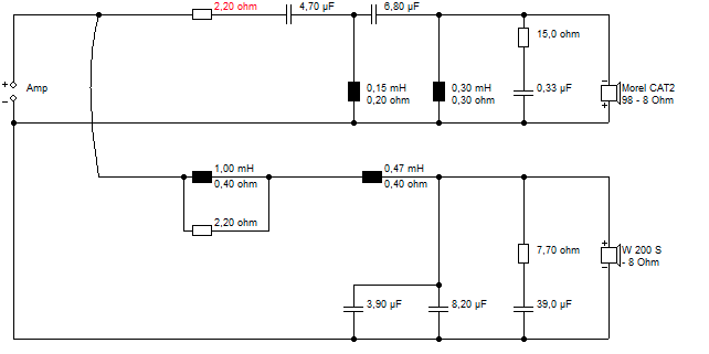

A lot of harsh tweeters can be tamed at the very top with a little circuit commonly called a Zobel. This usually consists of a 7.5R plus 0.68uF shunt on the tweeter.
I think it can do TOO much sometimes, and usually fit a 15R plus 0.33uF.
