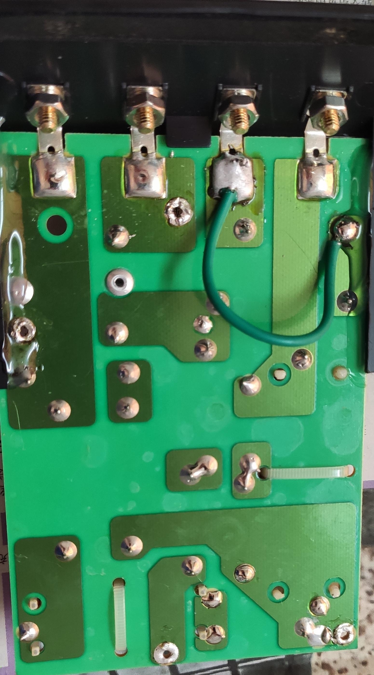

Hi Sangram, so now I'm playing around the external resistance value with the R1 shorting on, feel the tweeter gets louder but not the top sparkle as with the swapped crossover.To keep things simple, I would try removing the short, and use pink noise to tune the speaker by trying a few different combinations of R+C in parallel with R1.
Parallel resistor will bring up the total tweeter output, whereas parallel cap will bring up only the last octave. You should add resistors till you get the midrange to sound right, then add capacitors till you get the top octave right.
Next, can I try to connect capacitor parallel to the external resistor (which is R1 replacement) to bring up the last octave? If so what is the good starting capacitance value to try? Thanks.
Depends a bit on the resistor value. For a 4 ohm resistor you can start with about 2uF and work your way downwards. As the resistor becomes smaller, the cap will need to become a bit bigger. Try not to exceed about 3.3uF.
