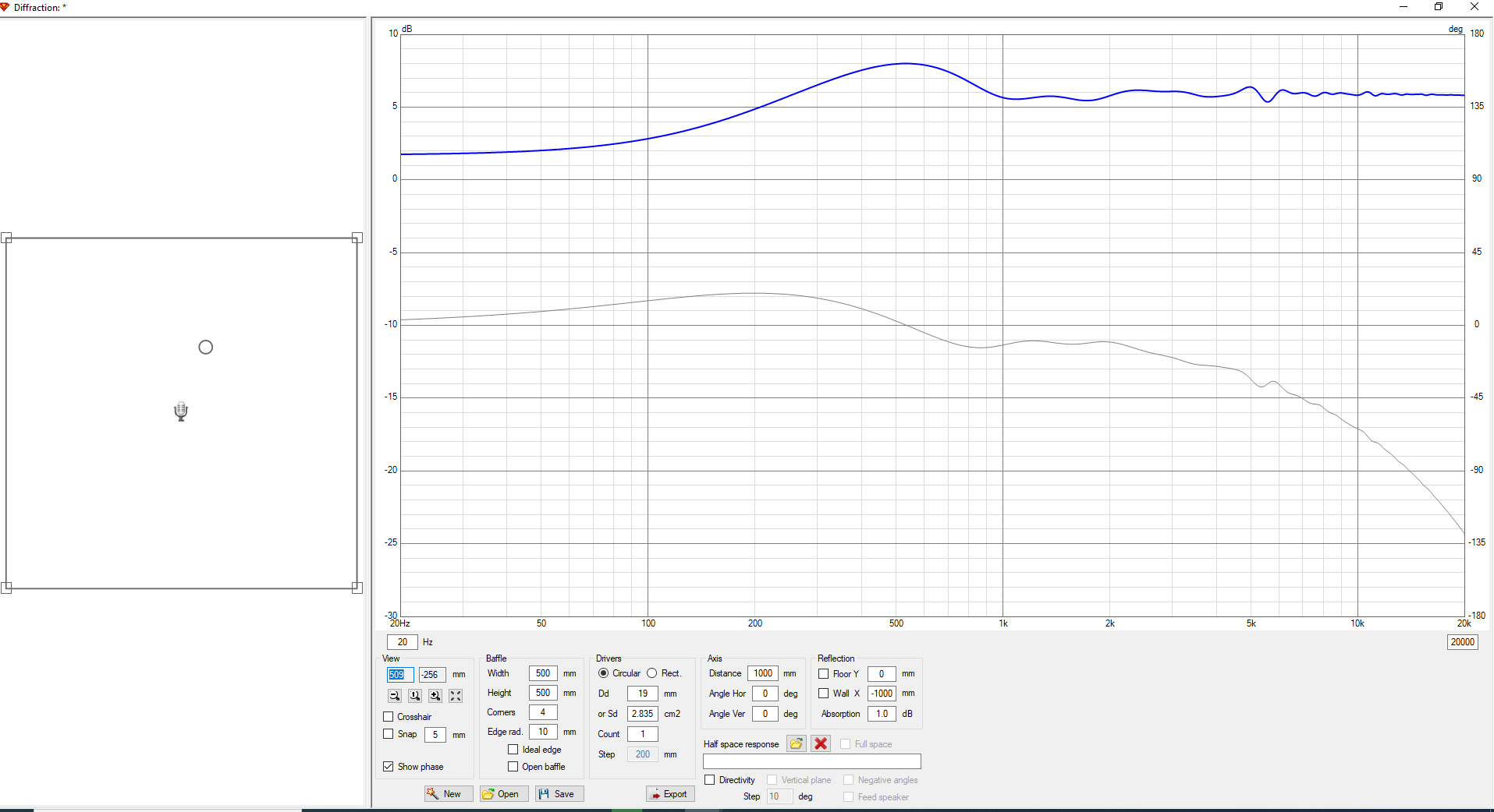

I have ordered a couple of ND20FB-4 tweeters in order to perform second teir calibration of MEMS mics using a known microphone for the range >2kHz. The idea is that I will put the tweeter on a flat baffle placed on the floor, position the micrphones in exactly the same point in space above the tweeter and perform gated measurments in order to calibrate them. I used Vitux-cad diffraction simulator to come up with this baffle design:
I think the ripple ~5kHz will not occour as the tweeter will not be omi at this frequency. Any comments? I haven't seen anyone calibrating microphones with this kind of source before so could be making some silly mistakes.

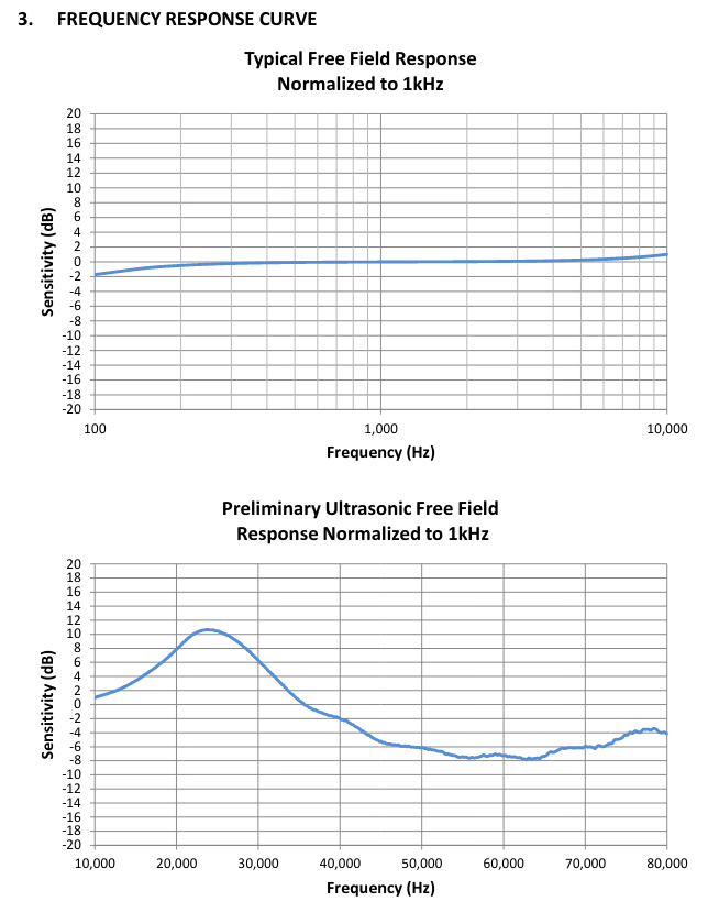

The mic I am currently look at is the SPU0410LR5H-QB:
For this mic the resonant peak is ultrasonic which should reduce error in the HF range.
