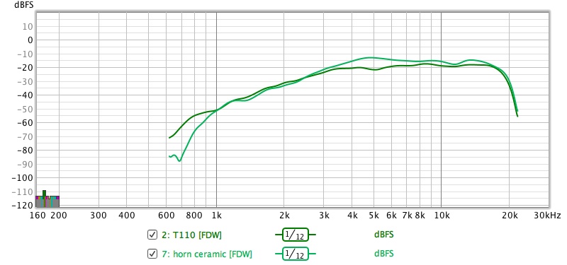

Checking a whole bunch of tweeters. Here is a comparison of (1) a ceramic tweeter with a fancy horn that bought for can$3, maybe 50 years ago and (2) a Fostex planar (may have been in a top-end Infinity) with model number E110, looks similar to some at Madisound for us$700.
FR and distortion. Green trace is ceramic, not that you can tell the difference in traces.
Impulse plots look similar too.... believe it or not. But ESL trace better.

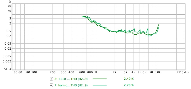

I was rushing through a big pile, so kind of rough lab work.
About 11 inches. Not too loud - guessing at 85 dB (but same voltage for all the tweeters)... which would make the distortion measurements pretty impressive with all the crap and abients sounds around.

While I can't say as the THD was as low as possible with air-conditioning going, it is quite low and it is substantially below other tweeters such a fancy fried egg dome* tested the same way.

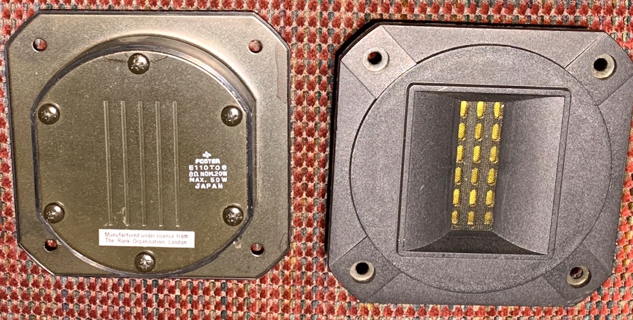

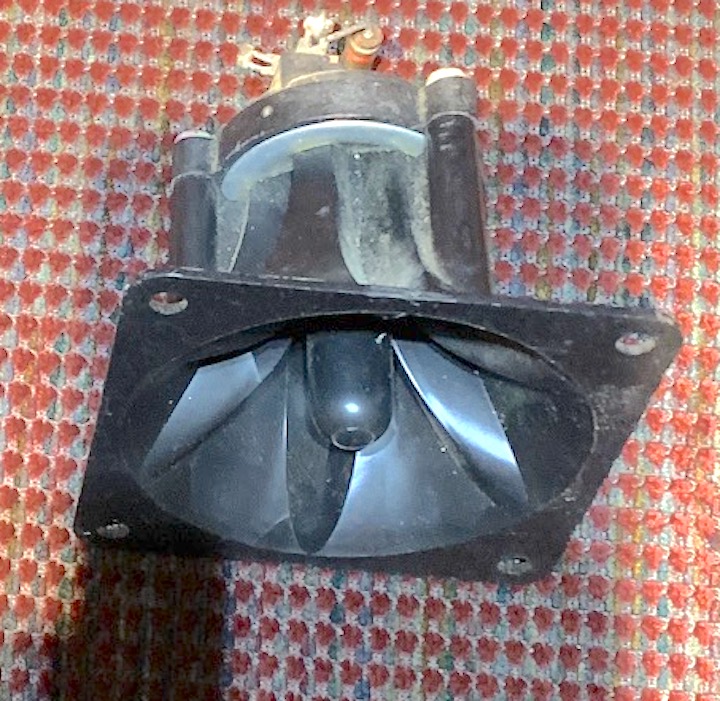

Here're pictures of the two tweeters. Please help me identify (and find info about) the Foster tweeter. Also see my other thread about the E120.
Thanks.
B.

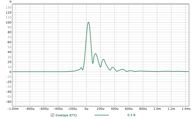

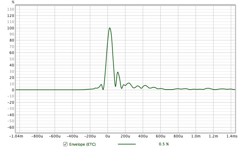

Here are the impulse plots for the T110 (to the right in the left photo on post #6) and the ceramic horn tweeter. Not much false action beyond half a milli-second for either. The $3, 50 year old tweeter is looking pretty good.

Looks like you are showing the ETC(Energy Time Curve), perhaps with a mS or so of smoothing?
The impulse response will have both positive and negative going peaks due to the tweeter's HP nature.
@bentoronto,
