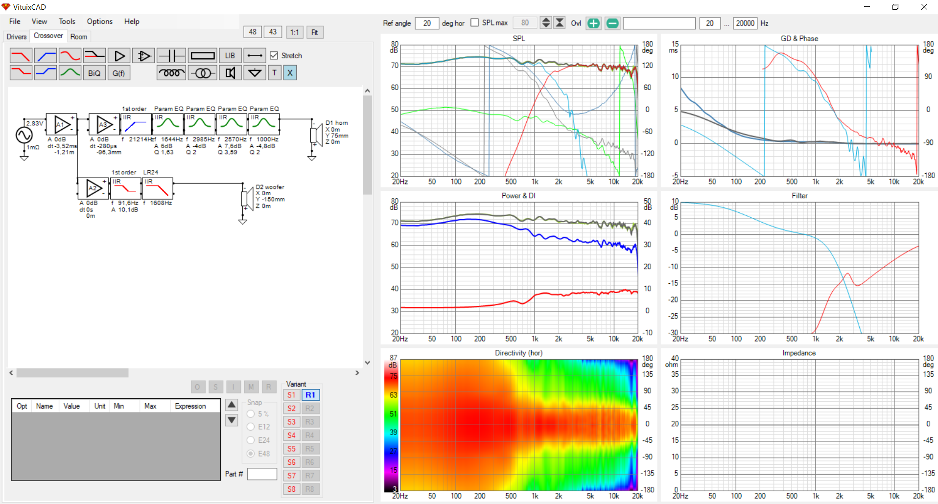

I don't know about the particular system, but as an example I recently tried to help fellow member with crossover simulation and the compression driver high pass called for ~21kHz 1st order 😀 This aligned the phase nicely around crossover. High pass lower down wasn't as good alignment. Wouldn't have guessed beforehand but I'm not expert in the field so no wonder. The example is a quick one with digital filters but could have used single capacitor as well (I think, no impedance data was available).
Point being it is very easy to see what the system calls for after the data is fed into the simulation program. Sim the miniDSP filters along with the series capacitor and the whole situation is clearly seen. Helps to get best possible outcome without guessing about it. Let your loudspeaker system tell what is required, not the DIY group 😉

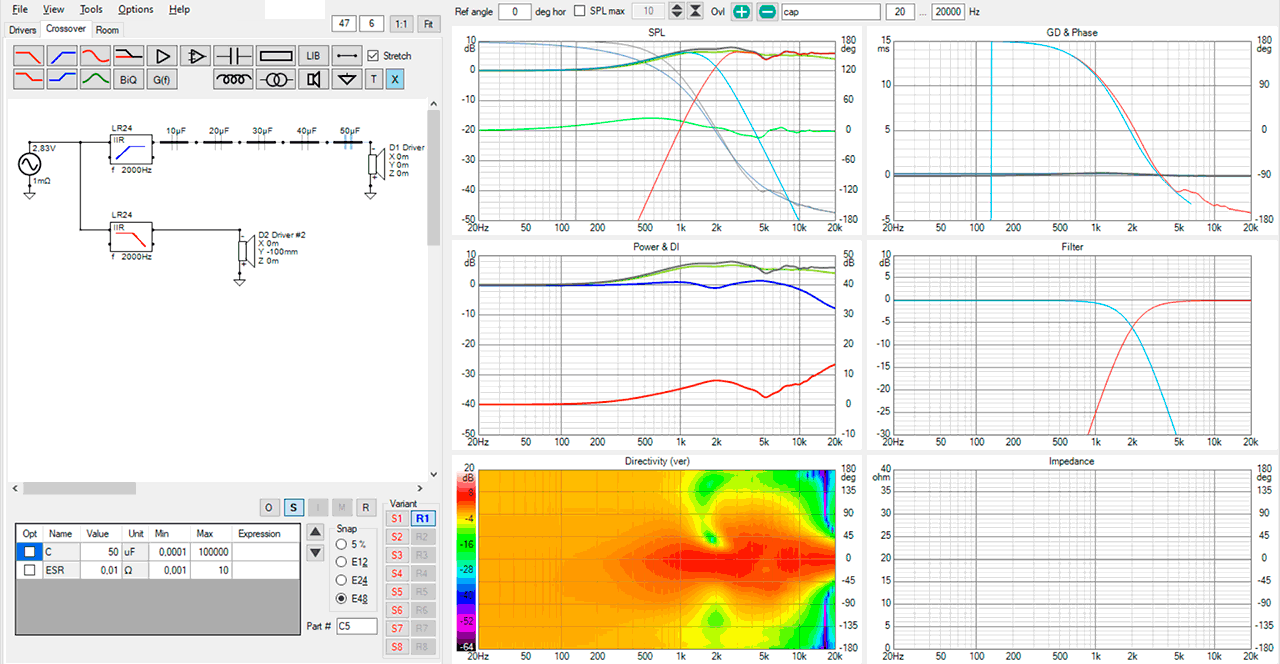

Animation with ideal drivers and simulated baffle. It is ~1" tweeter and ~4" woofer on a small baffle. 2kHz LR4 crossover on DSP and varying cap size on the tweeter. In this case a 50uF cap doesn't seem to have too much influence on the response anymore. If smaller cap is used, the high pass filter on the DSP needs adjustment.

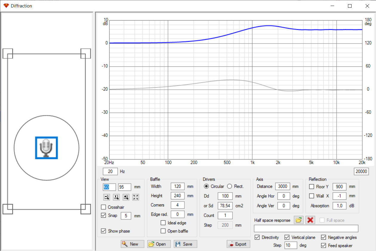

The ideal drivers in the attached simulation have flat frequency response 20-20kHz so no acoustic high pass on the driver itself. In real world there is acoustic high pass on the driver in addition to the DSP and the cap filters and they all combine to an acoustic slope. DSP is easy to adjust so one might use capacitor that is readily available. Otherwise it makes sense to use smallest cap possible to save some currency units.
ps. the frequency response ripple in the attachment is due to simulated baffle diffraction. Diffraction and other issues can be analyzed and addressed (or not) quite easily in the simulator as well. Kind of promoting VituixCAD since it is quite awesome tool. 😀
