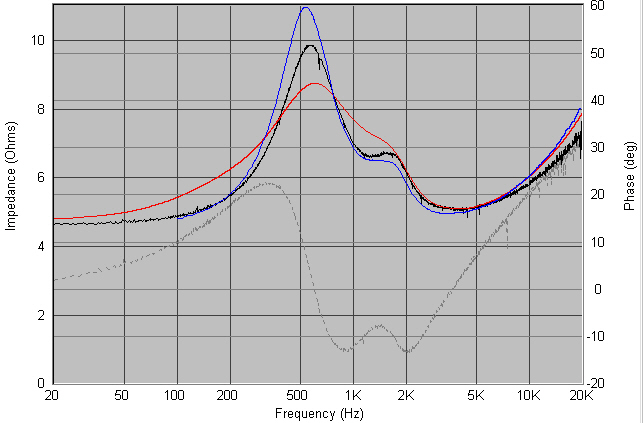

Thanks Dave for digging up / redoing that D19. That is re-assuring (without finding any other measurements / reference / specsheet)
I tested a new Seas 27TBFC/G tonight. Below is my measurement (black unsmoothed - driver not broken in) along with Zaph's measurement in red and Seas factory provided ZMA in blue. All look very close... which tells me not to worry about those old tweeters 😀
So I think everything is ok... Thanks to everyone for your advice and help. I think this one is solved!
....onto frequency measurements!
