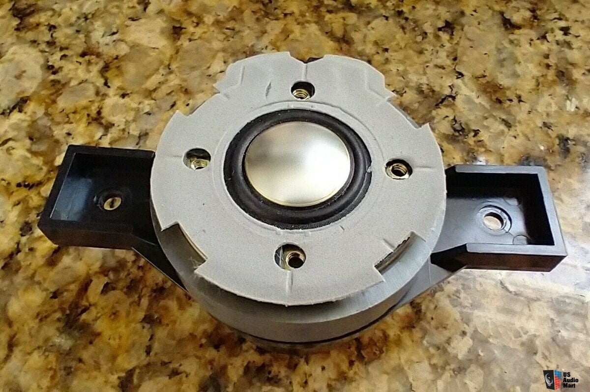

Looks like the driver is either rear mounted, or has some type of escutcheon plate covering it's mount.

The tiny piece of gasket touching the half roll surround, or the upper right gasket being too close could be causing the buzz.
Do a frequency sweep before and after removing that junk before any more dissection.

My joy was short-lived. The distortion is back. I spent the evening playing with the tweeter. There is voice coil rubbing. I tries to push it (from the periphery where it is plastic-ish just before the metal dome) in different directions while I was playing a tone. When the distortion was gone, as long as the tone continues, I get no distortion. But as soon as I stop it, the next time I play the tone, the distortion is back. Just like if it was going back to its "natural" position, except that now the natural position is rubbing.
When there is no signal, if I push down from one side (again as close to the dome as possible without touching it) it moves freely, but one the other side, there is some rubbing.
The dome is well glued to the assembly, so there is no easy way to lift it and clean, or reshape under the dome.
What I've done before is to figure out where the coil/former is rubbing, then carefully scrape up the outer attachment of the surround (on the flange, alcohol and warmth can help soften glue), such that you can pull or shim under it and reglue it (EVA glue is fine) so that it no longer rubs. You kind of need some mechanical awareness to figure out if you need to lift a low point or pull across part of the surround. It may not be a perfectly symmetrical surround after it all, but it beats rubbing.
Sometimes the magnet has also shifted which is not always fun to re align, especially when you also have ferrofluid in the gap.
