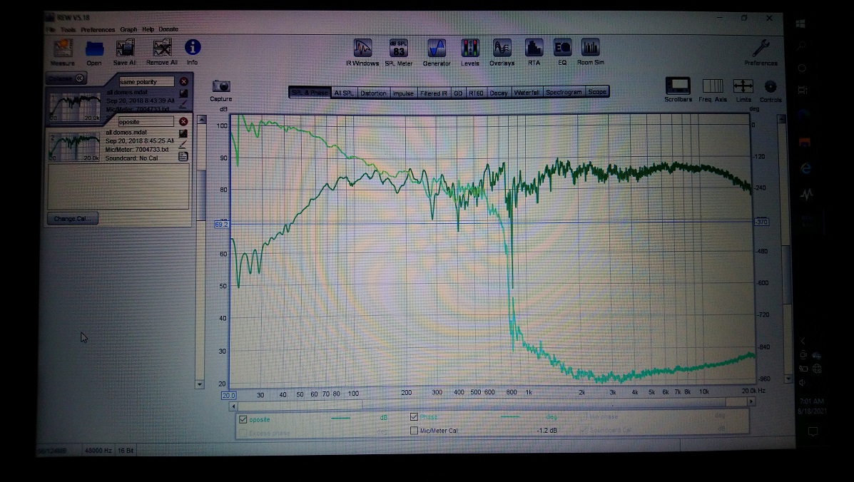

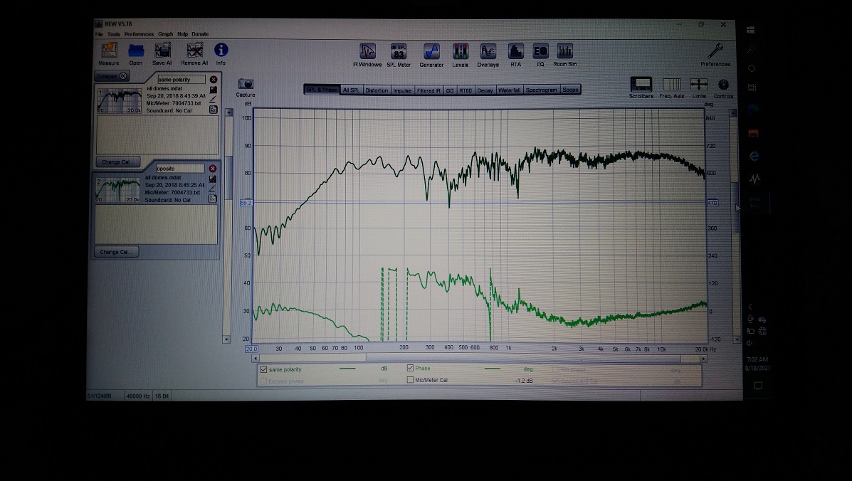

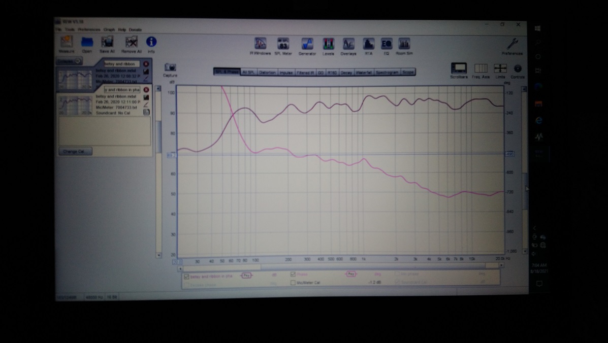

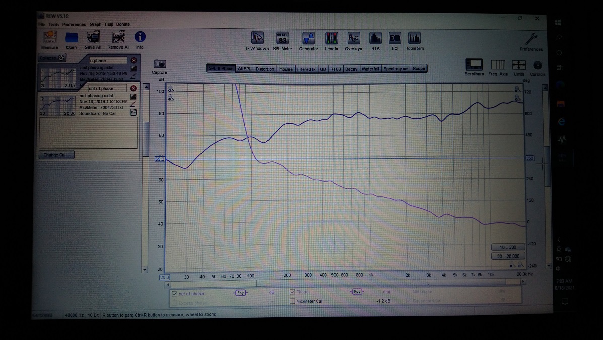

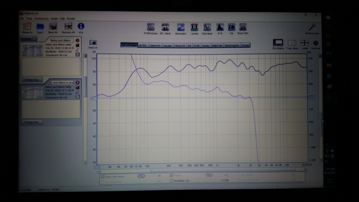

Tweeter polarity reversal or not
Thanks for the data.
I know it is very obvious to you what we are supposed to see, but could you just walk us through what we are supposed to be noticing.
If there is suck-out on some of your plots, does it correspond to the "right" or "wrong" polarity?
Thanks.
B.
