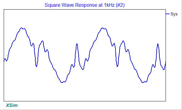

It is very interesting to design a good XO which can be right electrically speaking at test frequencies, like sweep tones and low harmonics, and low intermodulation for two tones.
However, how can you hope to even get this signal out of the inductors and capacitors splitters with a likeliness to the original: It is technically impossible: see attachment.
I just designed a crappy crossover that turns a square wave into this. Shame on me.
