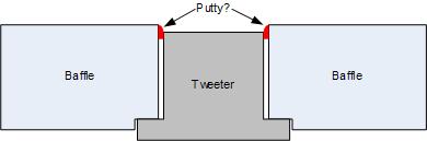

Hello all,
First time builder, I am working on the Zaph ZBM4 bargain mini's, my question is this;
I got some help building the enclosures, however I now notice that the tweeter, a rear-mount Aura NT1 titanium dome, does not quite mount flush with the front of the baffle; it sits about .5mm below the surface. Is this something to be worried about from a sound quality perspective?
I am picturing sound waves emanating from the dome and hitting that "ridge," and thus not "flowing" across the surface of the baffle properly, but I wanted a 2nd opinion before I start chipping away at the back of my baffle (with my inexperienced fingers).
P.S.; As Zaph suggests, getting the proper diameter hole drilled for these unusual tweeters was the most difficult part of this project. My uncle who is a skilled craftsman with ~35 yrs experience really wrestled with it, and we still ended up with holes that are a tad too big - about .25mm gap all around. Of course if we had just ordered the proper drill bit as he initially suggested I'm sure that would have improved the outcome! However I insisted it "doesn't have to be perfect," and am now regretting that decision slightly.
Thanks for any help or suggestions,
Sam T

I don't know that a half millimeter would make any audible difference, but one posssible remedy would be to sand the edges of the cutout so they are rounded over, to get rid of the sharp edge and make a sort of continuation of the tweeter housing.
Almost certainly, as there will be a discontinuity over the surface which the sound-waves will travel, there will be some diffraction effects here with what you have ended up with.
Whether this will be serious enough to affect the sonic performance for this to be noticeable to you or not, is another matter, though.
Another possibility which you might try in order to eliminate this slight 'step' would be if you could shamfer this edge and blend it into the surrounding baffle area.

The error in question here is 0.5mm or .02 inch, that's very small.
Looking at the spec sheet, from the face of the flange to the front of the tweeter is 12mm or .47 inches, and I assume you have it back mounted in .75 inch wood. That means you must have cut some kind of recess in the back of the front panel to move the tweeter forward to
the very edge of the out face of the front panel. Correct?
Exactly how did you accomplish this? Cut a large recess to accommodate the flange then a smaller hole to accommodate the tweeter itself. Or is the recess in the rear square?
You only need .02 inches, I would think it wouldn't take that much to scrap that out of the rear recess.
Other wise, simply beveling or rounding the edges of the outer opening shouldn't be that hard. At worst, you a just extending the horn of the tweeter.
Since this is such a fine amount, I don't see why it couldn't be done by hand with some sandpaper.

I tend to agree with BlueWizard's suggestion here, and unless the baffle is extremely hard wood, I think that any mechanical sanding will tend to run away with you if you are not very careful.
I would do this with some fine abrasive paper wrapped around a piece of wood of a suitable size and shape. You will have far more control over doing it this way, and I reckon that just a few 'wipes' in a circular manner around the edge of the aperture will be all that you will need here.
Why not practice a bit on some scrap wood of a similar type (I assume you will probably have some off-cuts) and you will soon see how much effort is needed for this, and a technique can be developed. Once you have 'gone too far' with the baffles, themselves, there will be no going back (or at least not easily), so do take it slowly so that you don't risk spoiling your work.
Another thought which I might try if it was me doing this, would be to temporarily stick some abrasive paper on the back of a suitably-sized shallow dish-shaped article (maybe a saucer, or pan-lid or something similar) which overlaps the hole edge by a sensible amount. Placing this over the hole, and carefully rotating it concentrically a few times should give a nice 'professionally-finished' shallow bevel which will be even all around, if you are careful with this, and the depth of cut will be easier to control.
You won't need to cover the entire circumference of the saucer-shaped 'former', and just a strip of sandpaper will do for this, but the remainder of the 'former' will help to centralise everything and support things so you almost certainly couldn't get this chamfer wrong.

If this was a front-mounted tweeter, something like this would work very well.
However, this tweeter is rear-mounted, so any 'packing out', will worsen the problem, unfortunately.

Samtny, what is your baffle made of? If it's MDF or plywood, it may be possible to carefully work it down where the flange sits, so that the tweeter protrudes a bit more to be flush at the front.
If I understand it correctly, though, you have two concerns: one is the mounting depth, the other is the gap between the tweeter and the baffle. You may be able to solve both problems by building up the gap with some sort of putty (non-stick, ideally) like the red in the drawing?
If it were mine, though, I'd listen for a while and see what it sounds like before worrying about it.

[edit: Bobken posted while I was drawing
Does the friend who did your woodworking have a router? If so, he should be able to use that to put a slight bevel on the edge of the hole.
That's probably more tool than you need, but it would make a perfect bevel; absolutely uniform.
I think I would be incline to just wrap some 300 grit black sandpaper over my thumb and work the edge by hand.
If there is a gap that concerns you, as illustrated in Aengus's drawing, I wouldn't worry about it. The gap should be reasonably sealed at the back. So, it's presence in the front should have no effect.

I wouldn't worry about it. 0.5mm is too small to be concerned. It will possibly affect frequencies (344 / 0.0005 / 8 = ) 86kHz which is well above human hearing range.
HiFiNutNut said:I wouldn't worry about it. 0.5mm is too small to be concerned. It will possibly affect frequencies (344 / 0.0005 / 8 = ) 86kHz which is well above human hearing range.
HiFiNutNut: If your calculation is correct, then you're right I'd rather not fuss with it and make a mess of the front of my baffle.
Could you tell me the source of your formula? I recognize 344 = speed of sound, .0005 = the step I'm concerned about, but what's the 8?
To all others; thanks for your suggestions! If anything, I may try sanding the backside of the baffle to get the tweeter to sit a little deeper, however if the frequency problems are in the 86kHz range I won't even bother with that.

Just a quickie update;
I ended up doing 2 things; sanded the *inner* face of the baffle to let the tweeter sit a little deeper, and also put a tiny chamfer on the front edge of the baffle, to make the tweeter housing *almost* flush. My biggest nitpick right now is the slightly ugly gap around the tweeter at about .25mm, but at least the housing is now essentially "flush mounted" to the best of my abilities.
