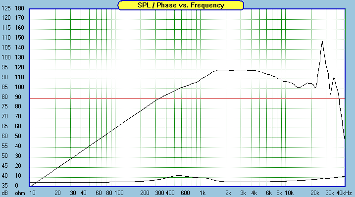

Will a response like this it still tricky and can't be a straight substitution :
Seas DXT
