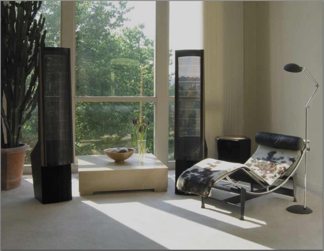

I could say why are you willfully invoking the voodoo of magnetic woofers, found in most Martin Logan models? If you're going to spring for M-L ESLs-which are almost always $$$$$-why not instead buy (SoundLab?) or DIY some large enough to avoid the need to even use subs?
I'm taking advantage of our hearing being MUCH less discriminating in the bass, so a magnetic woofer is passable, esp once one goes active xo there to allow its amp to keep control of it. This divide & conquer approach also permits me to use a small class A amp on the ESL, while any old (but big) amp will suffice for the bass.
The ESL hybrid ML Ascenti f.ex. has the basics right and is a bargain at under $1500 used, while still being a narrow 13 inches wide, so they don't look like a pair of tombstones.
yeah thats another option. but that is hardly a challenge to use such big panels for only 300hz and up. although the high end still has shitty dispersion. since bedning the panel does not mean it has dispersion with the same angle the panel has. what you do get is more distortion. since the mylar is is never nicely in between the stators.
Certainly the ML doesn't have one of the most aspects right, which is why their basses never integrate seamless and which is the single most named reason of fans of fullrangers that they still think that FRs are superior.
