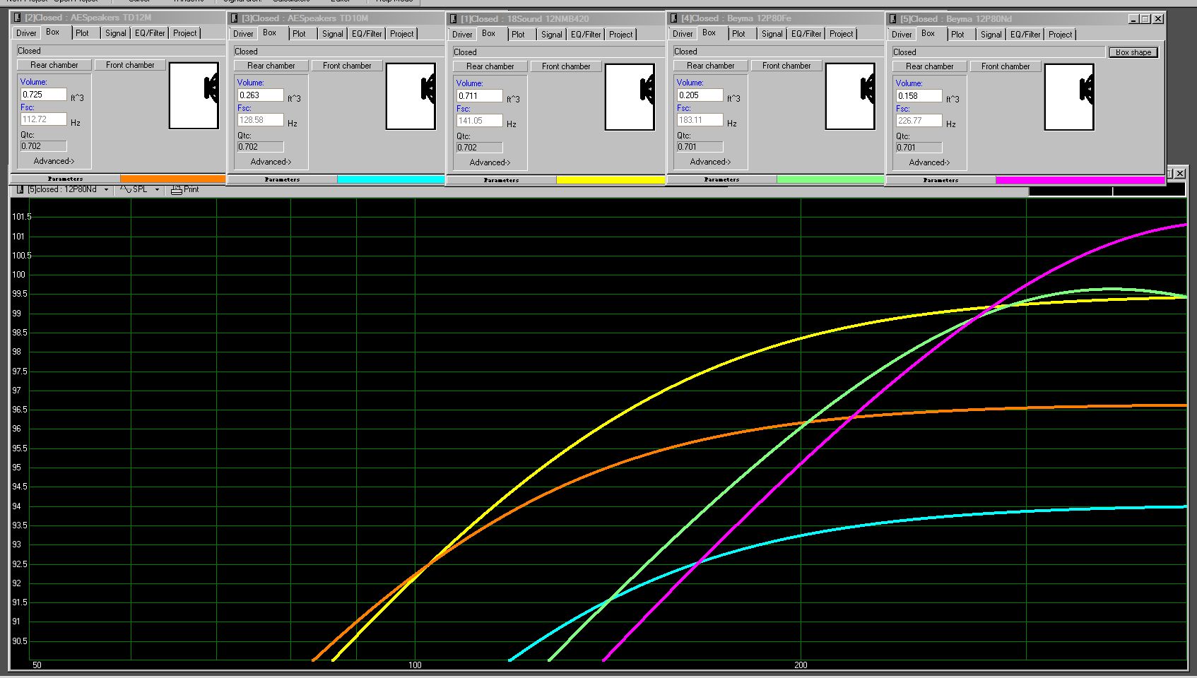

WinISD for common Midbass considered for TPL150H
F3 frequency and sealed box volume:
Orange TD12M 113Hz 0.725cuft
Blue TD10M 129Hz 0.263cuft
Yellow 12NMB420 141Hz 0.711cuft
Green 12P80FE 183Hz 0.205cuft
Purple 12P80Nd 226Hz 0.158cuft
WinISD absolute SPL/w can be optimistic, but relative efficiency is useful.

Thank you for taking the time to do that!
I'm more familiar with UniBox, so I ran the same, except for the 12NMB420 since I don't have it modelled. I used a sealed box, with minimal fill, minimal leaks, 80W power for all the drivers, and used the box volumes you listed. Interestingly F3 varies from right at the same value to about 10Hz off, but Qtc shows as 0.66.
If I'm reading your graphs correctly, the Beymas and TD10M will have a harder time reaching 80Hz.
From UniBox modelling I see:
TD10M reaching 105dB @ 80Hz and 113db above 200Hz, at 80W.
12P80Fe: 103dB @80Hz, 117dB above 250Hz, at 80W.
12P80Nd: 100dB @ 80Hz, 118dB above 300Hz.
TD12M: 109dB at 80Hz, 115dB above 200Hz.
Now the 12P80Nd doesn't look as good since it will deliver at least 3dB less at the xo point at a given power.
The TDs look best from this point of view, achieving high SPLs at 80Hz.
The 12P80Fe deserves some discussion, I think. SPL at 80Hz is not bad, and max SPL is good. Since I will be using digital room correction and linearizing the drivers through software it seems this could be a viable option.
It might not have as much definition as the Nd given the same Bl, almost the same motor strength and 10g difference in Mms, but has more than double the more motor strength of the TD12M and the same Mms/Bl ratio.
How convenient would it be to be able to listen to a TD12M and 12P80Fe side by side! 🙂

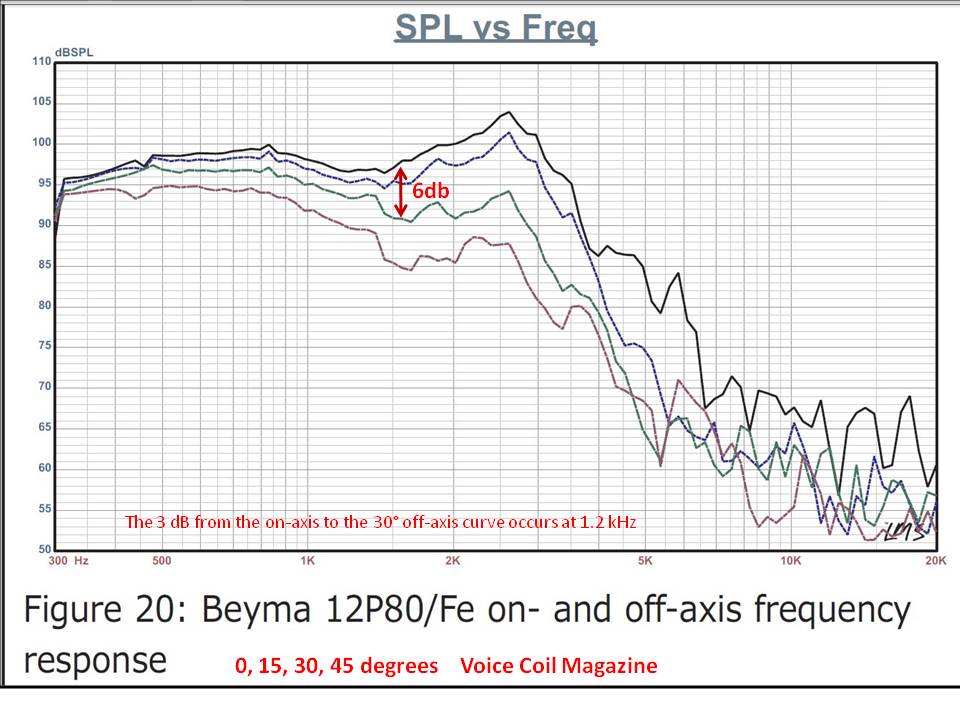

Beyma 12P80Fe Polar Plot
There has been discussion on building a custom horn for the TPL-150 to match the 12P80Nd polar at 1600Hz. ?? Why pay $$ for the TPL-150 is you can't use it's dynamics.
Lambda TD12M polar in earlier post looks like a closer match to Beyma 80H x 30V Horn. You can email Acoustic Elegance to check delivery times for you decision matrix.

In my calculations the 12P80Nd has an F3 of 258Hz in a sealed box with Qtc=0.707. Too high an F3, in my view, for a woofer. Then the 12P80Nd performs great as a midrange, but has the directivity issues all large drivers display as frequency goes up. So I decided not to use it in my design.
I won't have one. Don't need it. Mine will be an active 4-way, so sensitivity mismatches are not as critical as with passive xo.
It is also easier to match dispersion with larger drivers, like 6.5" at 2200Hz. Without the waveguide you would need a small midrange to match dispersion.

But in the simulation we made and that Linsources showed in a sealed cabinet with rol off around 220 hz (not far from the bafle step with a 40/45 cm width bafle, I just don't understand how (without EQ), Angeloitacare can go to 50 Hz ?! I should re read the thread, after all maybe he EQ with a soft from a pc !

Even the, the directivity issue above 1600Hz or so prevails, and gets worse as frequency increases.
