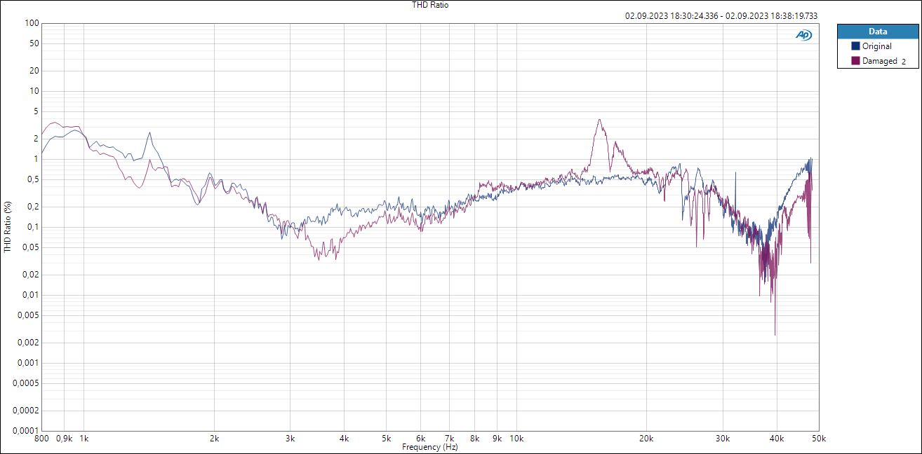

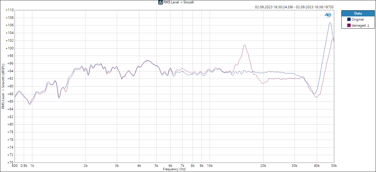

I wouldn’t call that nothing happening, that tweeters done IMOSorry people - I was way more busy as I thought. Was not my intention to let you wait so long!
Frequency response:
There is nothing happening up to 13kHz! I know that these dents are not as bad as you maybe think but this comes as surprise for me too.
On the other side - a 6dB resonance at 13kHz ... could be pretty annoying.
THD:
Also surprising! I don't think THD got better through the dent in the 3-5kHz range, that's probably normal differences. VERY little influence (and no - you would not hear harmonics >10kHz ... it's a technical thing)
Just look at my first measurement. Bliesmas Beryllium membrane works as piston far over 30kHz, membrane resonance at about 50kHz! (The dip at 38kHz is from the protection grill. Without it goes linear till the resonance). My experience with this tweeter is a detailed reproduction mut without metal "shimmer/pronaunciation" at higher frequencies.Personally, I do not see any relevant advantage in the use of beryllium and will therefore leave my fingers from it.
Normal metal tweeters have their resonance in the 20-30kHz are. We are not able to hear the resonance but (especially the old Seas tweeters with the resonance around 20kHz) I never liked the sound of them - the less the closer the resonance is to the hearable spectrum.
So Beryllium has definitely an advantage I can not get with other materials for my use - so I have to take it.
(I have to build a reference speaker for measurements with extended frequency range to 60kHz/94dBSpl and up to 100kHz at lower level. This is not possible with most tweeters. The measurements of the "diamond" membran I found >20kHz don't show a good result for this use, so I never tested them)
