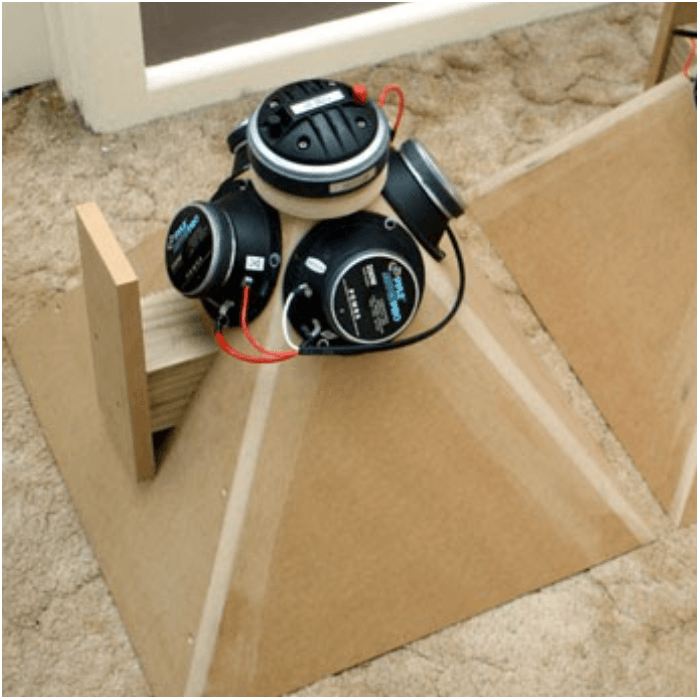

A virtual single point source with the horn wall angles determining the basic pattern, down to the lower range of pattern control determined by the mouth dimensions.I would like to try Danley Synergy Horn type construction so the compression driver would come closer to mids.
But as three sides instead of four.
What could be expected from that?
