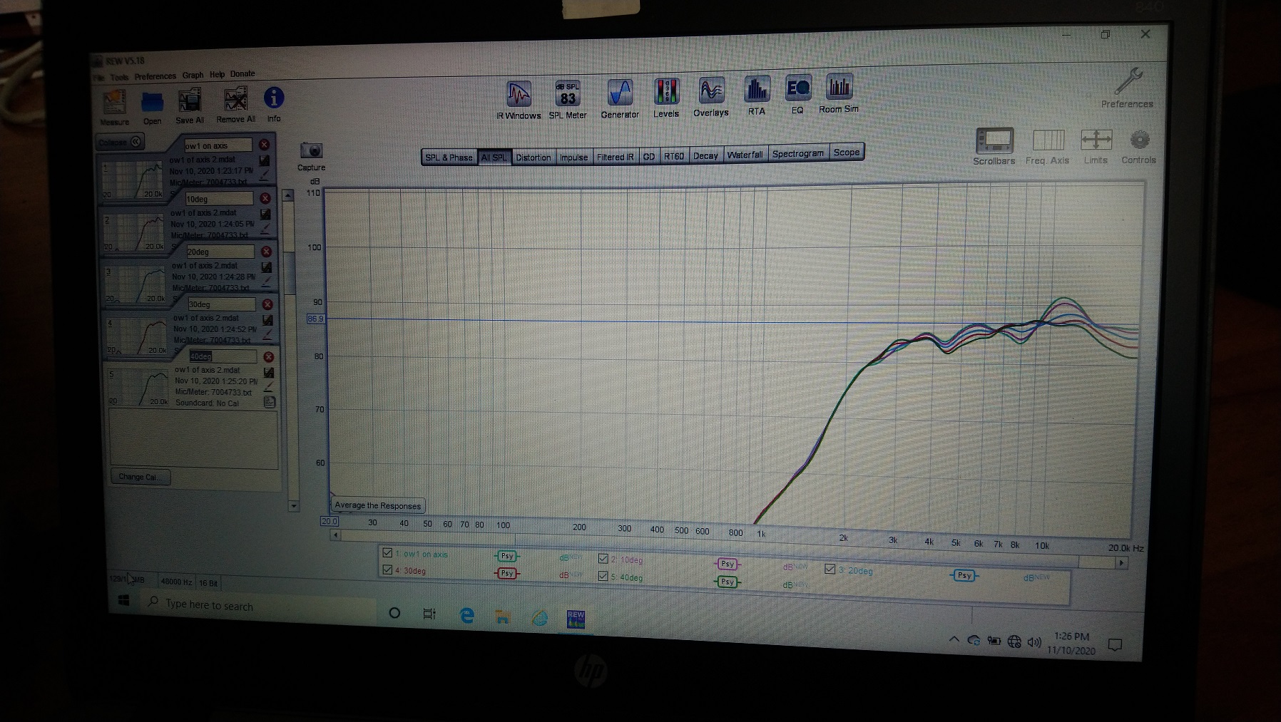

Yes agree. Having used the OW1 OW4 in several designs. These tweeters are by far some of the smoothest tweeters to listen to and easy to design with. 😎

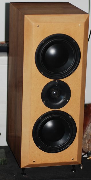

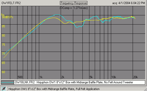

I think you nailed the reason. The incredible off axis response can be a detriment is there are projections to create diffraction. You don't see it with the Morel due to the waveguide. I recommend a thick felt ring around the OW1, preferably with a star shaped opening. Even a washcloth just for testing purposes.
I will experiment and report back

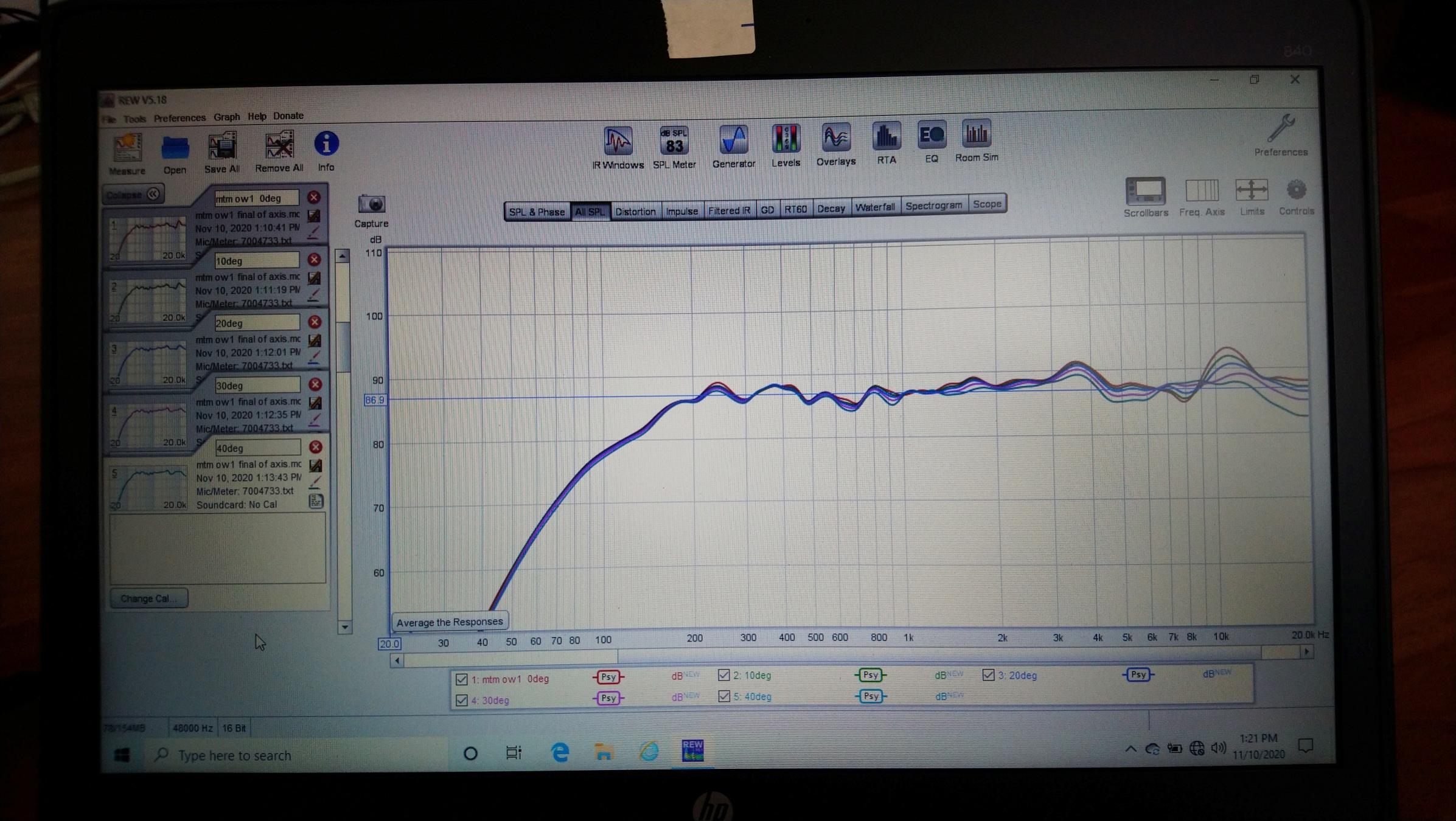

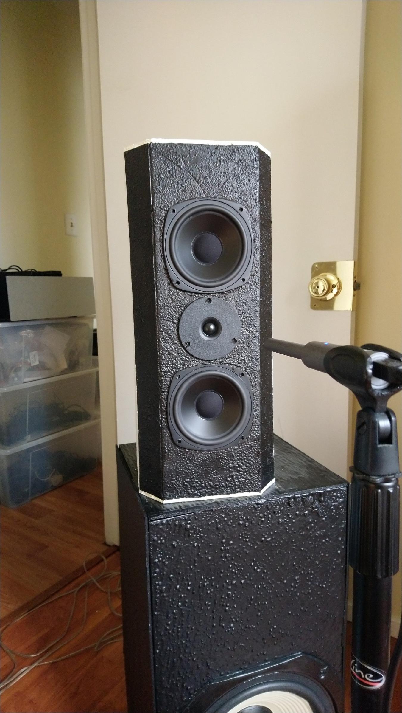

this is what others did
sure, extremely wide projection creates this, on the other hand its matching midrange projection into the room
I like what I hear so far, do not take me wrong

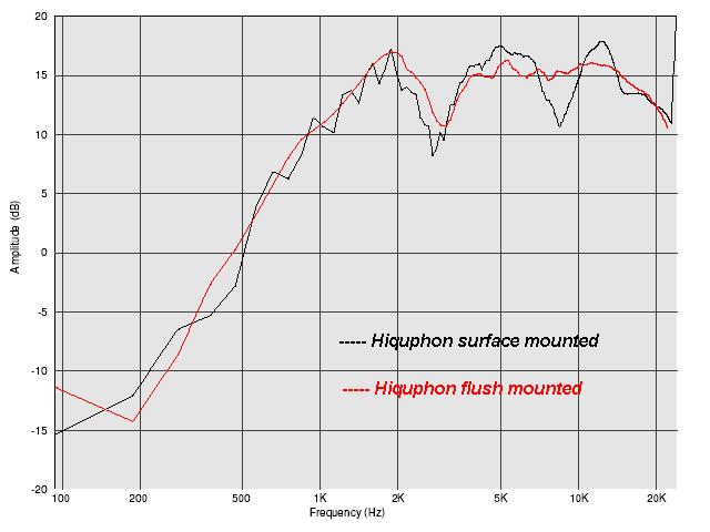

Oh I just realized the tweeters are surface mounted as well. I thought you had flush mounted the tweeter and surface mounted the mids (that's my setup). In my case it is because with the semi horn loaded tweeter that is very close to time aligned. I always planned to add felt like shown above but never got around to it.
Even seemingly small lips will create diffraction effects I'd definitely flush mount the tweeters, and measure again. Even just make up a baffle with just the tweeter cutout on it use the same chamfering (but no mid cutouts) and first measure surface mounted, then flush mounted. It will also give you an idea what effect the mids are having on tweeter diffraction.
