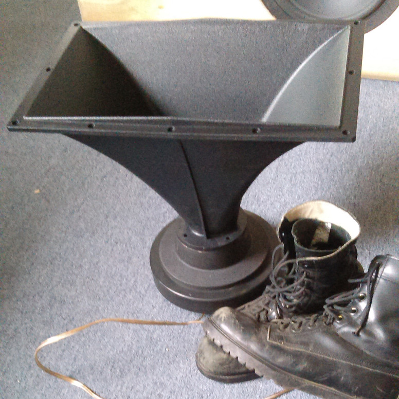

1) Stock horns. These were 30*45 mouth, 30cm long. They had horizontal pattern control to ~900Hz, according to my dodgy polar plots (theory says ~600). They should maintain pattern control a bit lower now, since I've expanded the mouth.

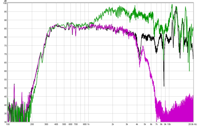

2) FR plots.
Black: cone driver, 300Hz high pass, HF boost to make it "full range". In break up after 7kHz.
Green: standard JBL 2445J, same settings as the black plot. Interestingly it is only more sensitive >1kHz. In break up after 7kHz.
This is with the driver on the floor, the horn just plonked on top, mic at horn mouth.
Purple: cone driver, with crossover points set to 300Hz and 4.5kHz. Nice.
To get rid of the 4.5kHz notch would require heavy equalisation or a rebuild with a phase plug ...so I think I'll just accept that as the crossover point.

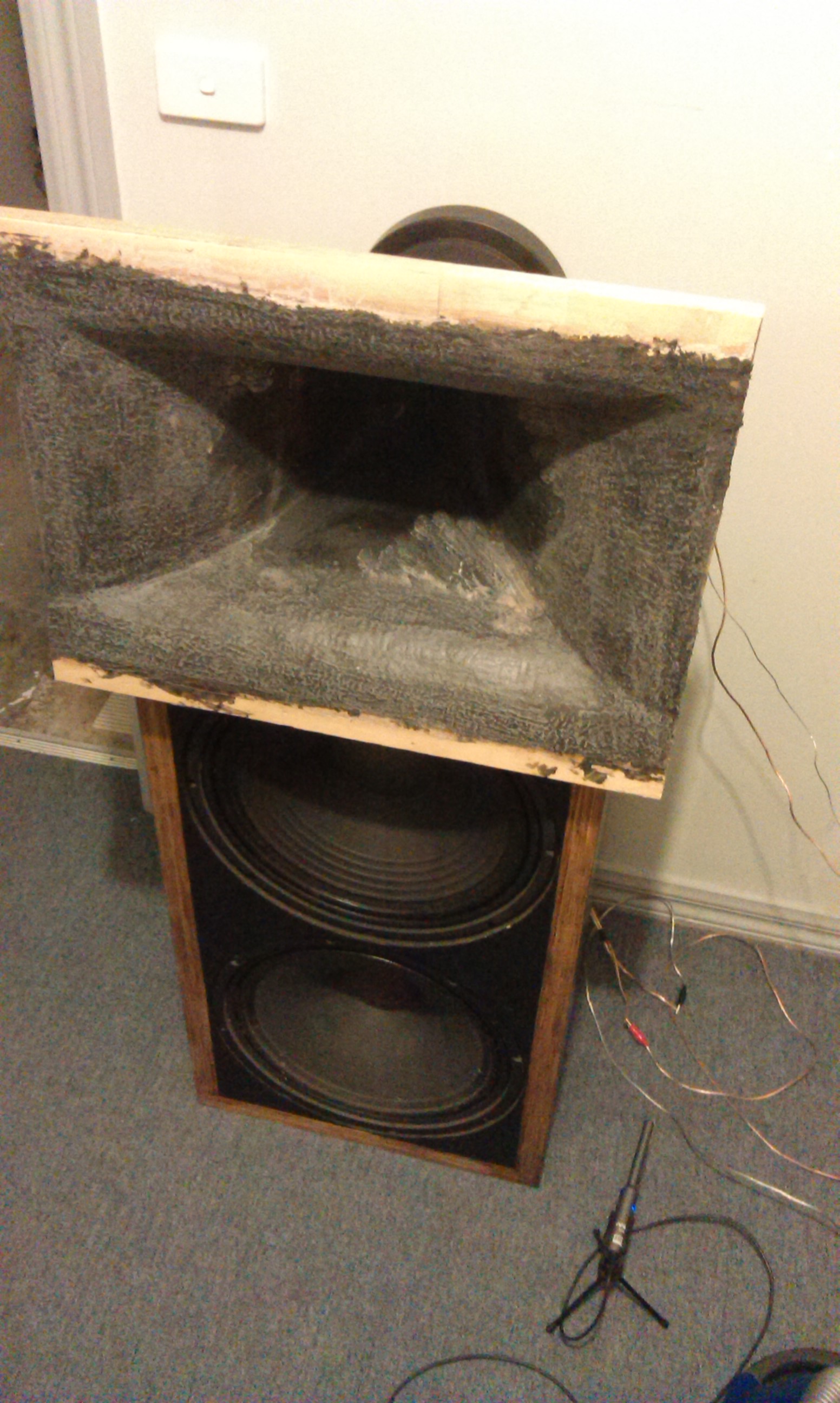

3) A modded horn, on a dual 15" box. The mods were achieved with scrap wood and filler. It needs lots of TLC + sanding to get it looking perfect ...or just a coat of matt black paint and a grill. I'm thinking I might use a grill of perforated steel, so it can double as a mount for the HF driver.

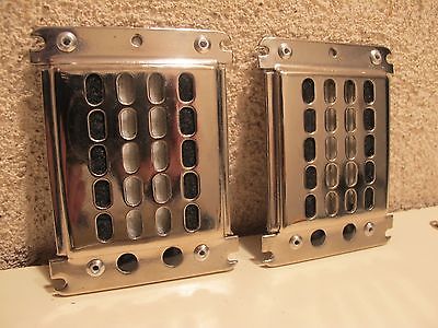

It occurred to me some dipoles, such as the Bohlender Graebener drivers, are exactly this - a grill of perforated steel.
  • pair-of-chrome-neo3-pdr-planar-tweeters-bohlender-graebener-two-2-neo3s-c3698c989221c7f4d987a34e.jpg
Updates / experimental results:
The ~4kHz notch on the cone + mid horn was an easy (acoustic) fix.
I tested a heavy grill of perforated steel. Firing the mid horn through it has marginal effect on the response.
- Therefore mounting an AMTPRO-4, in the horn's mouth, should be fine. With the face plate removed, this driver is an open frame, so the mids should fire through it as if it wasn't there.
