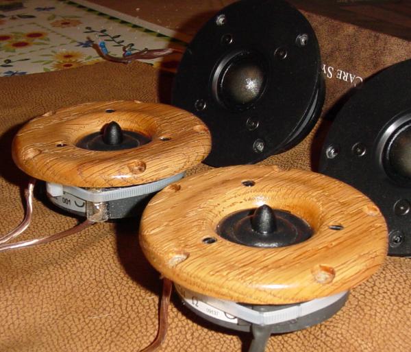

Probably not whatyour looking for but I removed the face of a Dayton silkie and "frenched" it into the baffle. Glue the faceplate in, fill with bondo, sand, fill sand, paint (or veneer). Worked like a charm for me.
This assumes that the faceplate is flat on the surface though.....
BTW, the speaks were built for my daughter😀 . she loves 'em.
