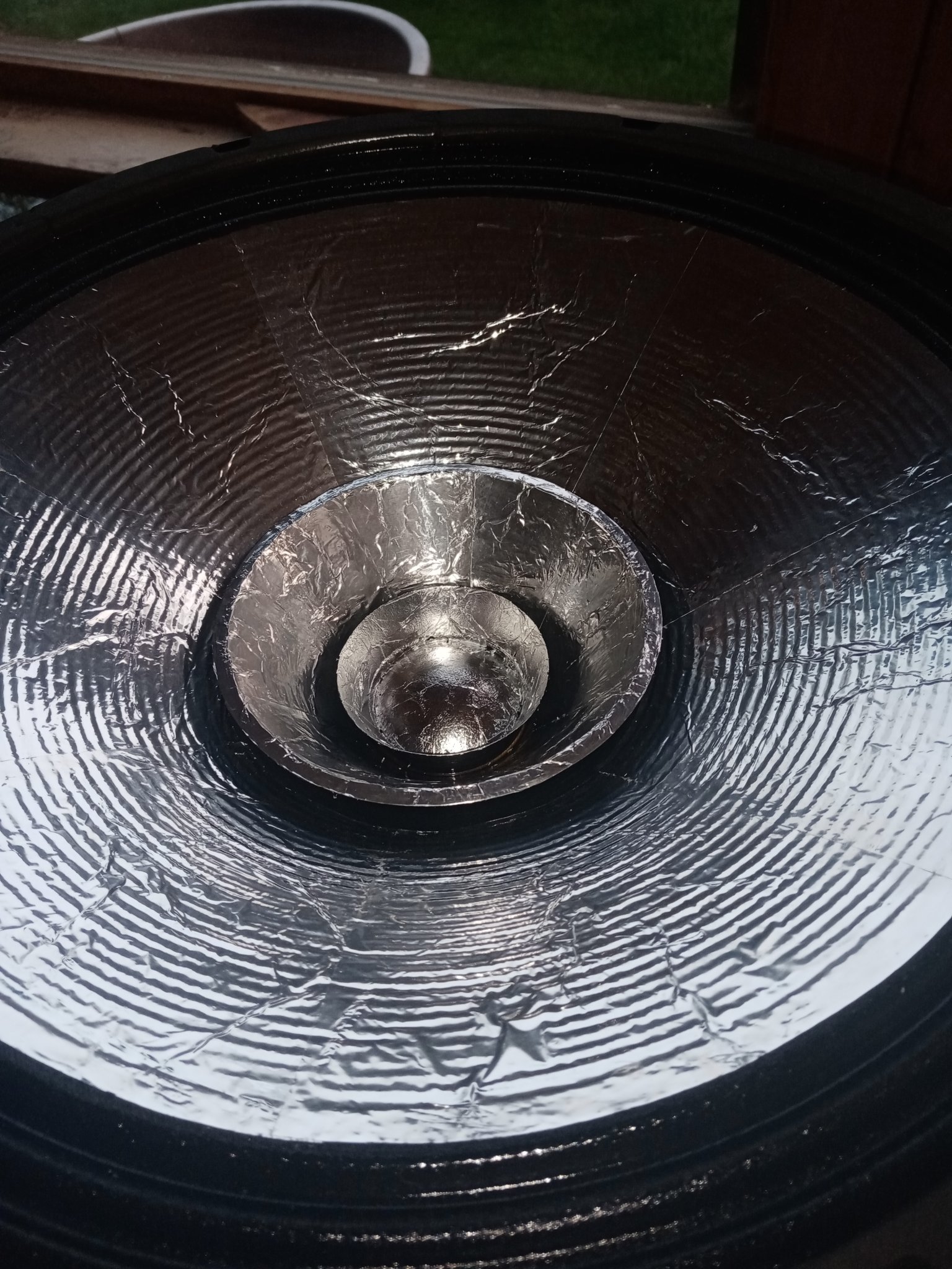

Best tweak in my eyes is putting aluminum foil on the paper cone:
https://www.diyaudio.com/community/threads/how-to-make-a-loudspeaker-sandwich-cone.402917/
Here a Fane Sovereign 15 300ts

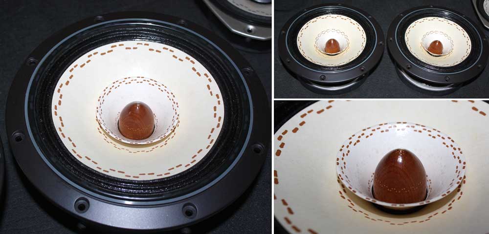

I have done 2 sets of FE206esR, both early before EnABL 2 (the rings would move today).
Phase plugs are probvably the most important. And then the standard Fostex FE/FF mods. https://www.diyaudio.com/community/threads/opinions-on-mods-to-ff85wk.365756/post-6480912
Dallas II, Kirisihima (essentially Sachicko V2), Vulcan,
dave
I used the FE206ES-R drivers in a pair of Sachiko cabinets with Dave's phase plugs for many years, I loved their sound so much that I've tracked down two more pairs of drivers and have them stashed away. I'm currently installing them in a pair of Oris 150 horns which should be incredible. These drivers are truly special, be careful and don't overdo it and ruin them by over-modding them. If the Oris horn experiment doesn't work I think my final stop in my full range driver journey will be my FE208-Sol drivers in a pair of Vulcan enclosures.
